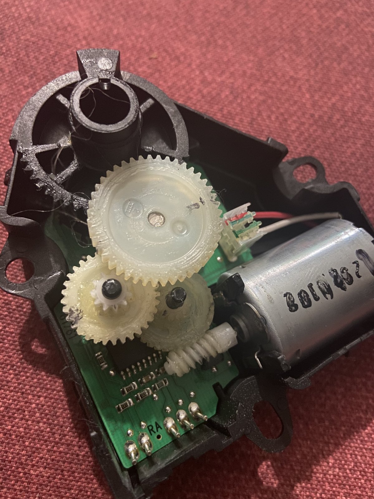

Finally replaced the driver side blend door actuator that I’d had sitting for 4 months. 3 years ago it turned hot once, I took it apart and cleaned etc. worked fine until a couple months ago, it did it once. This week it happened 4 times, so in the new one went. Old one still clean this time, the contacts weren’t green and gooey this time under the black gear

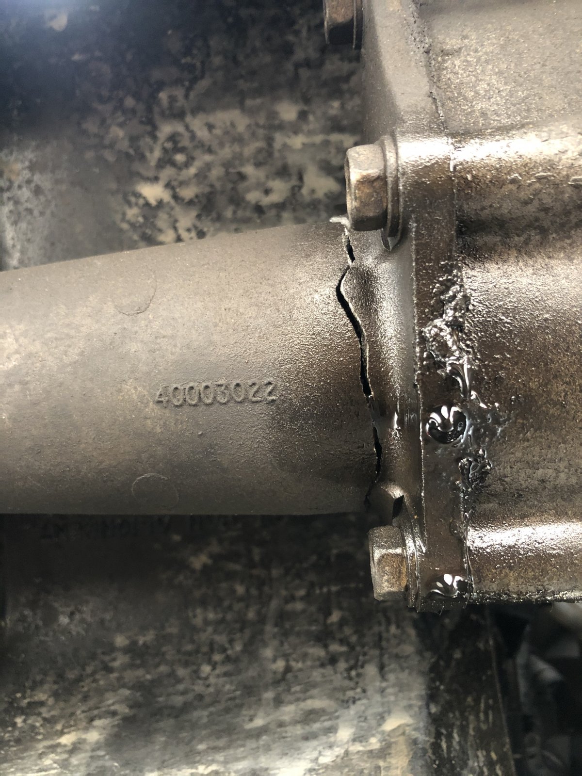

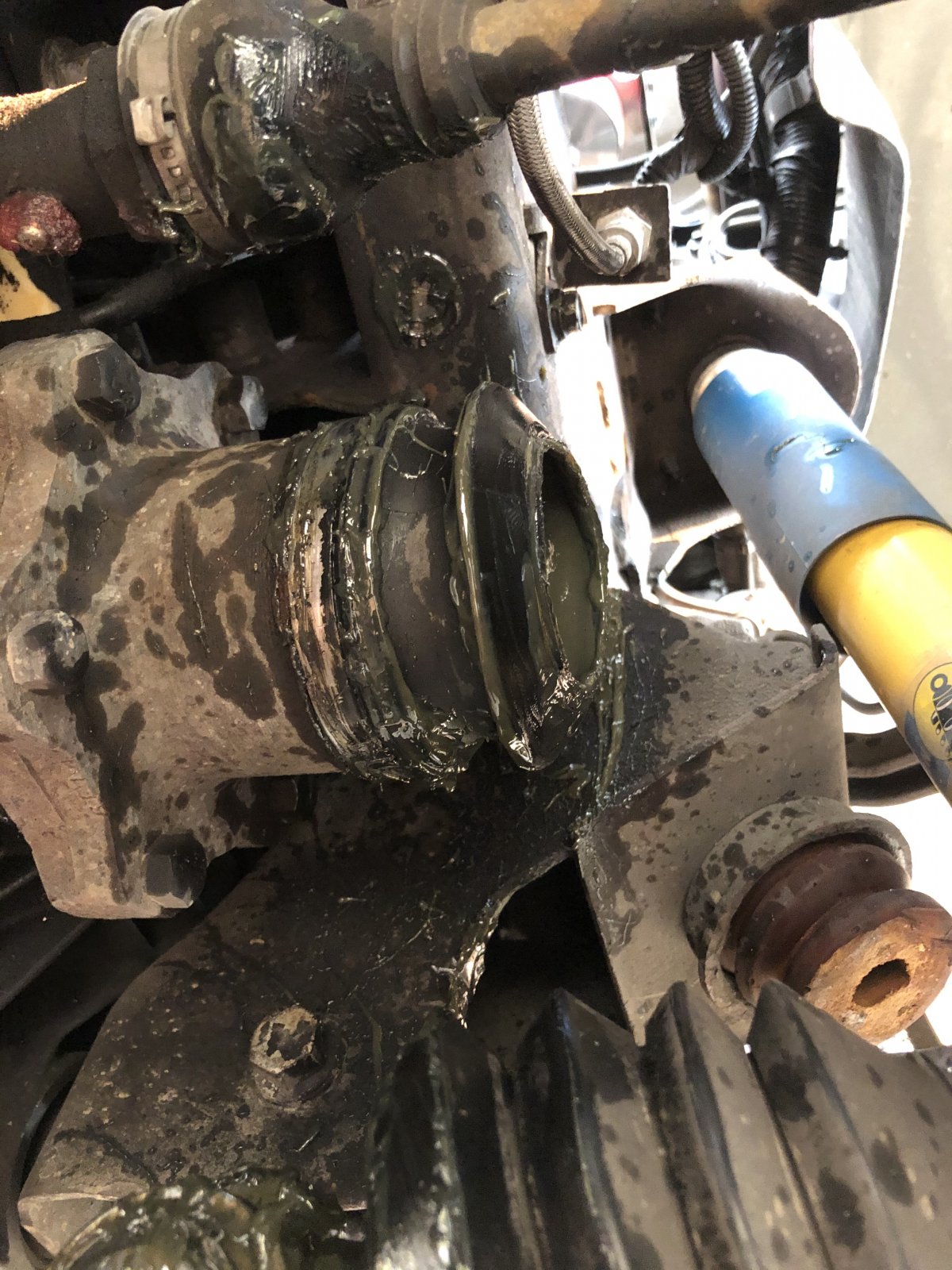

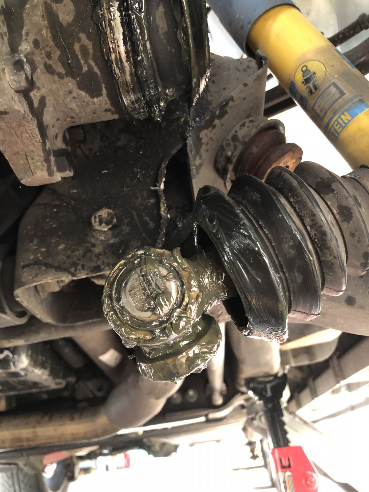

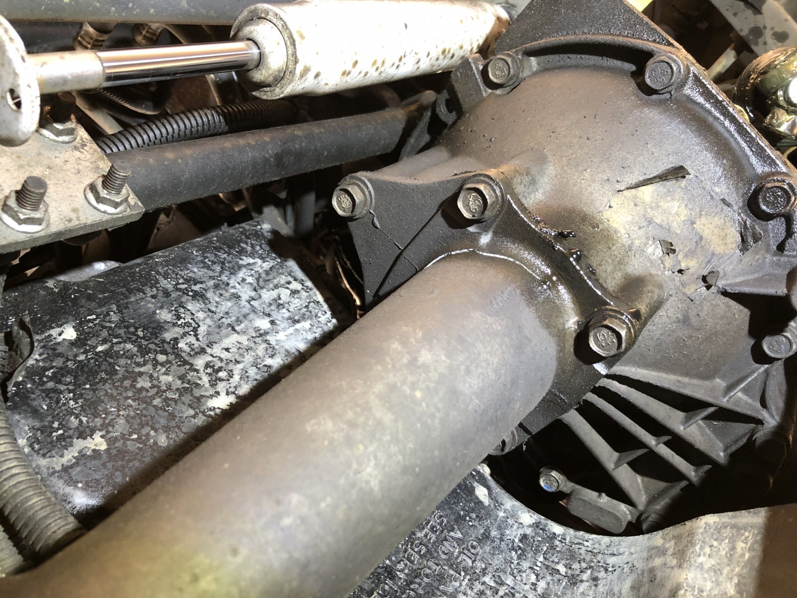

The Beast absolutely destroyed the front diff, guess it didn’t like a WOT launch from a stop in reverse. Snapped a CV joint on the driver side and most surprising was it snapped the passenger side axle tube, cracked that mofo all the way around. Ordered a rebuilt diff and both CV axles.
View attachment 257359 View attachment 257360 View attachment 257361 View attachment 257362
Surprised you did't catch the carnage on video likes others @Tonyrodz, lol. Oh what i for got @Tonyrodz doesn't do stuff like that.
