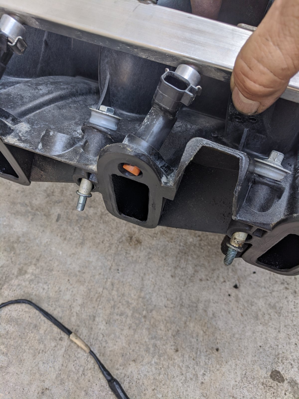

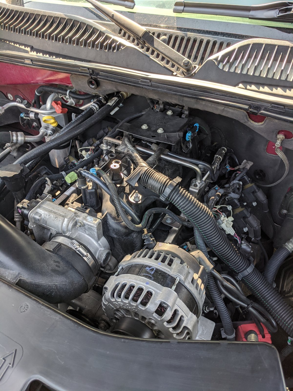

I followed this video, everything was the same except the injector harness is a different design, the only thing that threw me off was the 44inch/89inch lbs which is like 3.xx/7.*** ft lbs

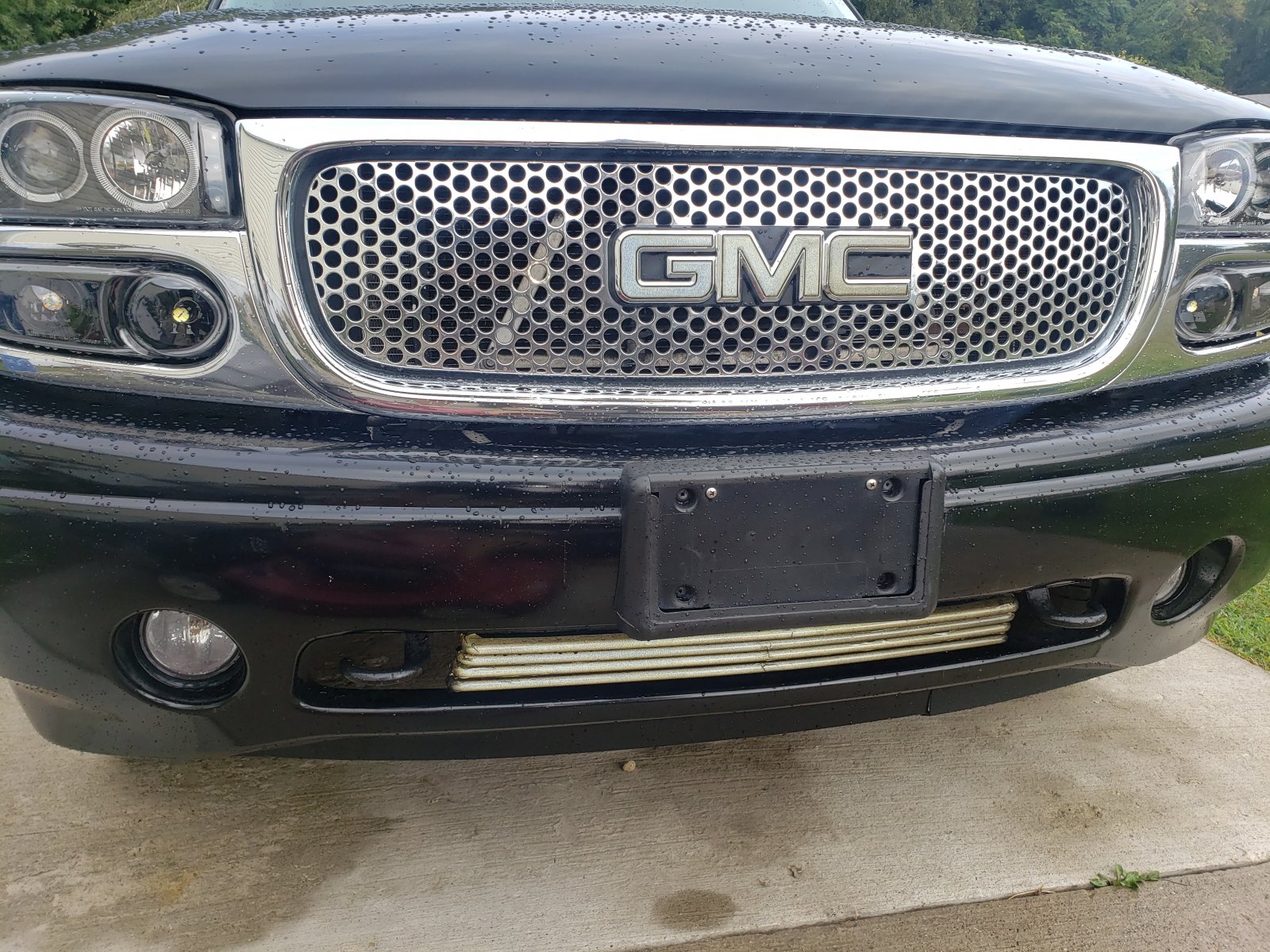

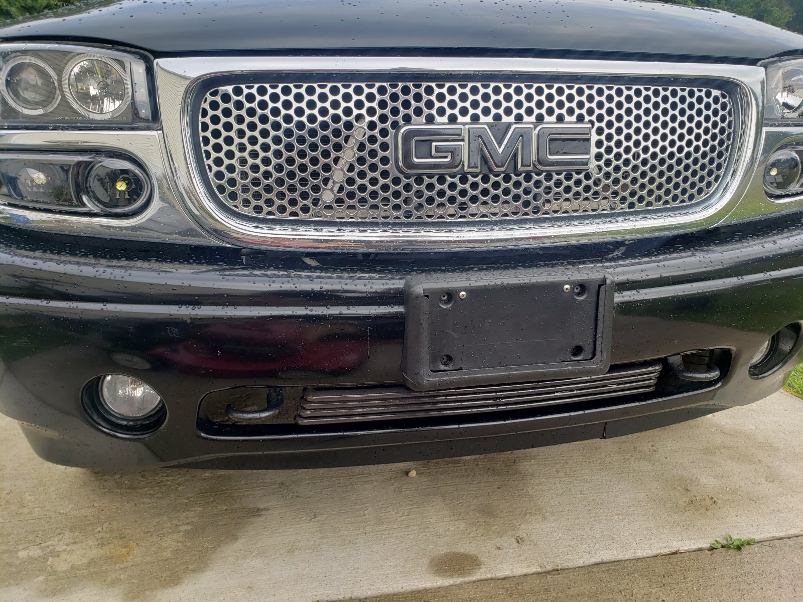

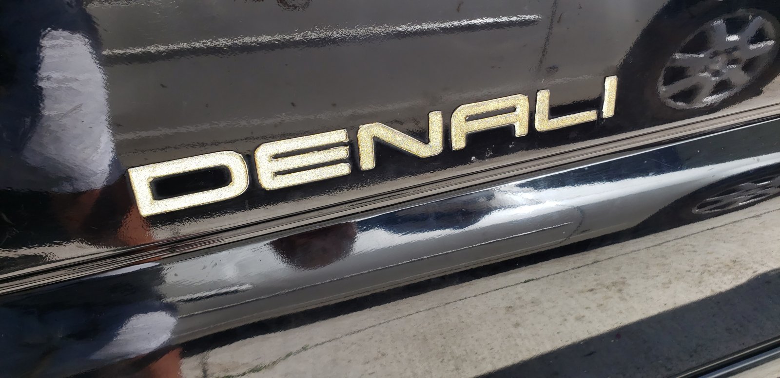

20200826_115146.jpg 20200826_115142.jpg added more 3m reflective onto the lower bumper grill this time. I need a heatgun to avoid the wrinkles next time. 20200812_123459.jpg 20200812_123507.jpg and the doors, these were a *****. I def need a heat gun.
What you think?

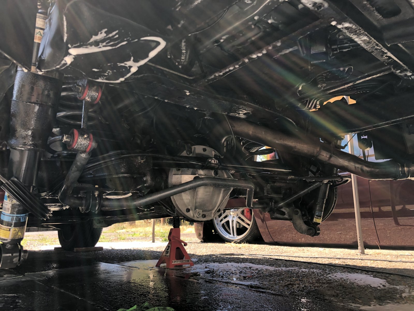

Took the Hoe out of commission for a few days to do a few things and drove the Denali, as there was no rain in sight. :cool: :D :burnout:

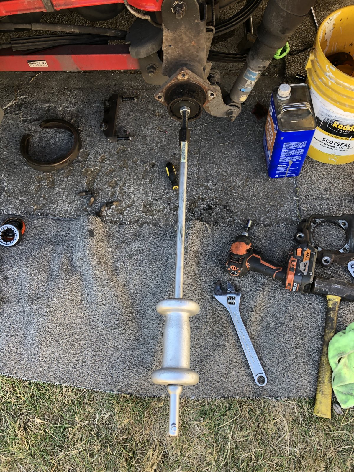

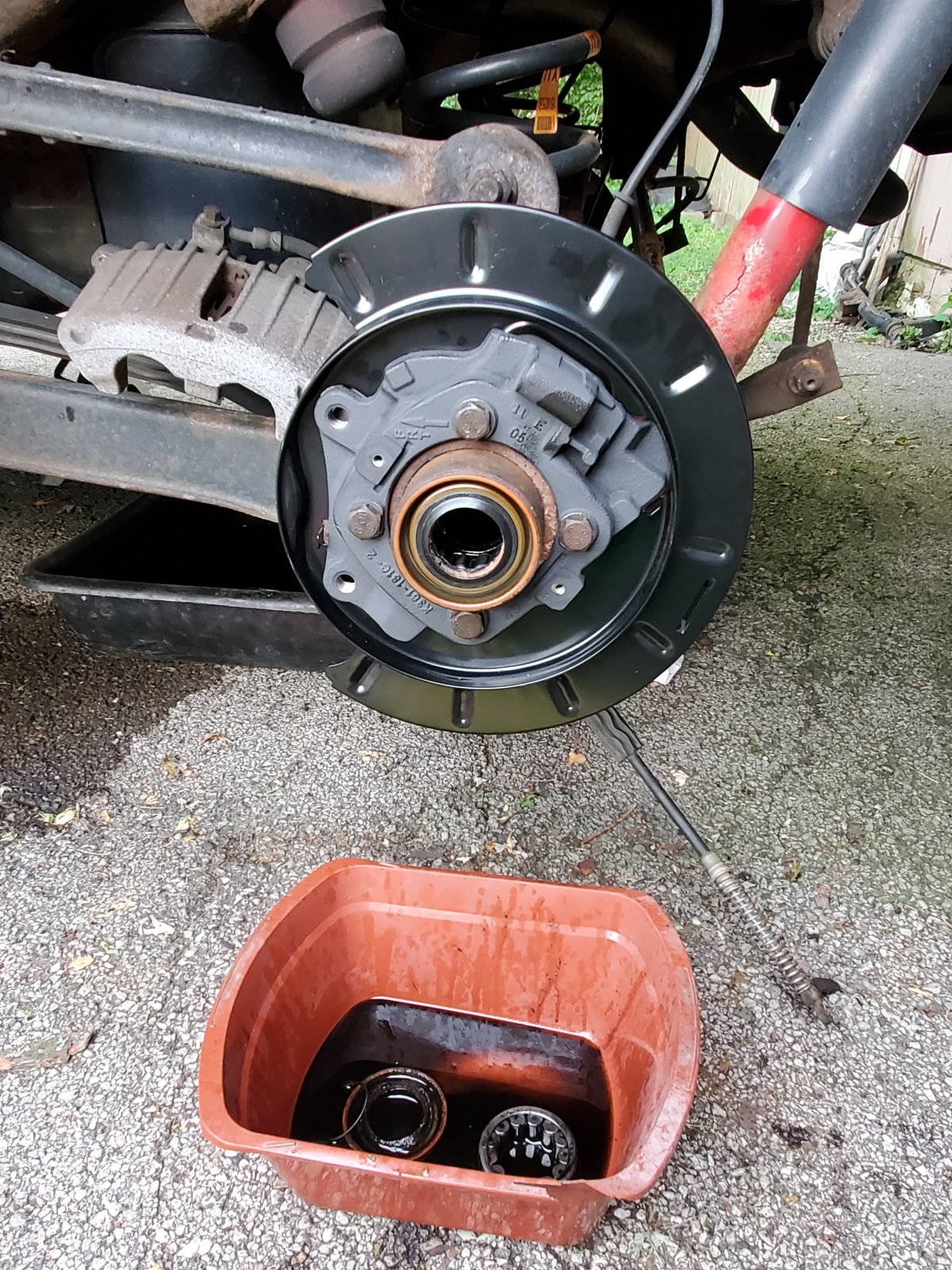

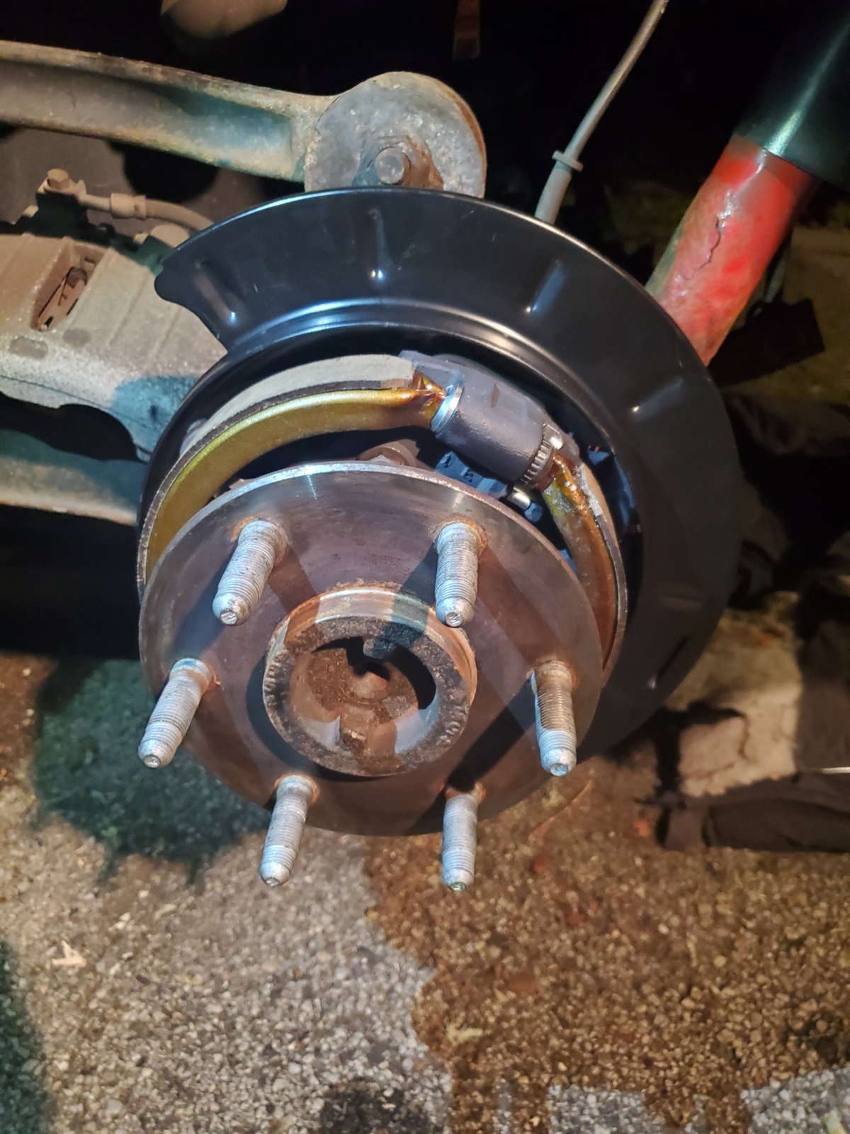

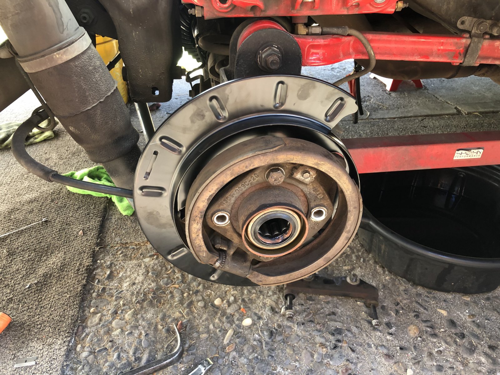

Out with the old, in with the new. Axle bearings and seals. One piece dust shields. I hit the mounting assemblies with the wire wheel and some high heat black i had laying around. Lookin fresh.
Axles back in and all new R1 Concepts parking brake shoes and hardware. I checked the adjustment when all was said and done. It holds the truck, but could be a little tighter. I will adjust it a little during the upcoming phase 2 of the project.

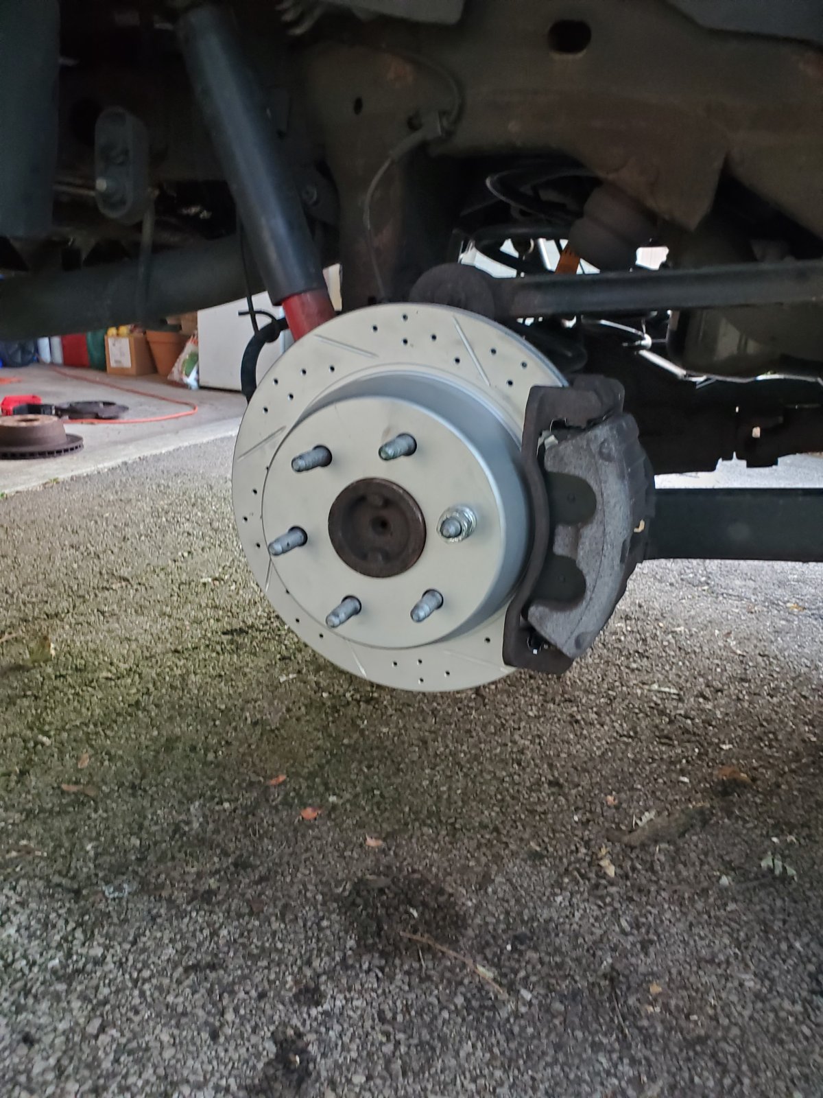

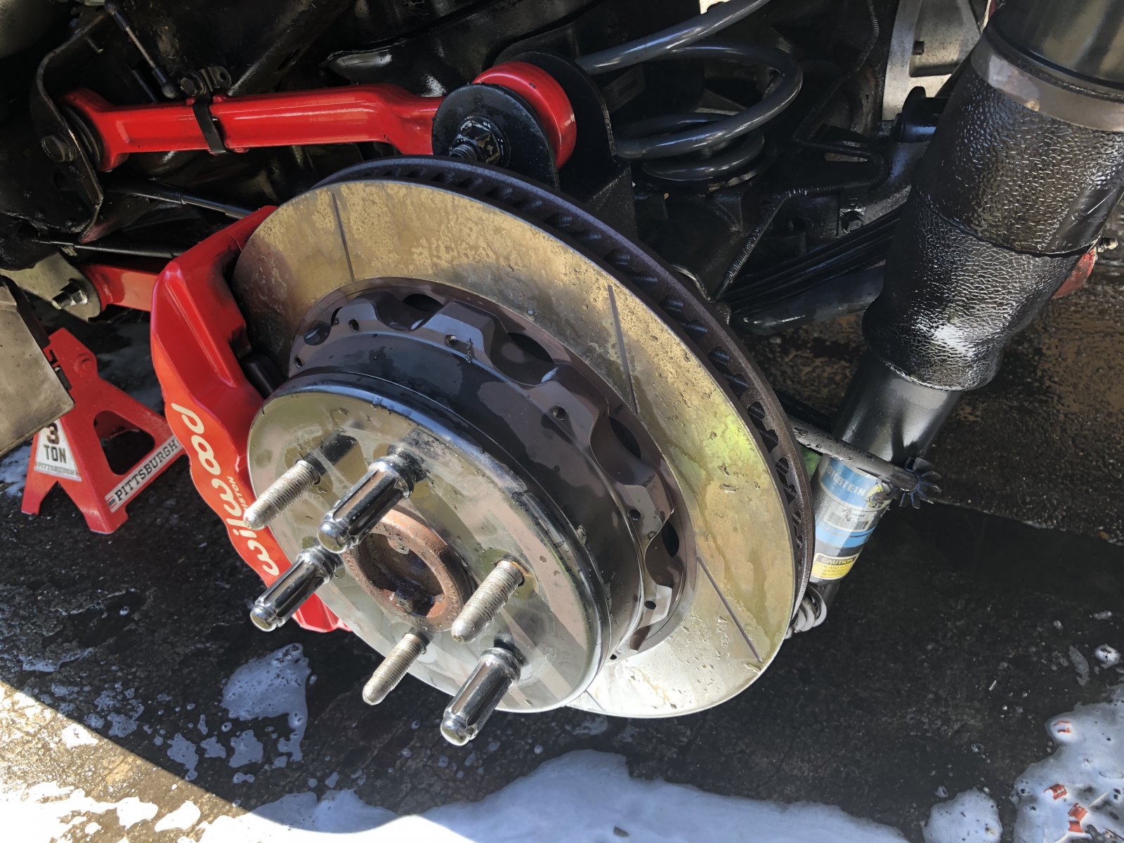

R1 Concepts drilled and slotted Geomet rotors with their Optimum OEP pads. Phase 2 will be new calipers (including nnbs for the front) that are in the garage awaiting POR15 red paint along with Goodridge ss lines.

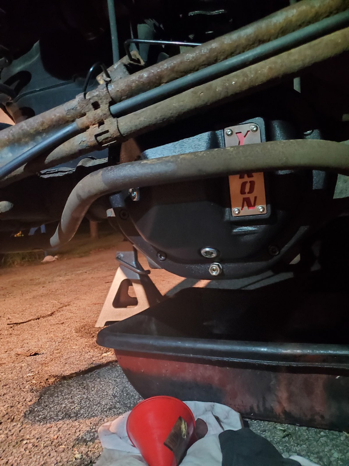

Also indulged in a diff cover with drain and fill plugs. I think Yukon Gear provided a good balance between looks, function, quality, and price. I did pull the nameplate and add a little red (for hrspwrs). It's super heavy duty and the inside shape is pretty close the the OE cover, so fluid dynamics should be fine. I used a Lubelocker gasket. I love them. The cover is thick enough that I had to drop the sway bar to get it in. I'm not a huge fan of the Allen fasteners, but with some of them recessed, there's not really much choice.....or is there? See the bottom center?
As I was torqueing my final pass (30 ft/lbs.), that bolt spun out on me. At first I thought I had rounded out the Allen (why I hate them). Not the case. Then I thought, "cheap hardware." Nope. I took it out and the threads were full of material. I STRIPPED THE THREADS ON THE DIFF HOUSING! Oh no. So I scrounged around a bit and thought. I drilled it to 5/16, tapped to 3/8-16, installed a 1.5" SS stud, and topped it with a ss nut. Worked great. Looks even greater, imo. I just may do it all the way around when I do a new sway bar one of these days. Used the Delco GL-5 fluid. Gears looked good.
I also did the charcoal canister and vent valve solenoid while i was under there. CEL gone.
Took it to the industrial loop by my shop (gently) and performed the R1 bedding process. Working great. Phase 2 coming soon.

Nice work! I despise the Allen head bolts everybody seems to supply with diff covers. That Yukon cover looks tough, looking forwards to phase 2.

Whew. When you said you torqued the intake manifold bolts to 44 ft lbs I was hoping you didn’t crack it. I think you got lucky more than once on that job!
ya as I was tightening it I was thinking hmm these must have been loose before, I was using a 1/4' ratchet and it was feeling pretty snug so I switched to a 3/8's, then my thought switched to hmm maybe the information was wrong as I was twisting then snap, um shit I thought "maybe the bolt just popped out" haha thankfully these have the rubber bushing or yes it might have cracked the intake plastic

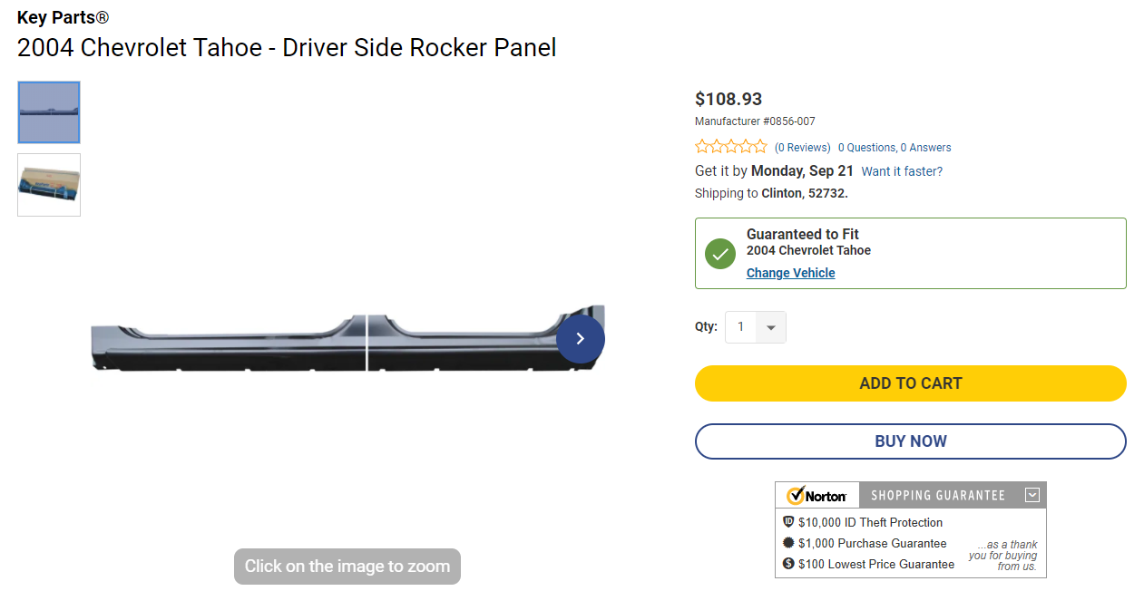

Has anyone purchased new rocker panels online for their NBS? Mine are getting the typical midwest rust and I want to fix it before it eats away at the entire truck, everything I have found so far is parts for extended cab Silverados and I'm unsure of the fitment. I have a reliable body shop that can do the work, they are allowing me to get parts on my own. Any help would be great! Thanks!
https://www.carparts.com/details/Ch...By2CTvugb7PLLHOWmrcaAraOEALw_wcB&gclsrc=aw.ds
Like this
