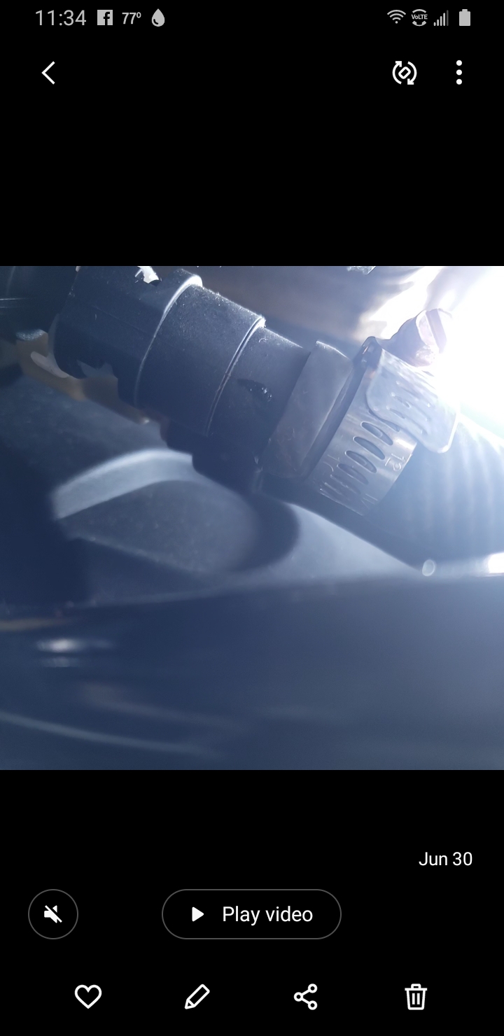

Yes it is, are they common for that? After a while it clogged up and stopped leaking.
Consensus about Dorman's parts is 50/50--with some parts being an absolute "NOT". Are you brave enough to leave it on since it stopped leaking? If it was me I'd change it. You know what'll happen--locally it'll be great, no overheating, no leaking, but as soon as you go on the highway on a trip the ***** will break! Causing you to get stranded. Me personally--I'd change it--while you can.

Definitely will, i forgot to change the post it's not the "Y" it's the connector to it, which I also put new. Will change it, wonder of Oreillys will change it , since I just bout it this weekend. Either way it's coming off.
Those Dormans Y's are known to fail fairly quickly and leave you screwed on the side of the road. They are bad enough that they have singlehandedly made replacing the Y fittings a topic of great debate and some people go to the extreme of putting in expensive metal Y's. The OEM ACdelco parts are known to last 150k + miles. I would replace them with the real deal so you don't need to worry again. The GM part numbers are 15055342, 15055343. Amazon or Ebay carries them. Or take your chances with the Dorman but you have been warned!

Changed the quick connect "Y" piece, its brand new and has a pinhole leak... WTF!!! LOL
I agree with going back with OEM. Or, for $10 and $5 more (respectively), you can get aluminum ones: https://jagsthatrun.com/collections/best-sellers/products/traditional-hose-tee

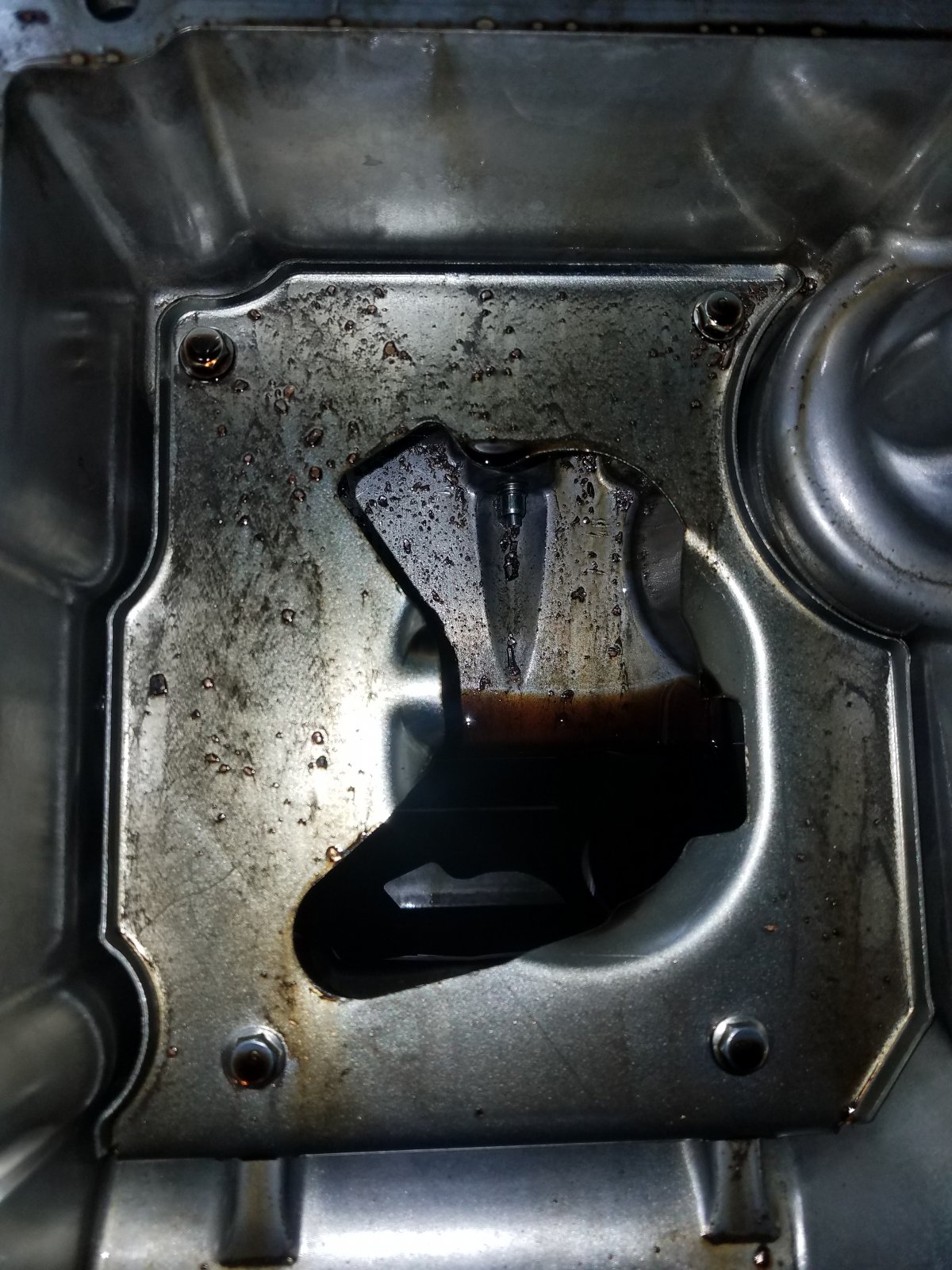

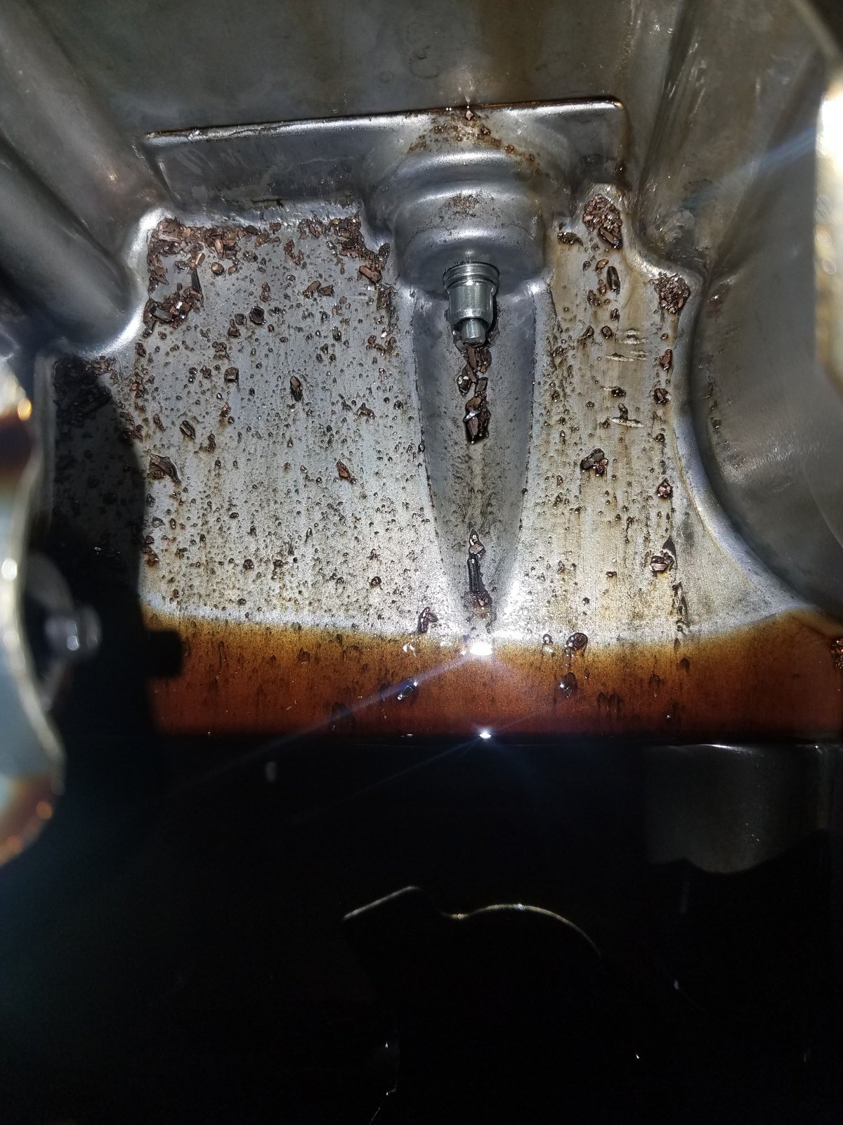

Bad news for my buddies Denali. Hopefully he shut it off before the crank or block were damaged.
Might end up taking a trip to Summit in ATL this weekend and pick up a short block to slap his prc heads on.
Still hoping the cam is good :D
33,203
51,461
View attachment 251328 View attachment 251329
No like!!! DAYYYUMMM that's alot of shrapnel. That totally sux. Do you think the cam could've gotten away unscathed?
I tell u wut we gunna find out! :crazy:
I was going to say that was the cleanest oil pan I saw until the second pic showed up. Hope you can salvage most of it
Never heard any knocking and never lost full OP so we are hopeful. Maybe just a single spun bearing
If I feel like it tomorrow I might have it out and apart. :elephant:
