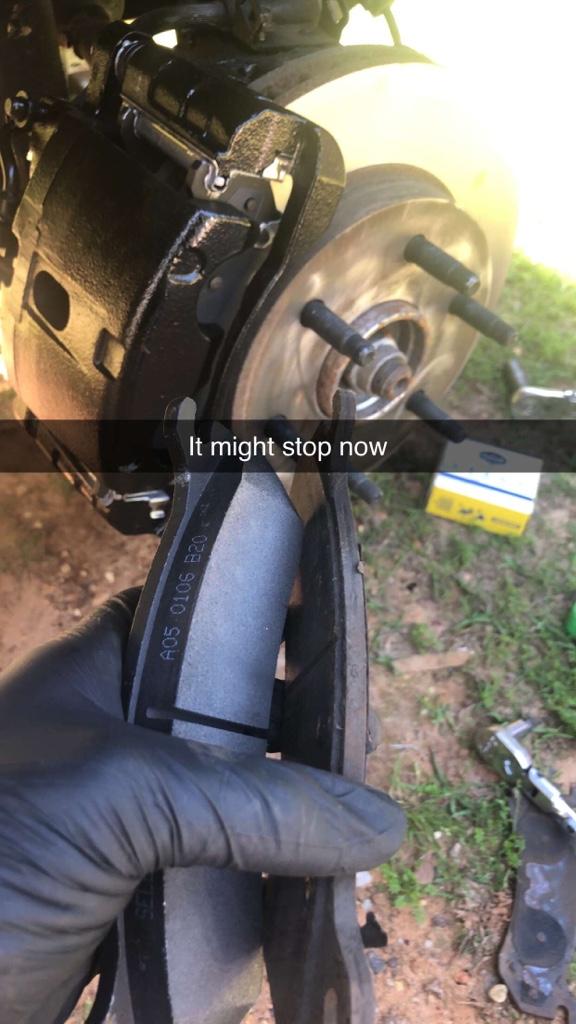

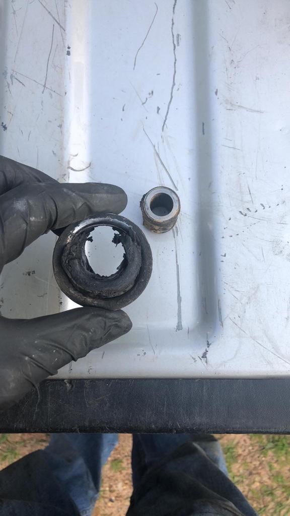

Balanced my tires and noticed a few things needed attention. That’s the lower shock mount. Also painted the calipers
Was that shock rattling?
Not rattling but every now and then I would hear a thunk. Could never pin point it. Even when I replaced all steering parts I didn’t see anything out of the ordinary. I just so happen to see the bushing torn a little when I was doing the brakes. Pressing it out finished it off for good. 20 bucks and all is well

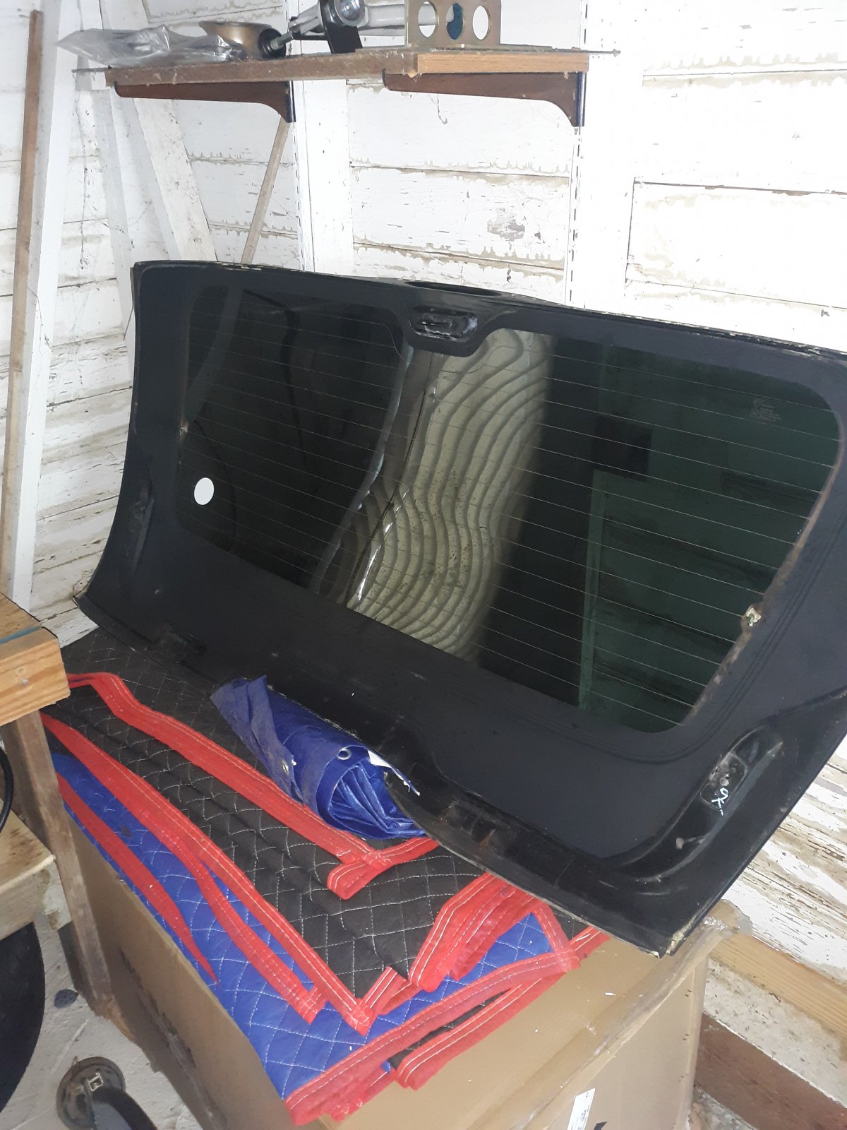

I thought you could buy new tabs.. hmm
Here you go: https://www.frostfighter.com/defroster-tabs-uni-clip.htm (2300-URX is the one you want I believe)
This is who you need to order the correct material from anyway. This stuff works! Not that useless crap from the auto parts store.
Whew that's over $60 to repair two little scraps of aluminum....I think I'll try the permatex for $10 and cut some aluminum or try a junkyard for donors.
52,949
Go right ahead. No sense learning from others who have been in the same boat. The Permatex doesn’t work, I tried it twice. Wasted $20 and it made a mess that was harder to fix with the Frostfighter. So yessir, try that Permatex. Shit does not work. Good luck! :crazy:

I tried it too. So ended up costing me an additional $20.. up to you dude.

Well given that, I'll skip that route. Didn't know it was Permatex you were talking about. Sounds bad. Looked closer today and realized , the contacts are still in place on the window connected to the defroster.
Like this:
They are only missing the part of the tab that connects to the plug. I'm gonna try to solder tabs made from a piece of 1/2 copper pipe, cut about 3/16 flattened into a 60 degree tab. It should be easy to tin, and highly conductive. Pinky finger for reference...
I fit them and they stay on well. I'll bend to 60 and solder tomorrow. It's burger time!
