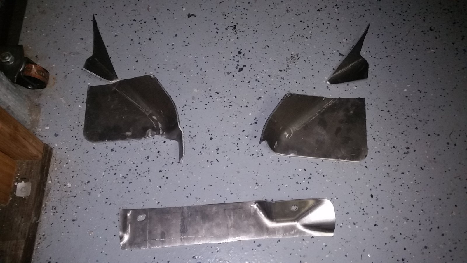

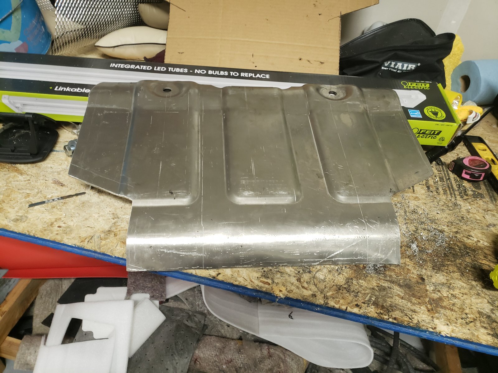

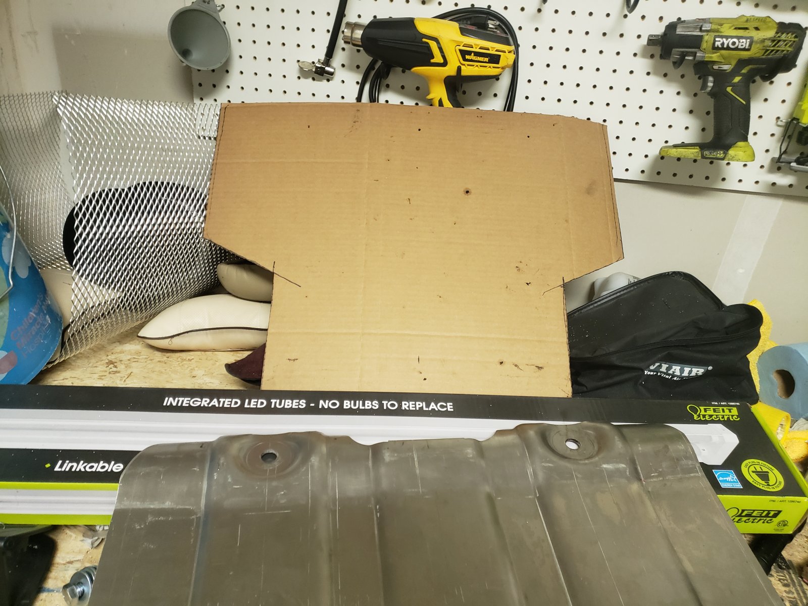

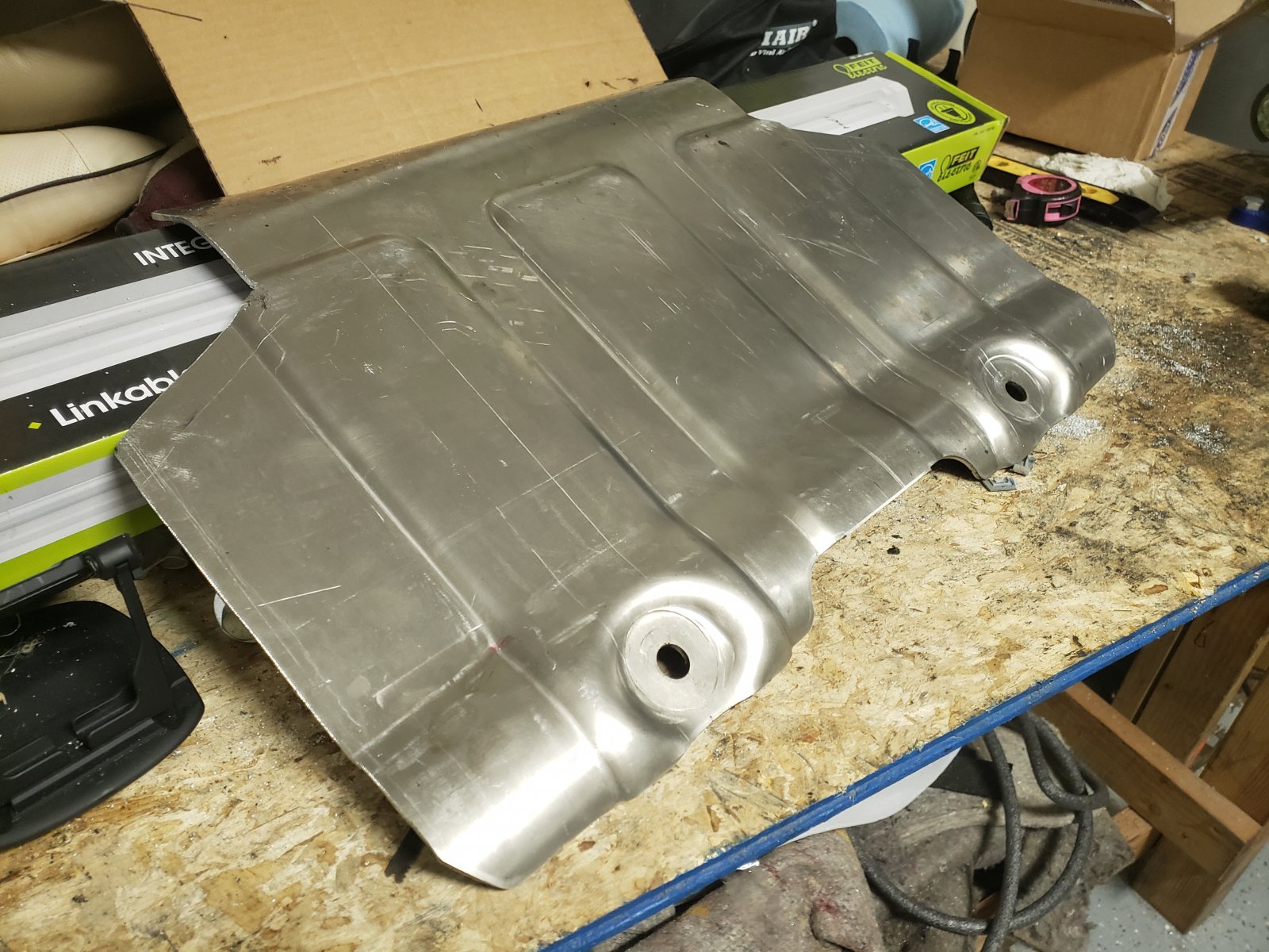

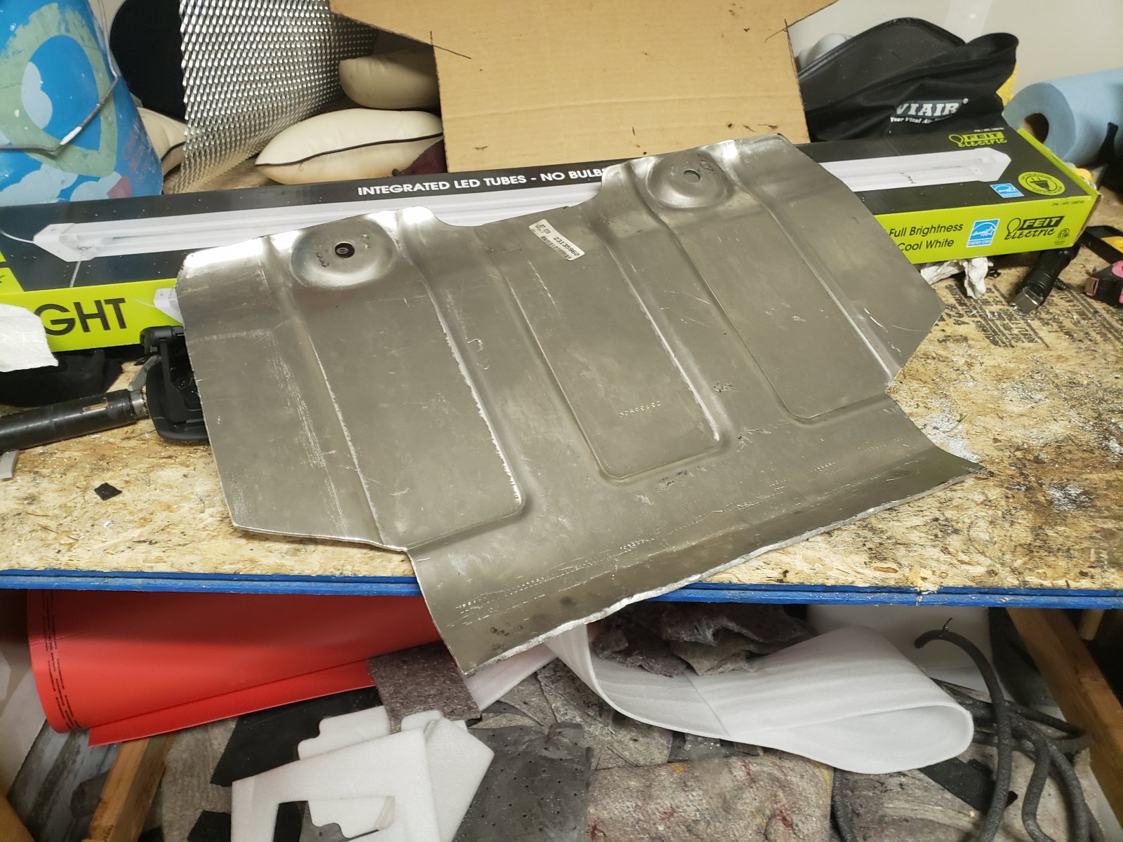

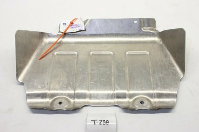

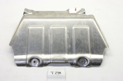

Info on the skid plate. What is it off of, and did you just cut it to the shape of your plastic one?
OK, this is GM 23135960. $75 on fleebay shipped brand new. Comes as a protection package on 2014+ trucks and SUVs. I just had to cut the sides and bend the lower edge to fit the frame. Top holes match the ones on the frame. I obviously had to drill the bottom holes. Overall. it took me longer to measure and prepare the template, than actually cut the metal. I attached the peices that I cut.
52,949
View attachment 245423 View attachment 245424 View attachment 245425 View attachment 245426
Interesting. I know they made a set for the 07-14’s so I thought it might be that one.

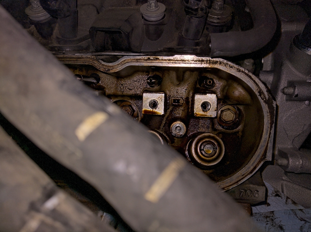

Been lazy and avoiding the work ahead of me but realized the stay at home order will expire at some point so I better have a vehicle for my commute. Started taking parts off to get the heada out. The milkshake in my post several weeks back was proof enough, but here's the passenger head - Castech logo and crack in all its glory.
My shopping list is made, but should I do lifters and trays while I'm in there? Waiting to see what version head bolts I need before ordering everything.

Hell yes I would do lifters and trays while you’re right there. Oil pressure sender too since the intake is out of the way. And knock sensors (AC Delco only) and harness. Do the RTV dam around them.
