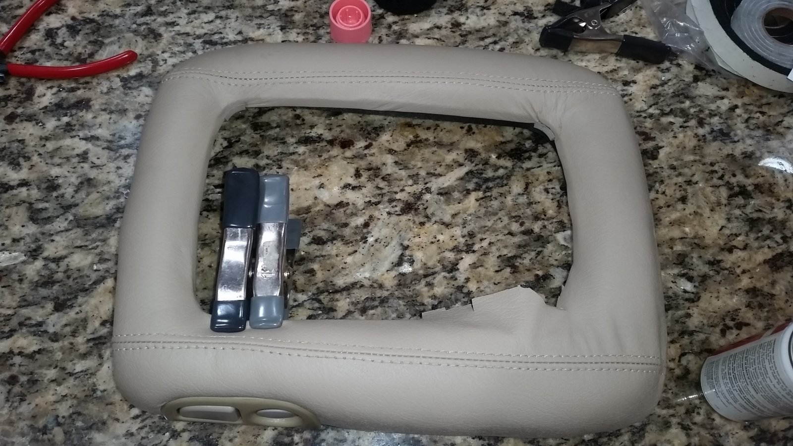

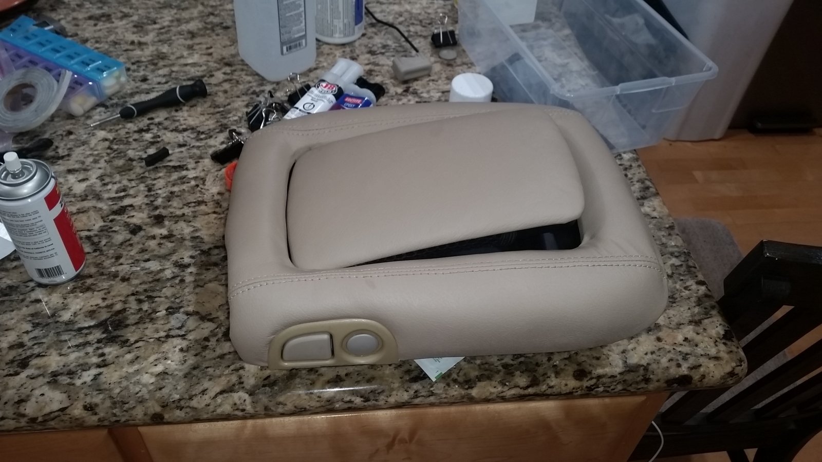

Good work. When I did my Silverado interior which included the console lid, I bought a special air stapler that shot 5/32” long staples so I could staple to the thin plastic without shooting through the other side. That stuff is definitely a PIA!
Where did u get it? Do u remember a model or something to identify it. I could't find anything alike. I have amanual stapler, but the staples are too large for this application
52,949
I got one off Amazon. I returned it after I used it, I only shot a few staples so it was still new imo. I forgot where I ordered the staples from, it was something like staple depot. I know it says 1/4-5/8 staples but it shot the super short ones too, I just bought the Senco c series staples.
Fasco F1B 7C-16 Fine Wire Stapler https://www.amazon.com/dp/B003WSI7IY/ref=cm_sw_r_cp_tai_yGlJEb3X2RYWS

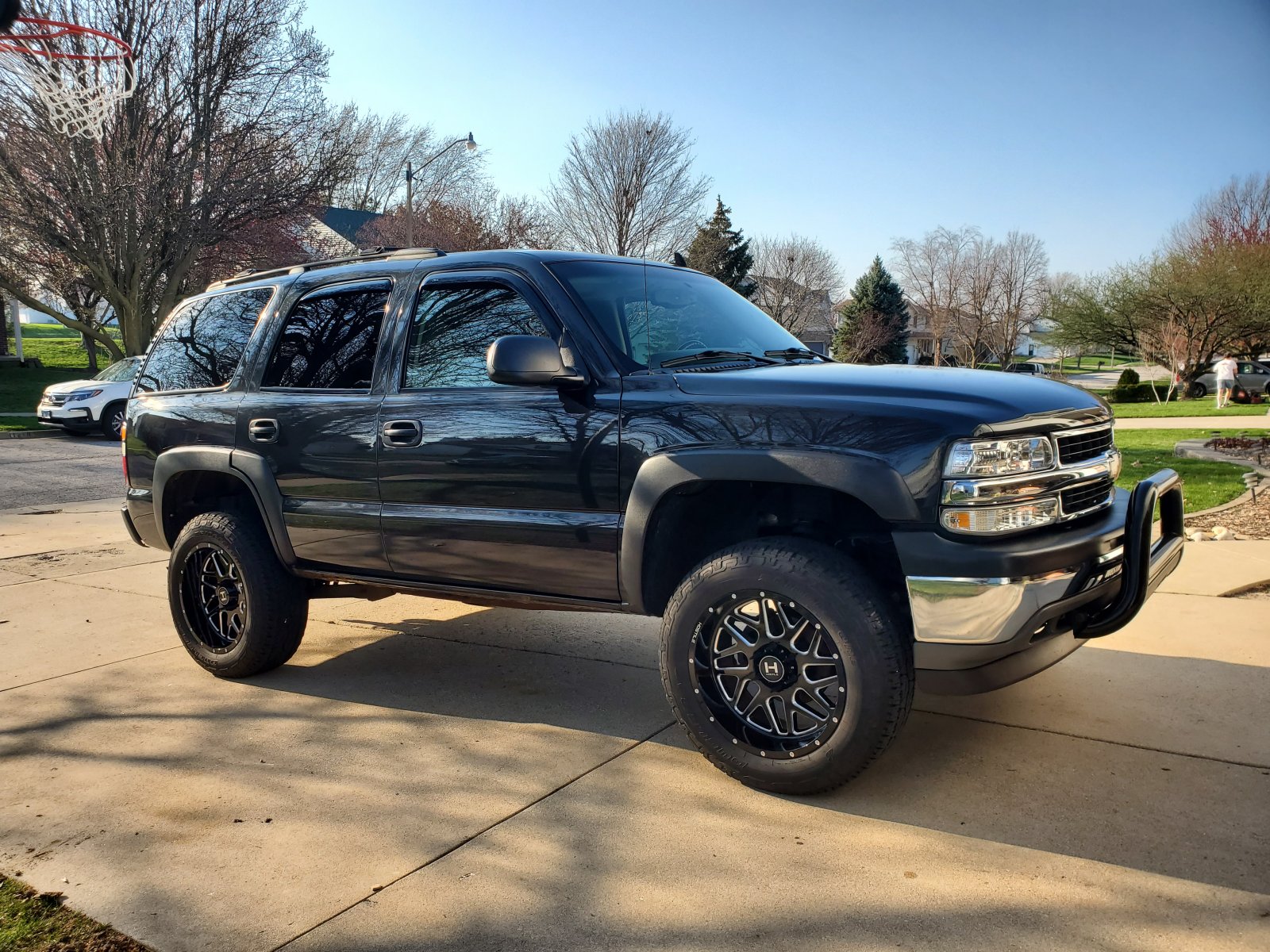

20200407_173927.jpg20200407_173909.jpg I washed it, cleaned it, and drank a beer in the sun with shorts on. Even though we are stuck at home, this was nice.

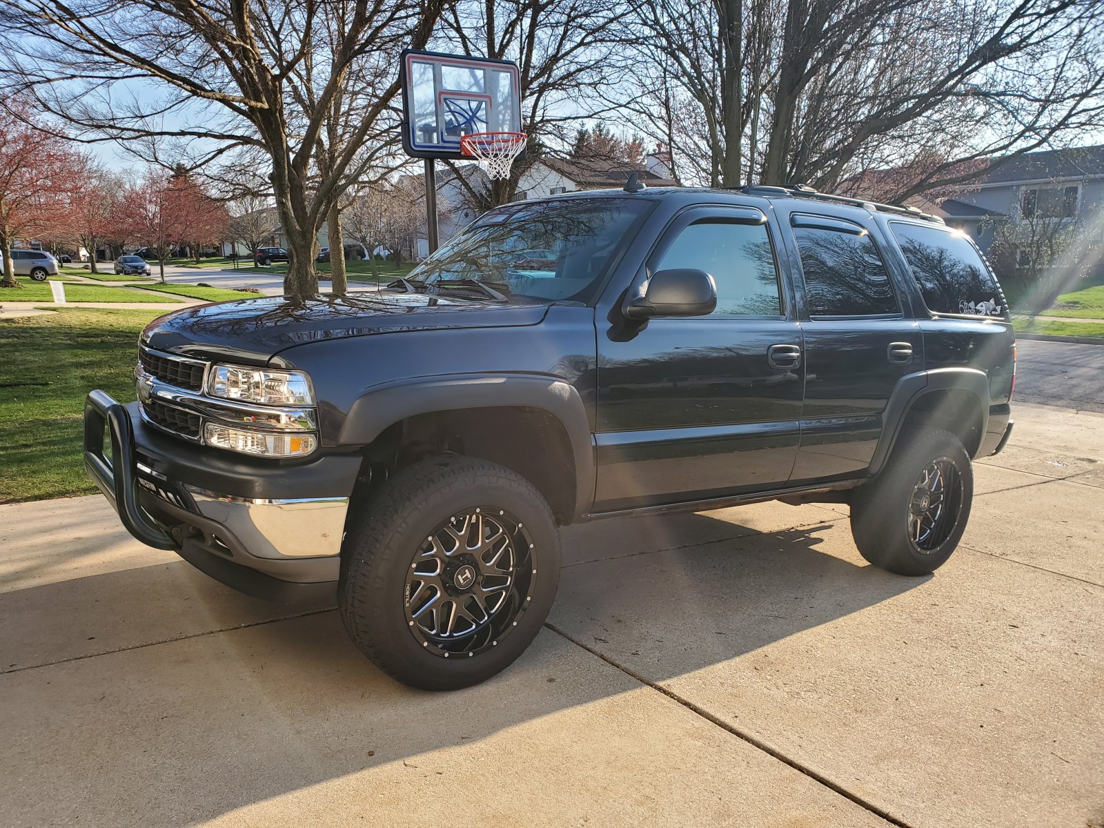

Purchased new 2020 Silverado 18" take offs, and bolted them up. Finally happy with how the wheels look and ride.
This week I started with 17's, went to Z71 18's with crappy tires, and now have new 18's with new tires. I think that'll do it for wheels for me!
