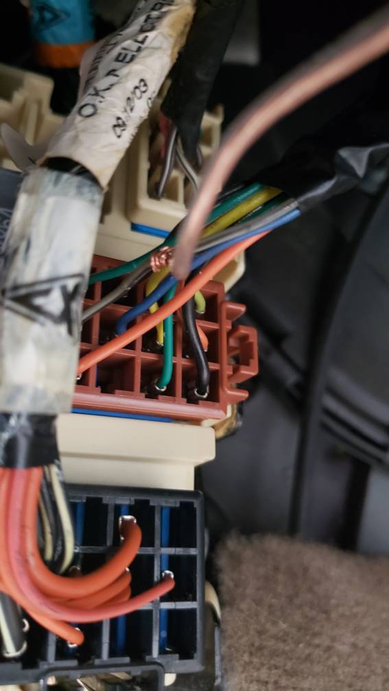

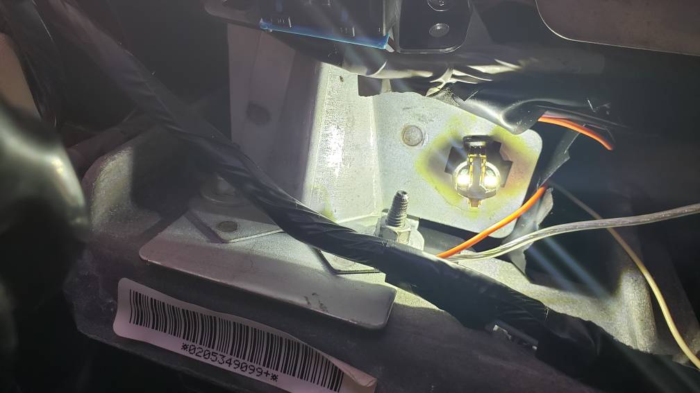

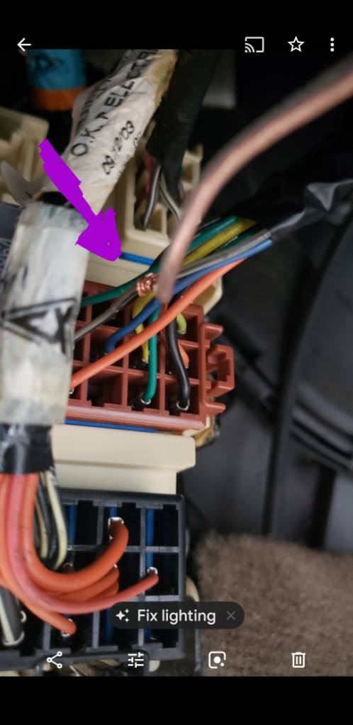

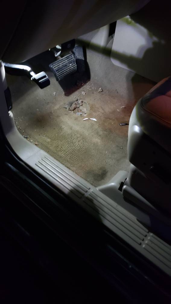

Got around to putting the foot well lights in. And I added some led 194 and man did it turn out great. These are during install and not of the finished product but just thought I'd show it.

Where'd exactly did you jump the wires off of?

In the drivers floor board fuse box there is a gray with black stripe wire next to a red wire in the orange plug. Connect the positive wire to this and I grounded them to the metal plate the light is mounted in. And it works great.

What's that wire for? When do they come on?
