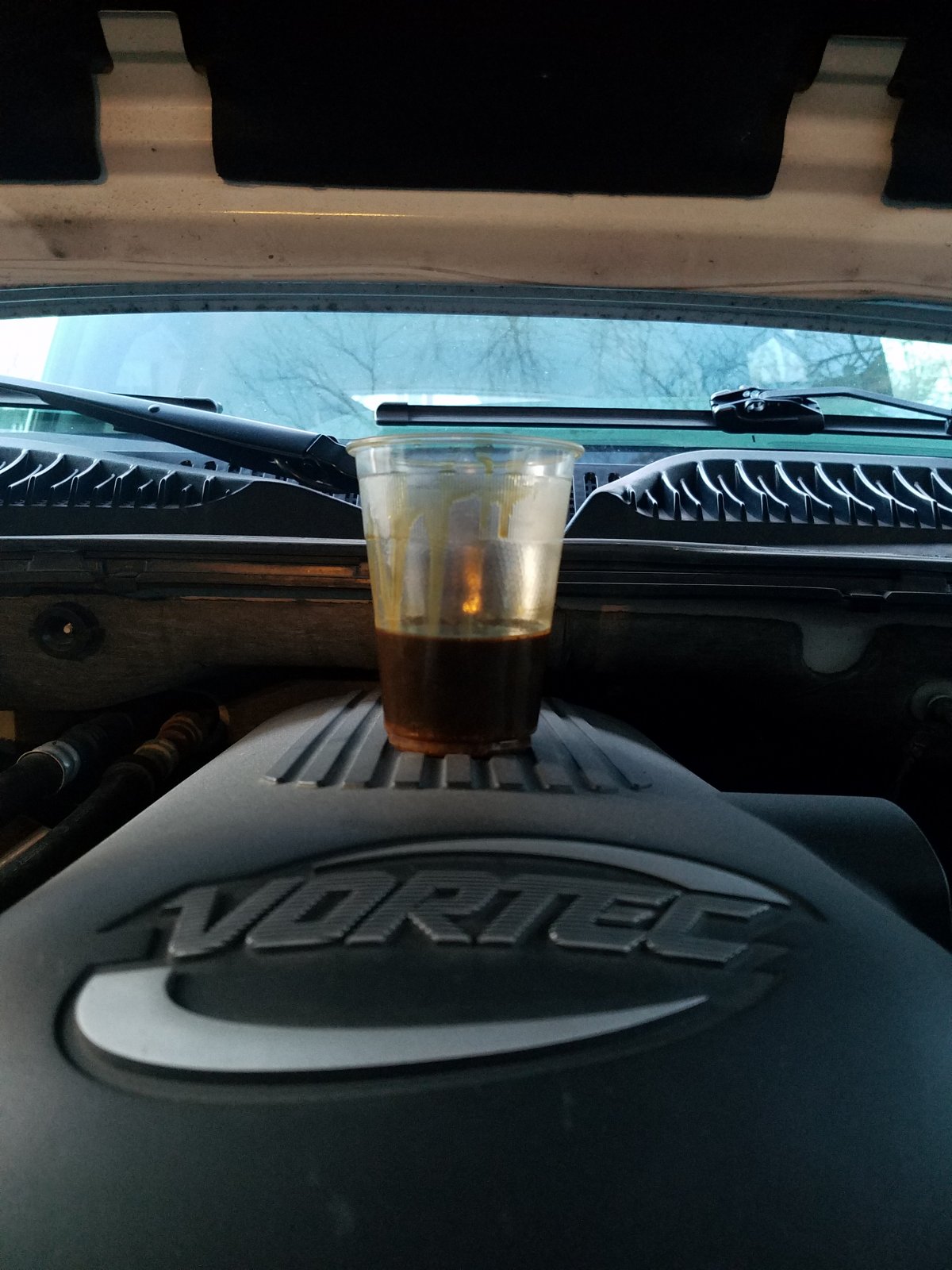

Finally got to be a balmy 31* today, so I did my overdue oil change. Blackstone has been telling me to push my OCIs, which I've said I won't, but well......here we are. 5797 miles. They told me to run 6k. I don't like the feeling, or seeing that number. Got a good sample so we'll see what the report says in a while.
Mobil 1 5W30 high milage (149119 on the rig)
Mobil 1 M1-107A filter
Catch can about normal (though not nearly as milkshake like last time it was winter)

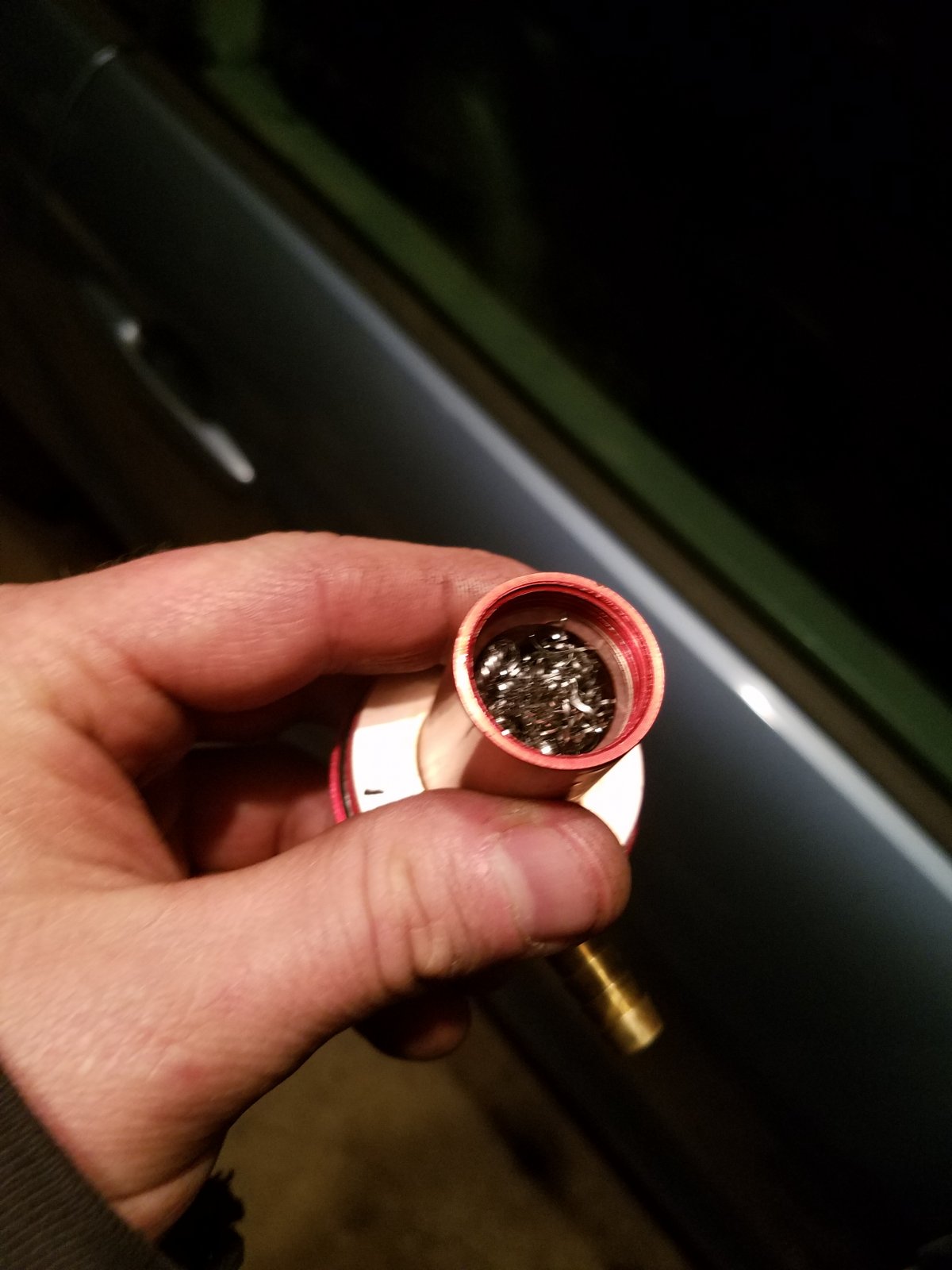

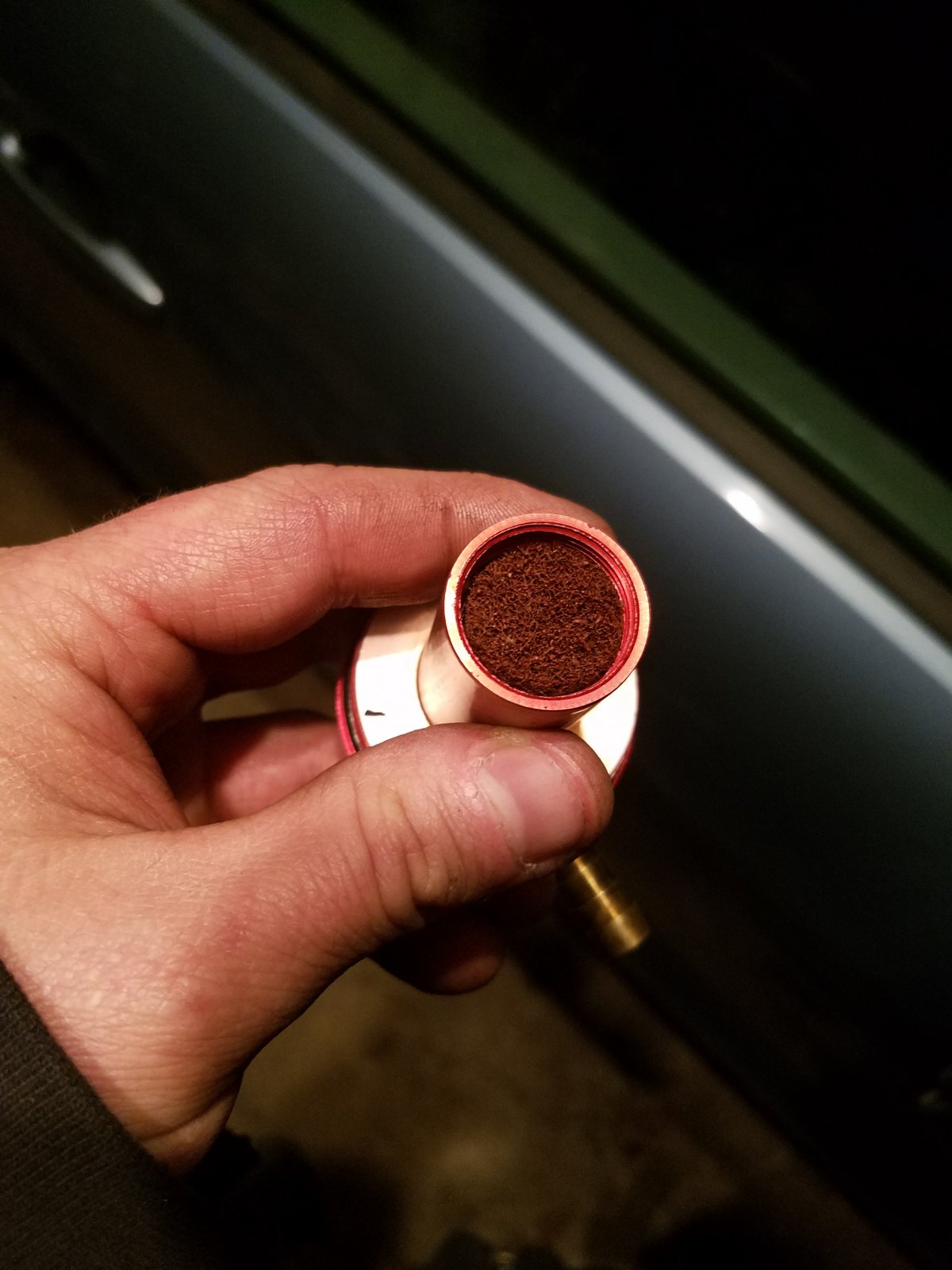

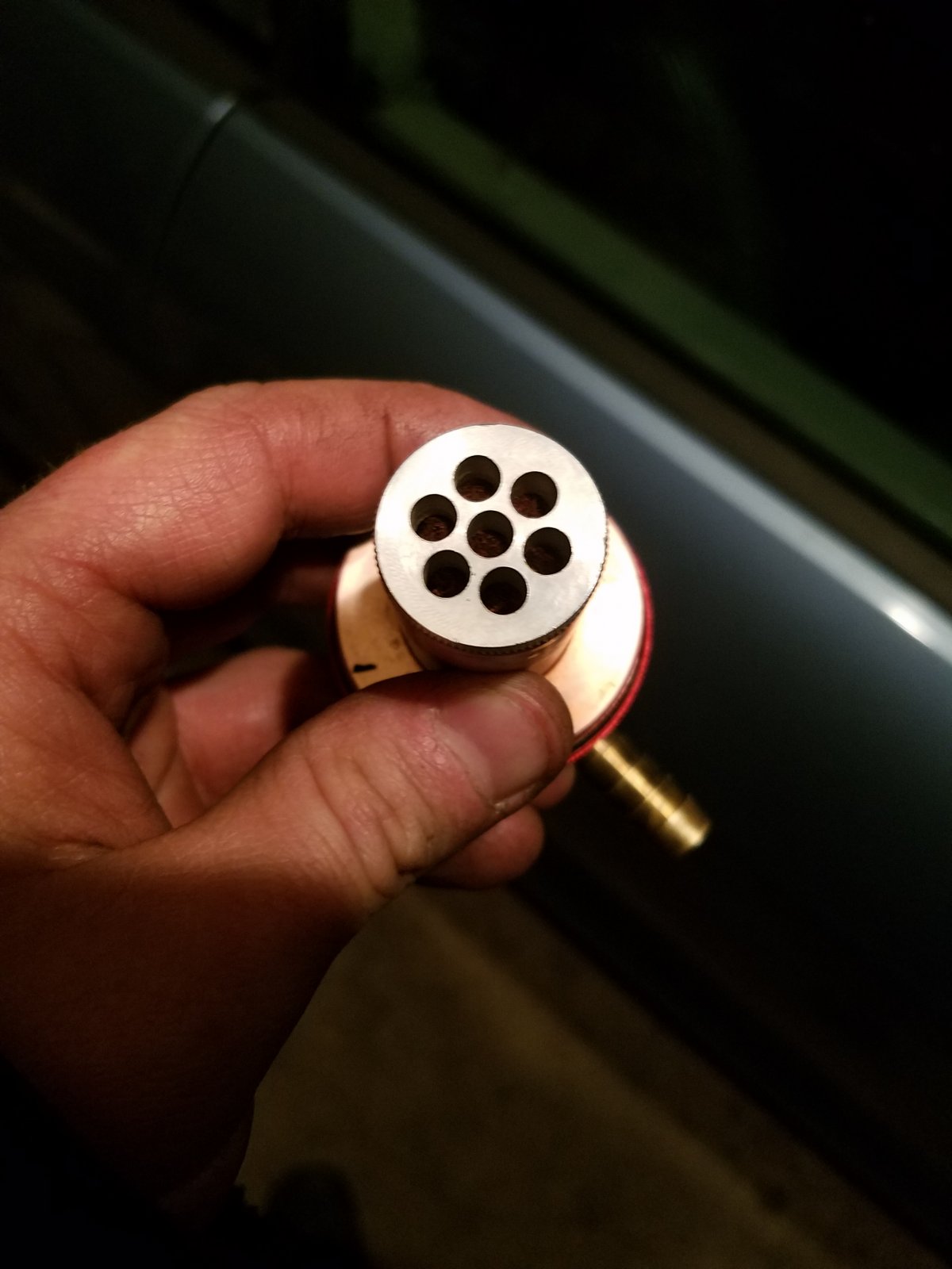

Added stainless scrubber for the first time. I put a little piece in between the filters in the baffle, and the rest of the chunk in the can.
There's one filter under here ...
One on top....
Capped...
In the can.
Already anxious to see if it catches any more this time around. It can't hurt, I suppose.

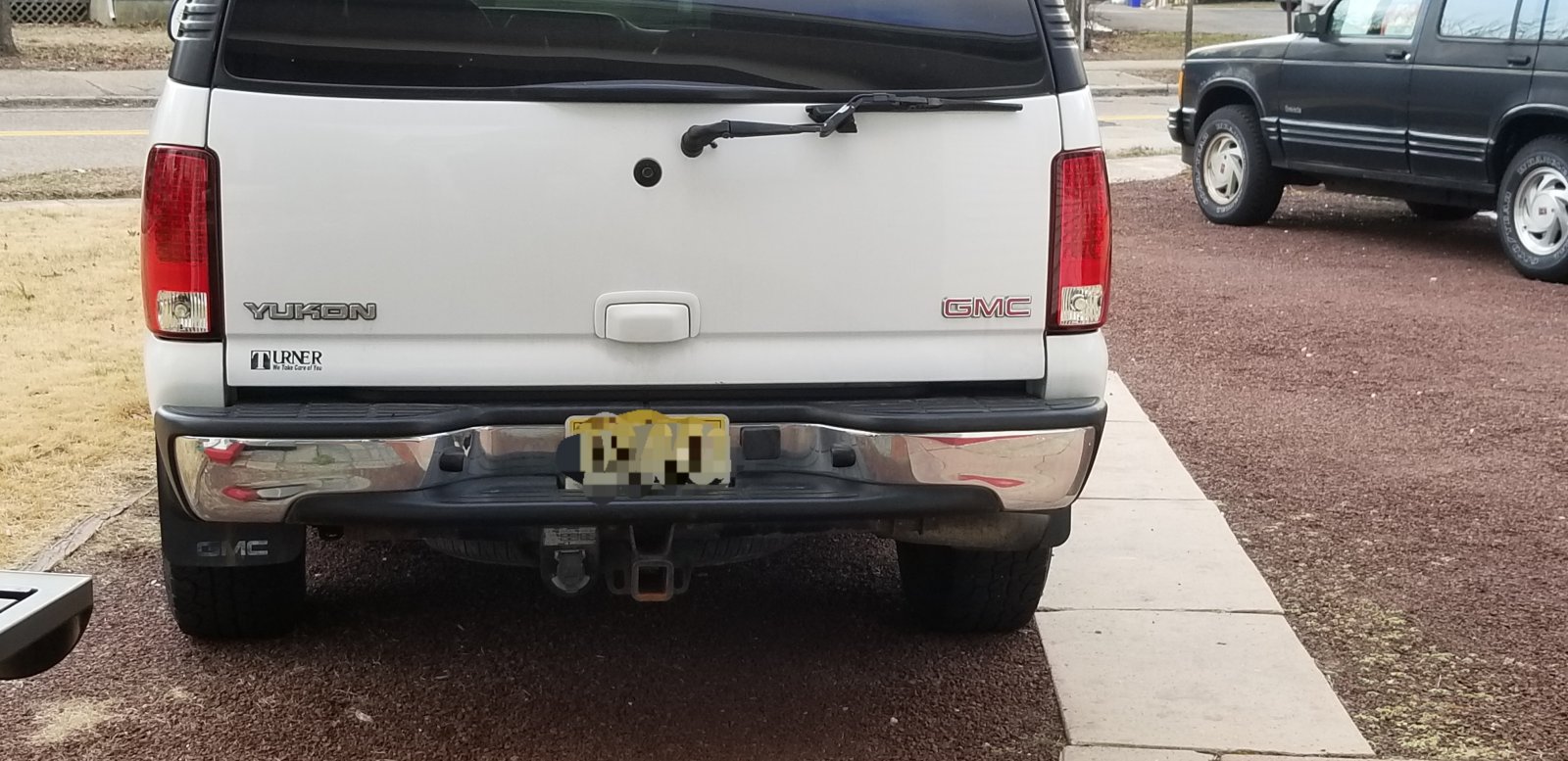

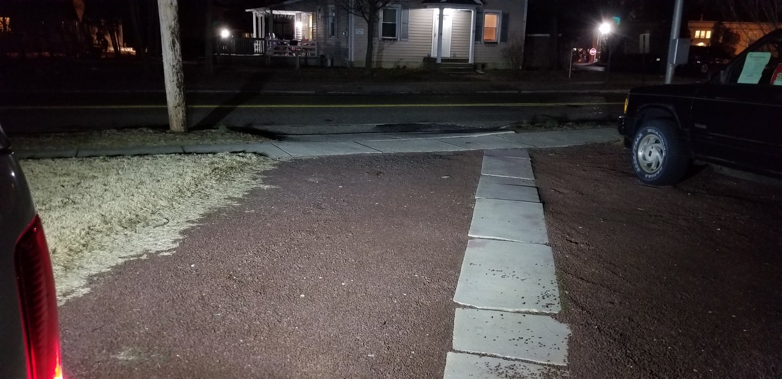

Put new taillights on today to get rid of the hideous stock ones.
Also put the jdm astar leds in the backup lights, they are way brighter than i was expecting
Aftermarket lights with crystal clear reverse lens is a night and day difference (pun intended) compared to stock tails. Then add quality led bulbs and the output is crazy.
