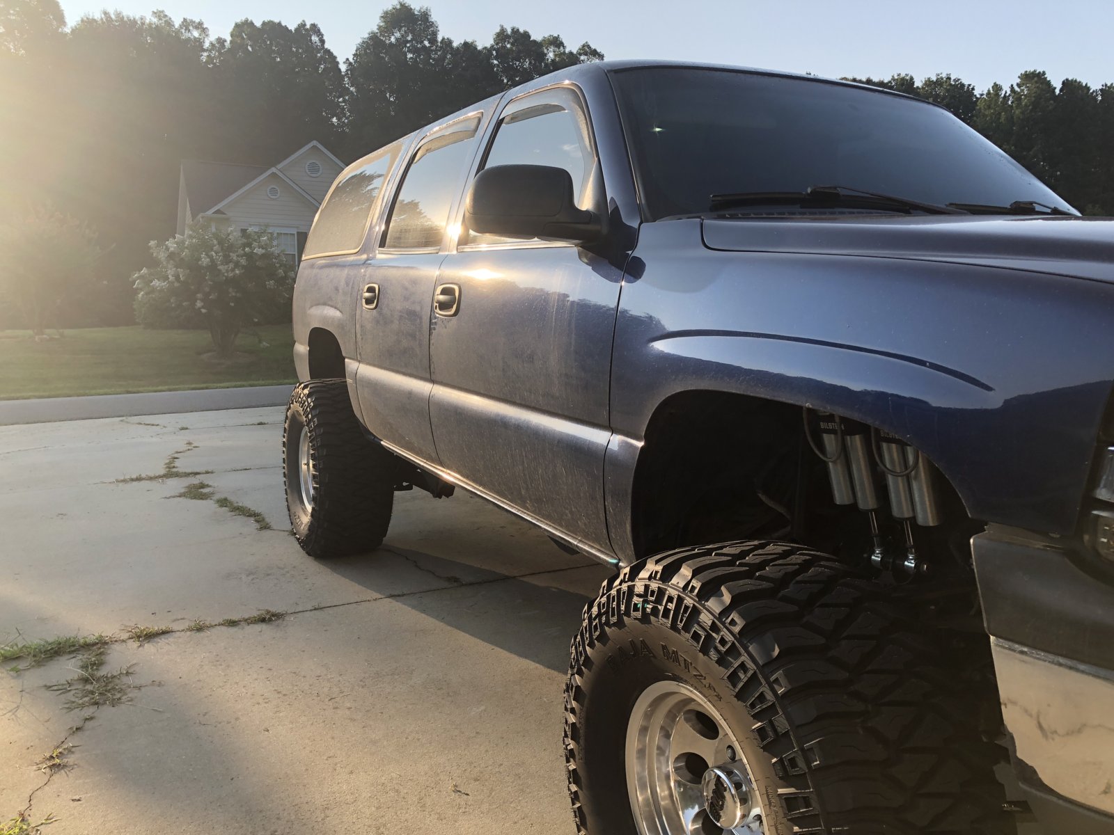

I drove my truck today like everyday, and thought I’d share the reality of 15wides and daily driving, she’s not always pretty! Clean only last a few days at most and it hasn’t been washed in a month.
:rotflmao::rotflmao:
It is tough one little sprinkler and wrecked. That's how I feel in my truck. The tahoe isn't to bad with only x12s and no spacers

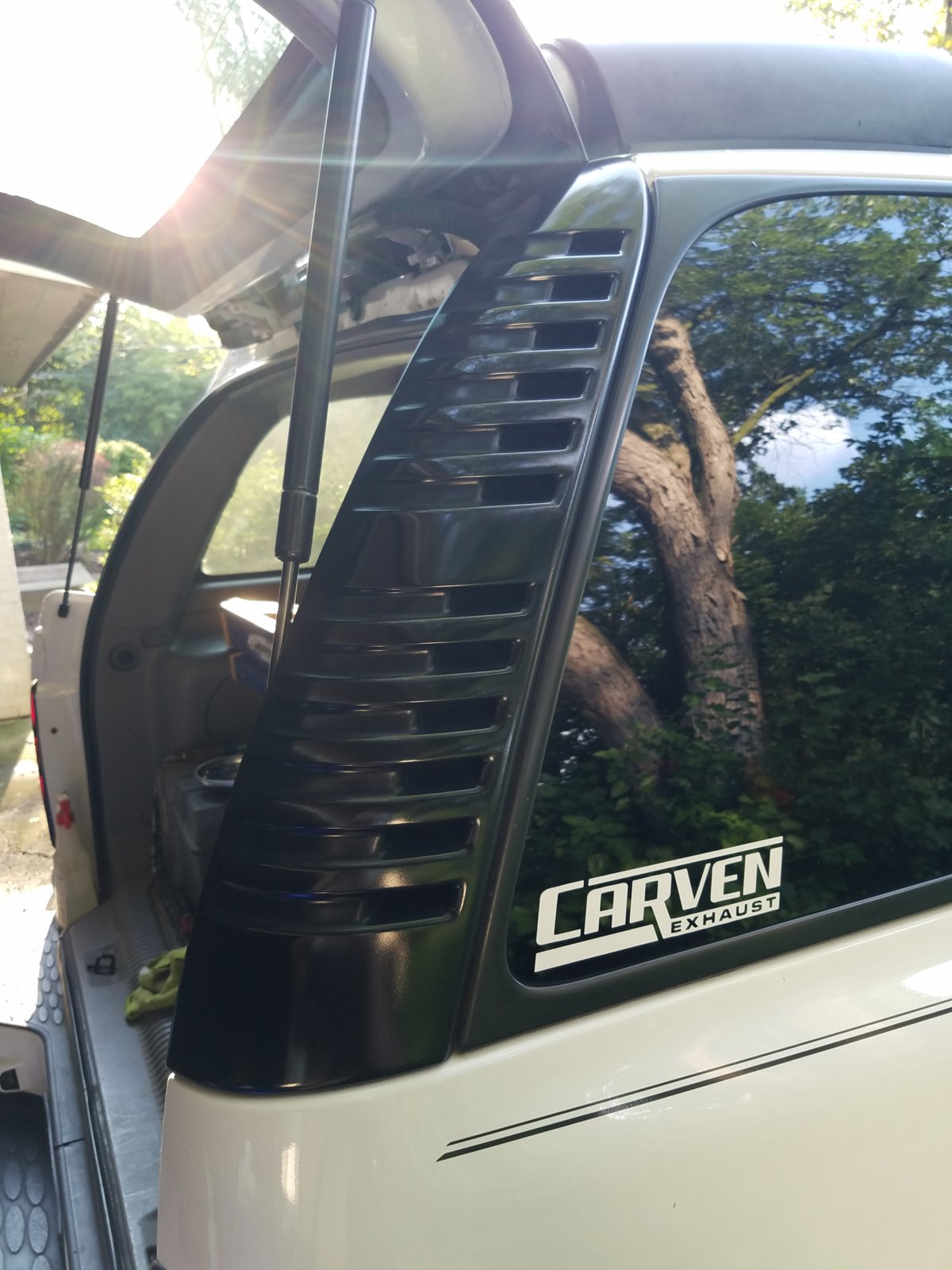

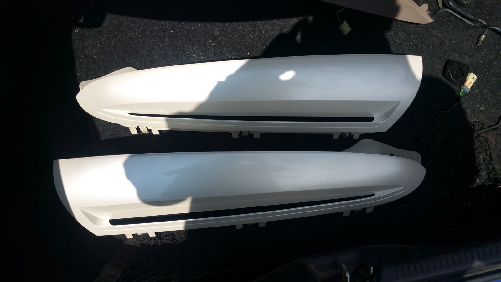

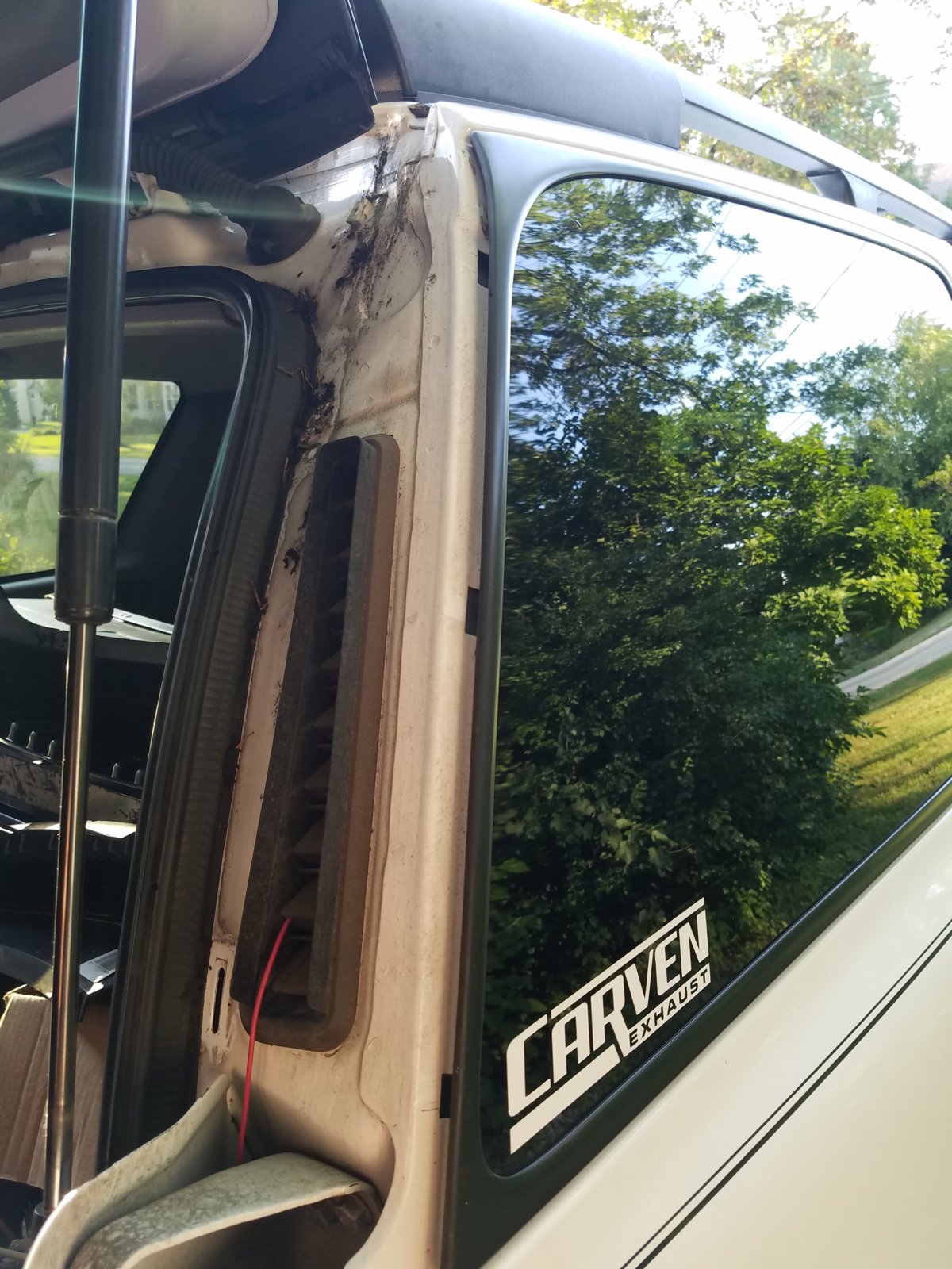

Finally got to my appliqués this afternoon.
Product credit to @ScottyBoy
Painting by @TheGreatGazoo
Thanks, gentlemen!
Out with the old...
Nice of GM to give us a secret stash for a bunch of rotting organic material...

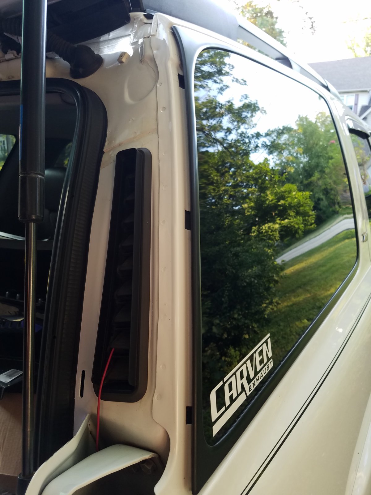

All cleaned up....

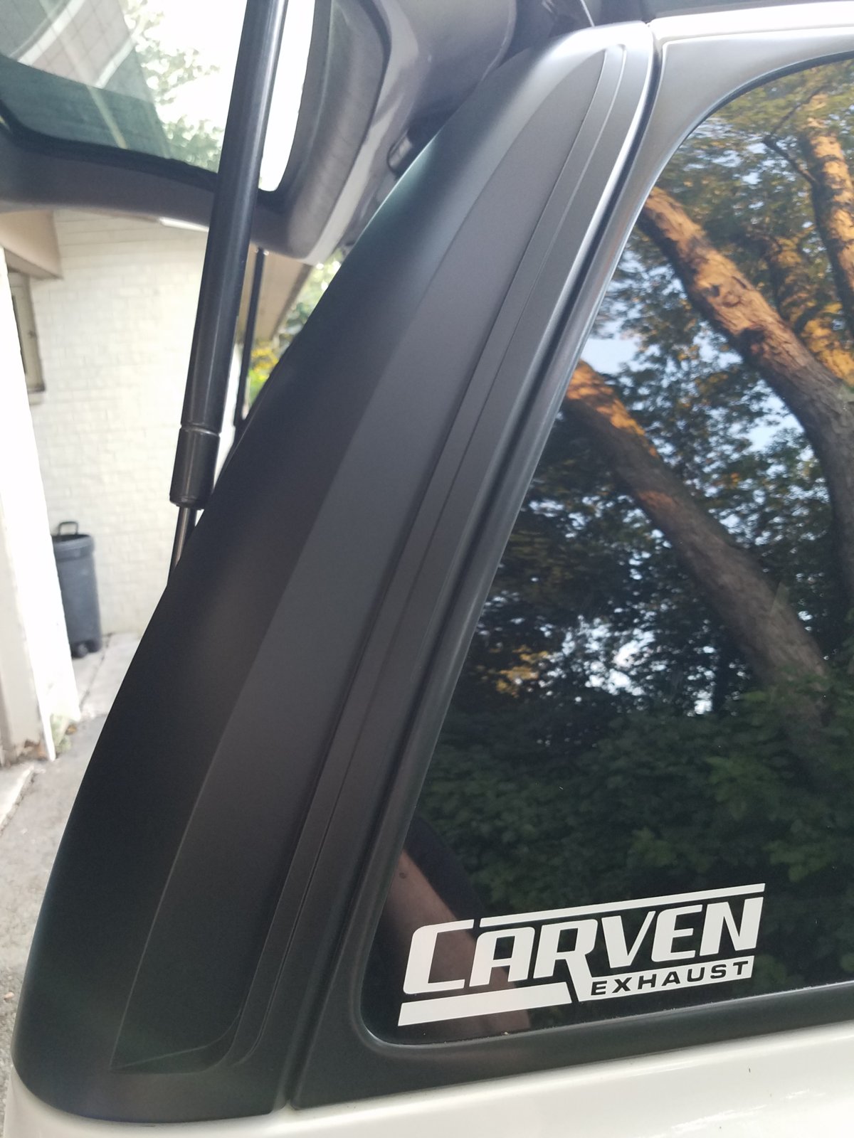

Evan told me they'd match the window trim. Damn, son. Nice job!
The big picture...
I see a carven sticker I'm not alone yesssssssss. How do you like it bud

You got that right, and sometimes you dont even need rain to ruin it. The other day a lady was literally watering her driveway and it was all out in the road and when I went through it both sides got covered and it came up on the hood and windshield. Lol

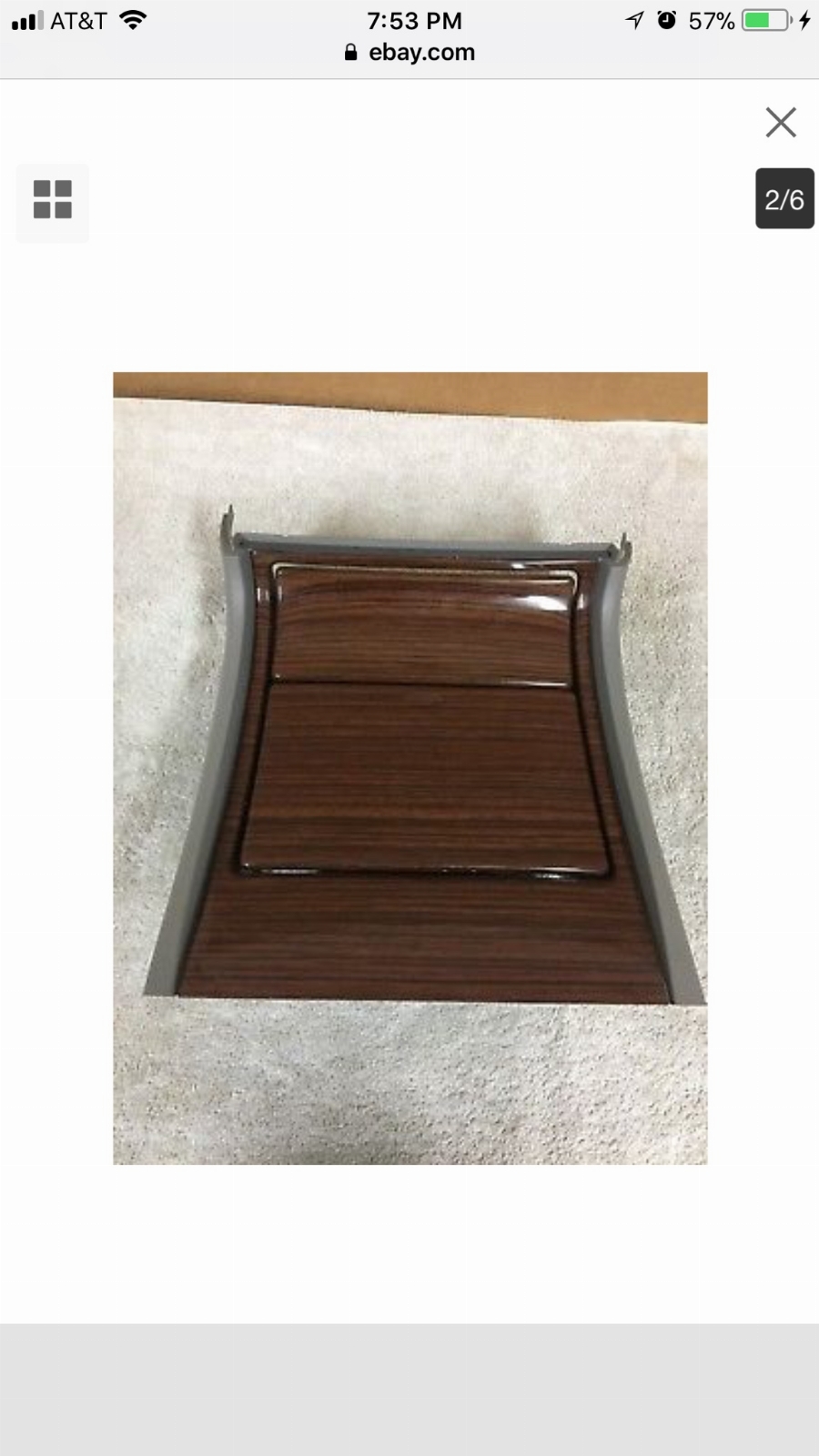

Scored a NOS GM center console cup holder/ash tray, mine was all scratched up will match the upper console that was a NOS find too

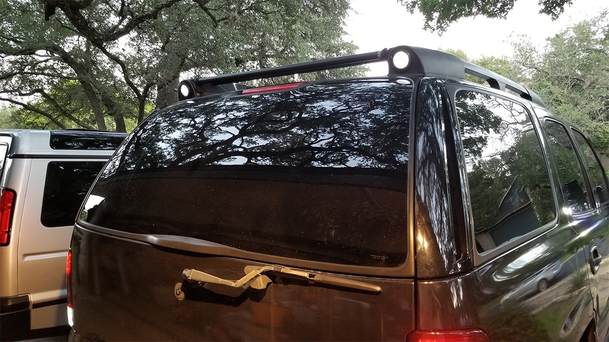

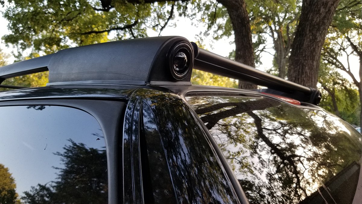

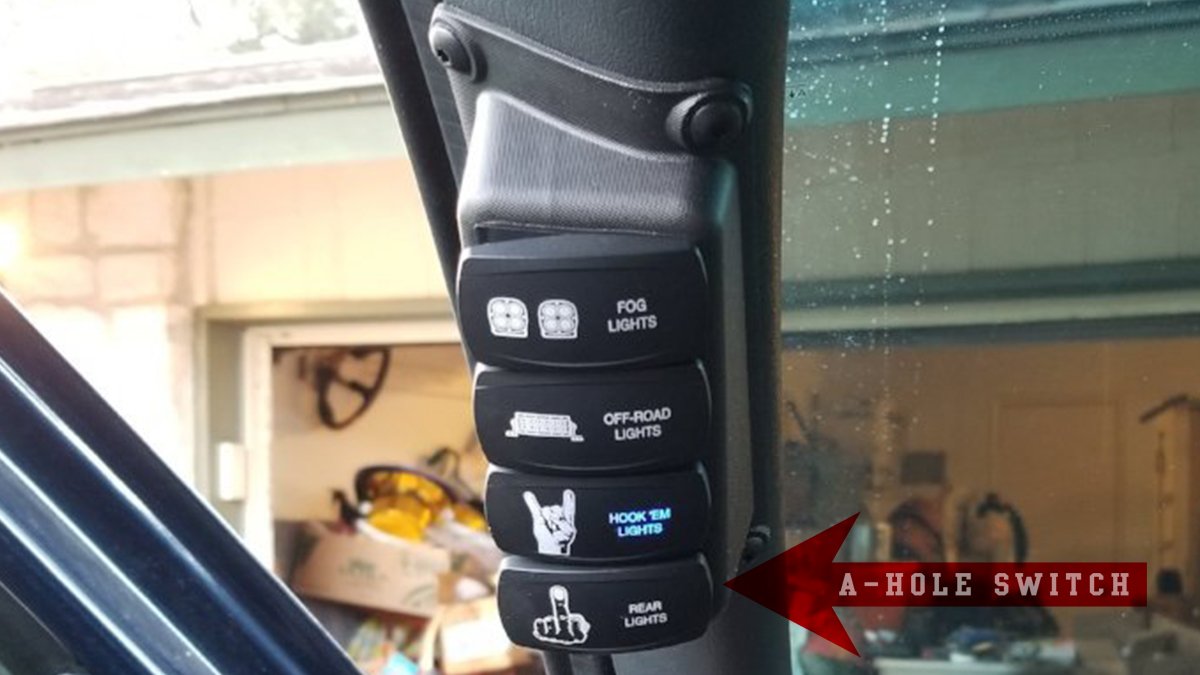

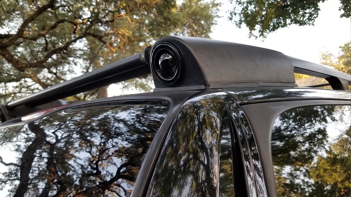

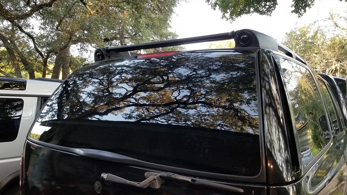

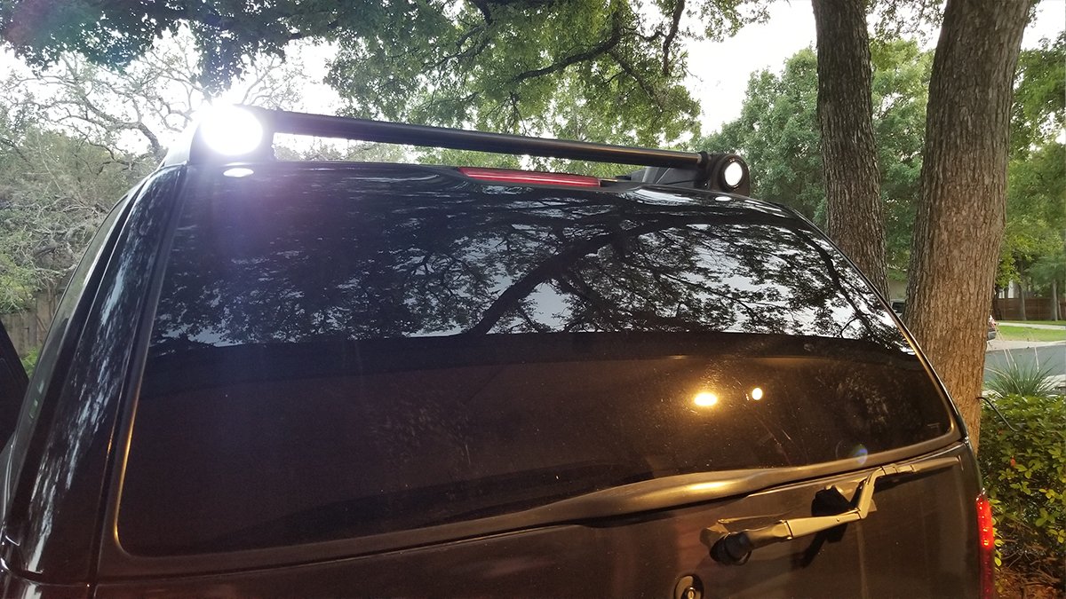

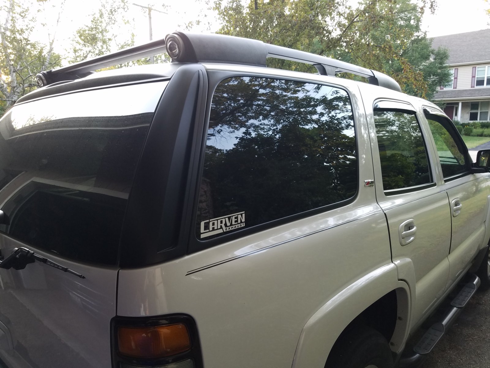

I finally got around to installing some LED reverse lights in the Z71 rack yesterday. I was used to having the LED cube lights in my old rear bumper, but when I installed the Avalanche bumper I decided not to cut it up just yet. I went with these cheap ones from Amazon because I didn't really like the look of any other ones I found that would fit the 3" opening. I had originally bought some super bright round LED spot lights that would've been perfect if they weren't just a little too big. The ones I installed aren't as bright as I would like, especially after I hit them with a few coats of Night Shades Tint, but they'll do for now. I used some plastic epoxy to mount them and ran the wires under the Esky Appliques to the taillights. I wired them up to come on when the truck is in reverse or when I hit the a-hole switch on the pillar. The a-hole switch is pretty cool too because not only do all the reverse lights, including the two mirror and taillight, but the reverse cam comes on too.

What ended up being the measurements for the holes? I've been wanting to do this myself and have been trying to find the right set of lights for it.

It's exactly 3". But then there's a mount for the lights GM was originally going to put in there from the factory (and wussed out) that you have to account for. I had to cut mine off with a Dremel for the lights to fit.

Any special wiring you used to wire them both up to reverse and a switch? I’ve been pondering flush cubes in my rear bumper and wanted them to function like yours.

Nothing too fancy. The switches that I bought for the pillar mounted switch housing came with relayed harnesses. So I just took the powered wire from the "A-Hole" switch relay and tapped into the lime green reverse wire that is behind the driver's kick panel. That make sense?

Makes sense to me. I was planning on doing something similar if I ever got around to it. If I remember correctly I thought I read somewhere on here that method wouldn’t work in theory but was never tested to see if it did. Glad it worked out for you!

Yeah I think I might've read that too and thought it sounded like BS, so I gave it a go. Worked like a charm.
