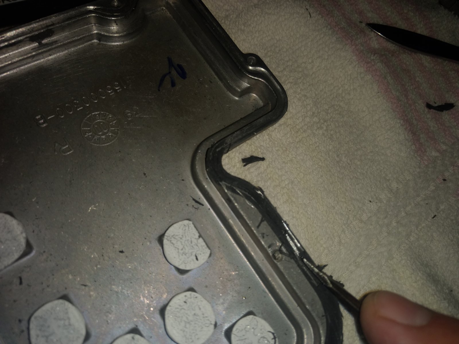

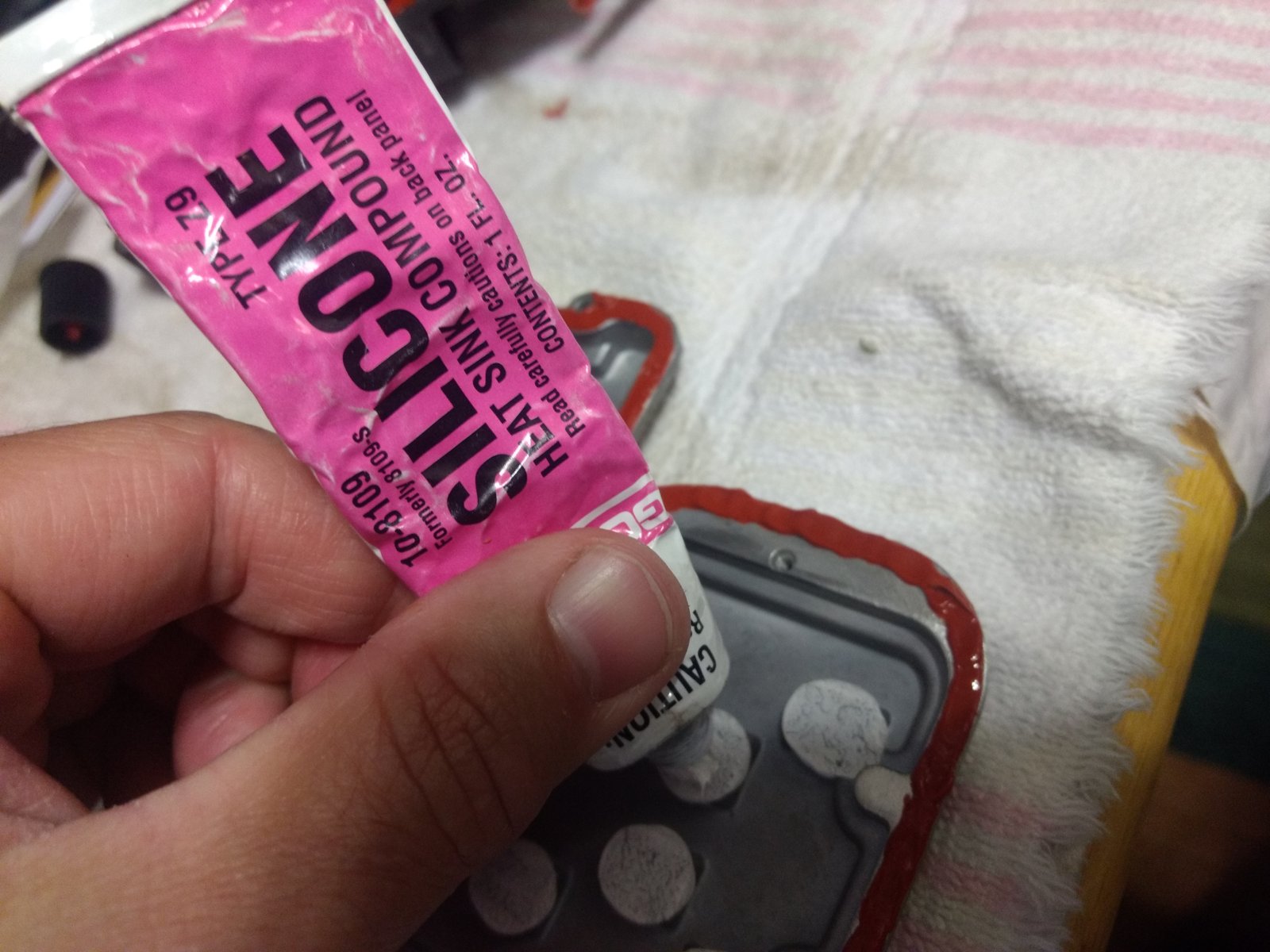

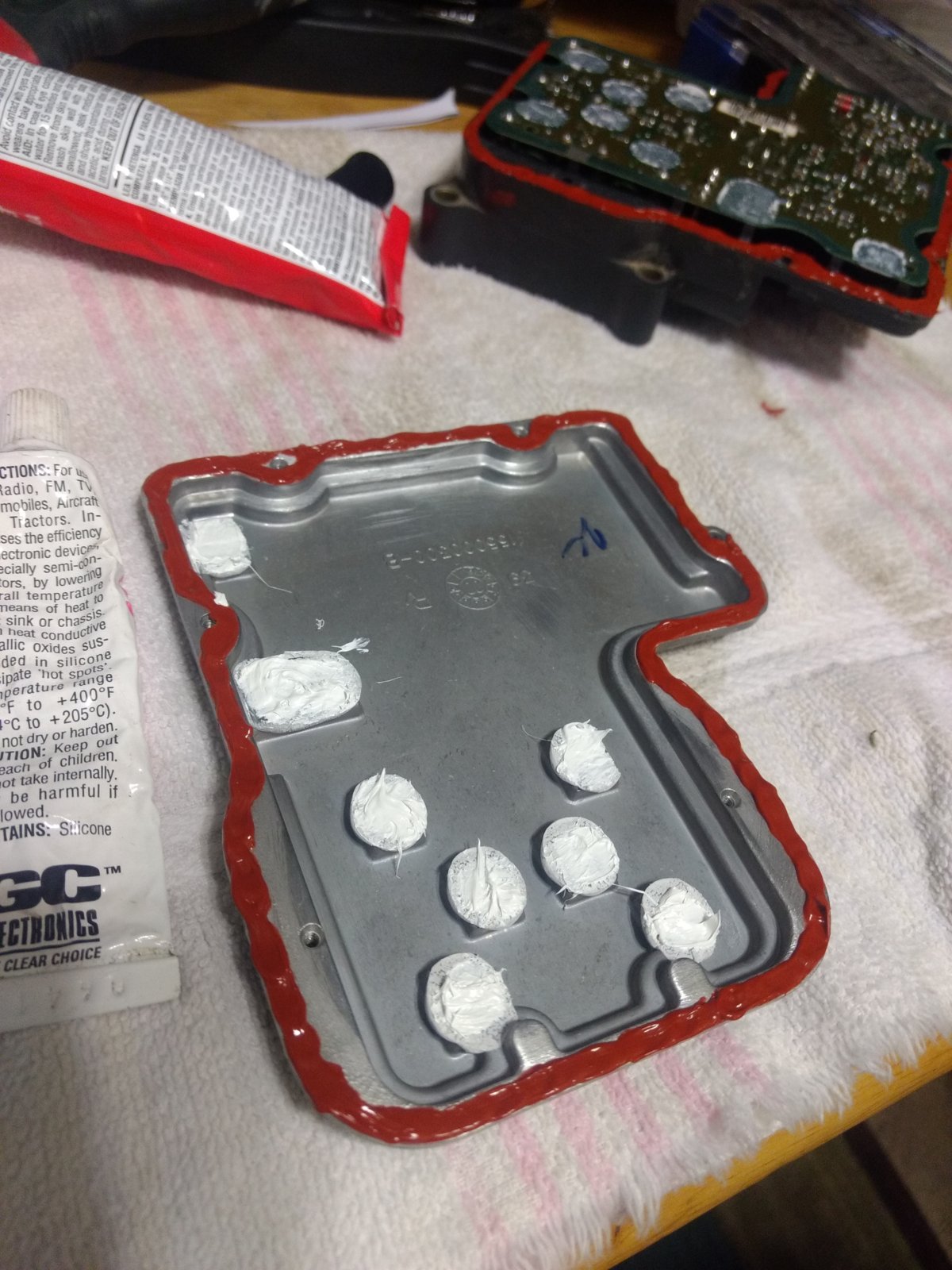

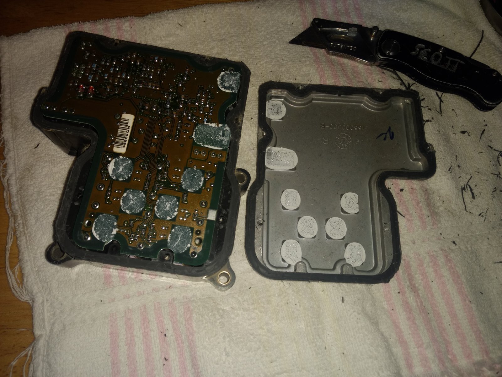

Finally got time to finish rebuilding my ABS module. I re-soldered all the solder joints and put new heat transfer paste, then scrape all the old silicone glue off and then glued it back together with red RTV silicone. The tricky part is cutting this sucker open! View attachment 204221 View attachment 204222 View attachment 204223 View attachment 204224 View attachment 204225

Good to know. Been wondering how to fix that. Was going to start with the sensors, but now that I know this, I'll start here first.

Exactly. I scanned my truck and the ABS code that I pulled said "Electronic Brake Control Module circuit fault". That means that either there's a faulty EBCM, or a fault in the wiring. But I have read that most of the time it is a bad module and the only reason the module is bad is because of failed/broken solder joints. Now on my son's Silverado, he had the EBCM fault, but he also had two codes for the driver's side and pass side front wheel speed sensors. Both his hubs were bad, so that's sorta makes sense. After replacing his wheel hubs, I re-soldered all the solder joints in his EBCM and his ABS light has been off ever since. So now I just did mine since I was getting that code as well.
Back Story: I have actually been getting this same ABS code for almost three years now. The light would come one maybe twice a year, so I didn't worry about it. But last few months it's been coming on more and more often so I decided to actually fix it.

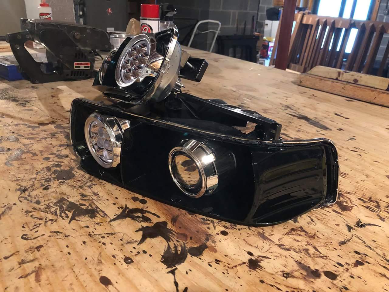

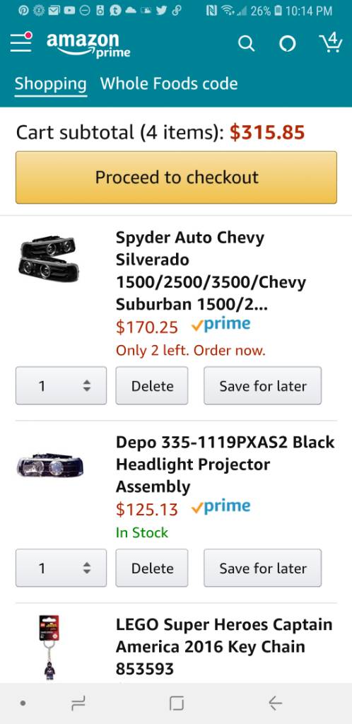

So I'm debating between these two headlight assemblies anyone had a good or bad experience with either brand?

Ok so what exactly is a retrofit. I've seen it on here before but does anyone sell it already done I have twin 3 year old girls one with a heart condition. We had her 2nd open heart surgery last Halloween so I don't have a ton of time for projects. What kinda time frame does a retrofit take?
Depo is great, at least until you're ready for a legit retrofit

A retrofit is when you take a projector that is designed for HIDs and install them into a housing that doesn't come with them.
Theres a write up somewhere Round here where a guy retrofitted a set of depots and came out great.
If you dont have the time to do it you can send them out to places to have them done.
