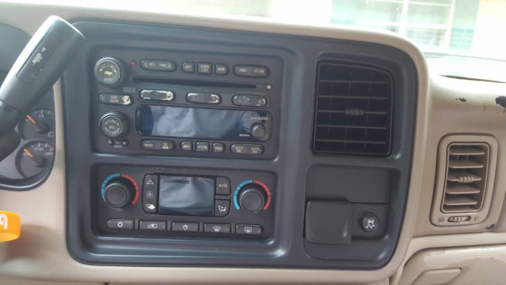

Put my new plugs and wires in yesterday. Added and aux port to the factory radio today. The plug is from a 17 cruze. Usb wasn't working so I kept this one to try. It's not 100% mounted but fits really snug. It's wired into the black c2 connector on the back of the radio. 3 wires, drk grn/wht, brn/white, blk/wht. Their are 2 but I have the connector diagram printed out from work.
Sent from my SM-G928V using Tapatalk
Details on the dash insert /housing piece, please.
From a 17 cruze. The usb port wasn't working so I replaced it with a new housing as it comes assembled already

Curious, @dszx13... where did you tap for the aux input and how do you switch the radio input to that (XM?).
Also, does the USB port work and, if so, for charging only? What powers that?
Usb isn't working. Was the reason it was replaced on the cruze. The first post with pics explains where and what was tapped into

Yeah. Wasn't sure if the connections you mentioned were for the USB port or the audio. Which wire is which channel?
How do you switch to the audio on the radio?
It's for the aux port. Turn the radio to Sirius channel 0 which shows radio id.
