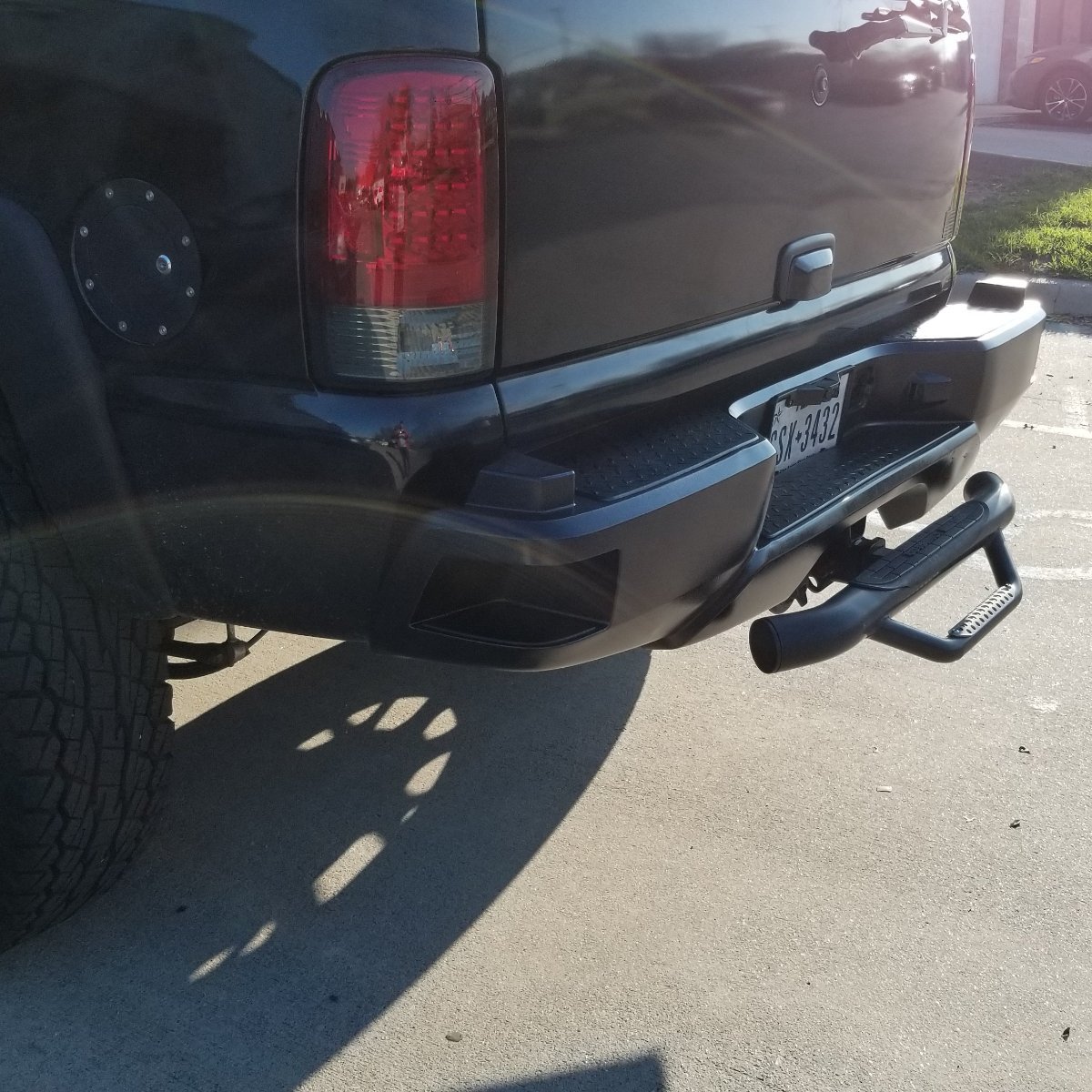

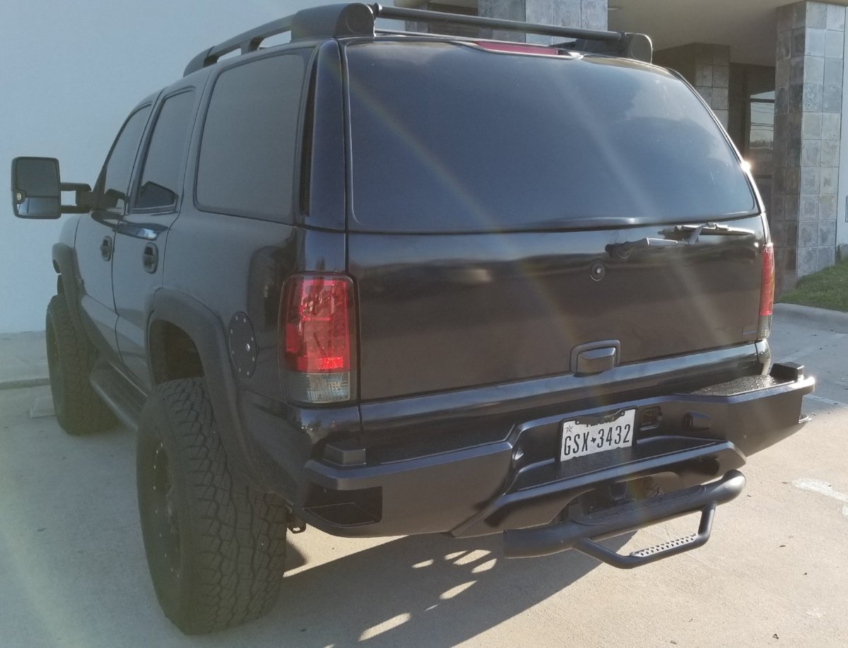

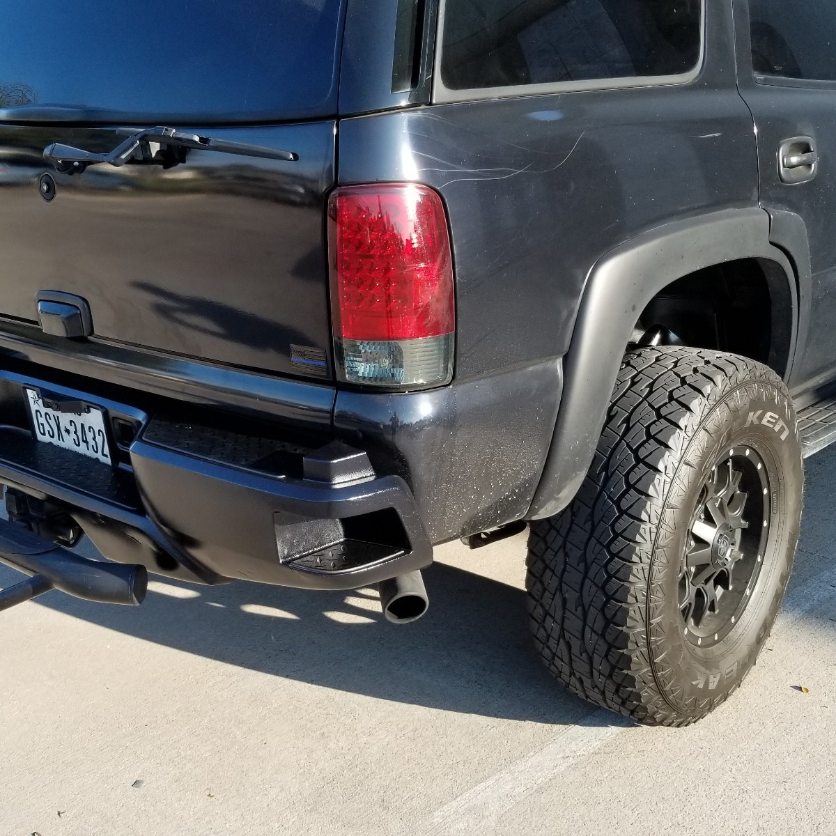

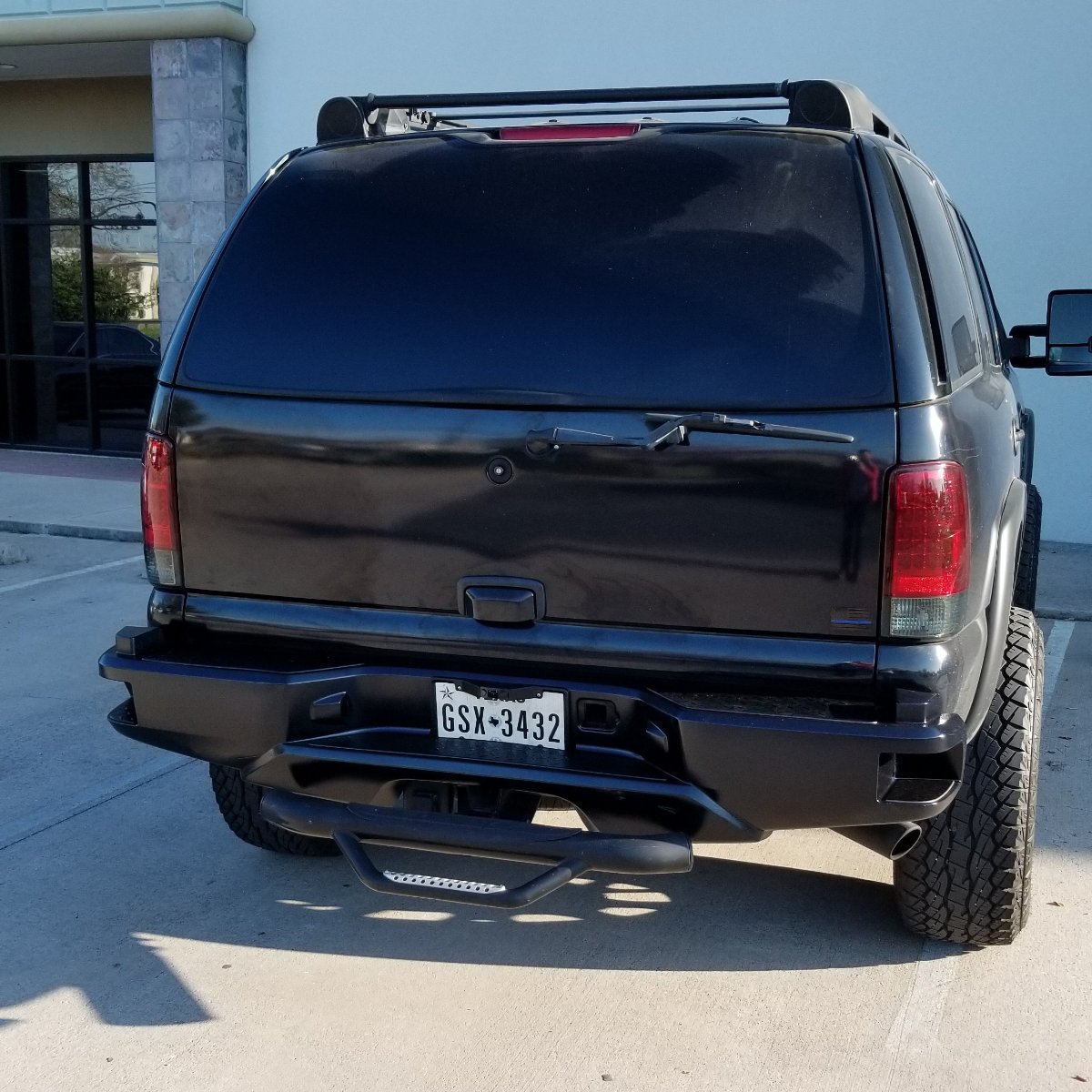

I saw a member on here a while back on IG that put an 02 Avalanche rear bumper on his ride and I thought it looked pretty cool...so I finally found one that was in pretty decent condition, painted it and mounted it last night. Definitely changed the look and not bad for $100 and some paint. I might put some LED reverse lights in it one of these days too.
A bit of a more aggressive look. I definitely can dig it, Awesome brother!
Edit: love it, no homo

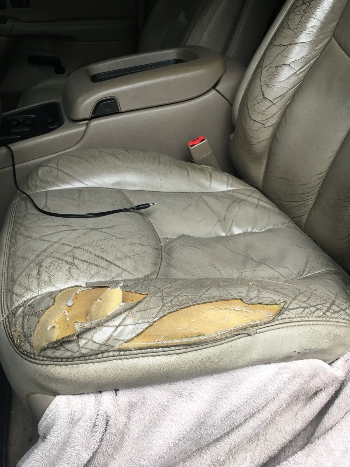

Damn, that's impressive af! I can barely sew a button on. Interior is lookin good! And I might have missed the post or forgot, but did you do black carpet too? I think that's coming up on my list soon.
Yeah installed the black carpet a couple weeks back. Didn’t post anything because there were no seats and all side panels are still out of it.

M1Gunner's got sewing skills bro ! ,... wish I had the skills and patience for that,.. the 'new leather' smell might be nice but youll still have ripped seats ! LOL

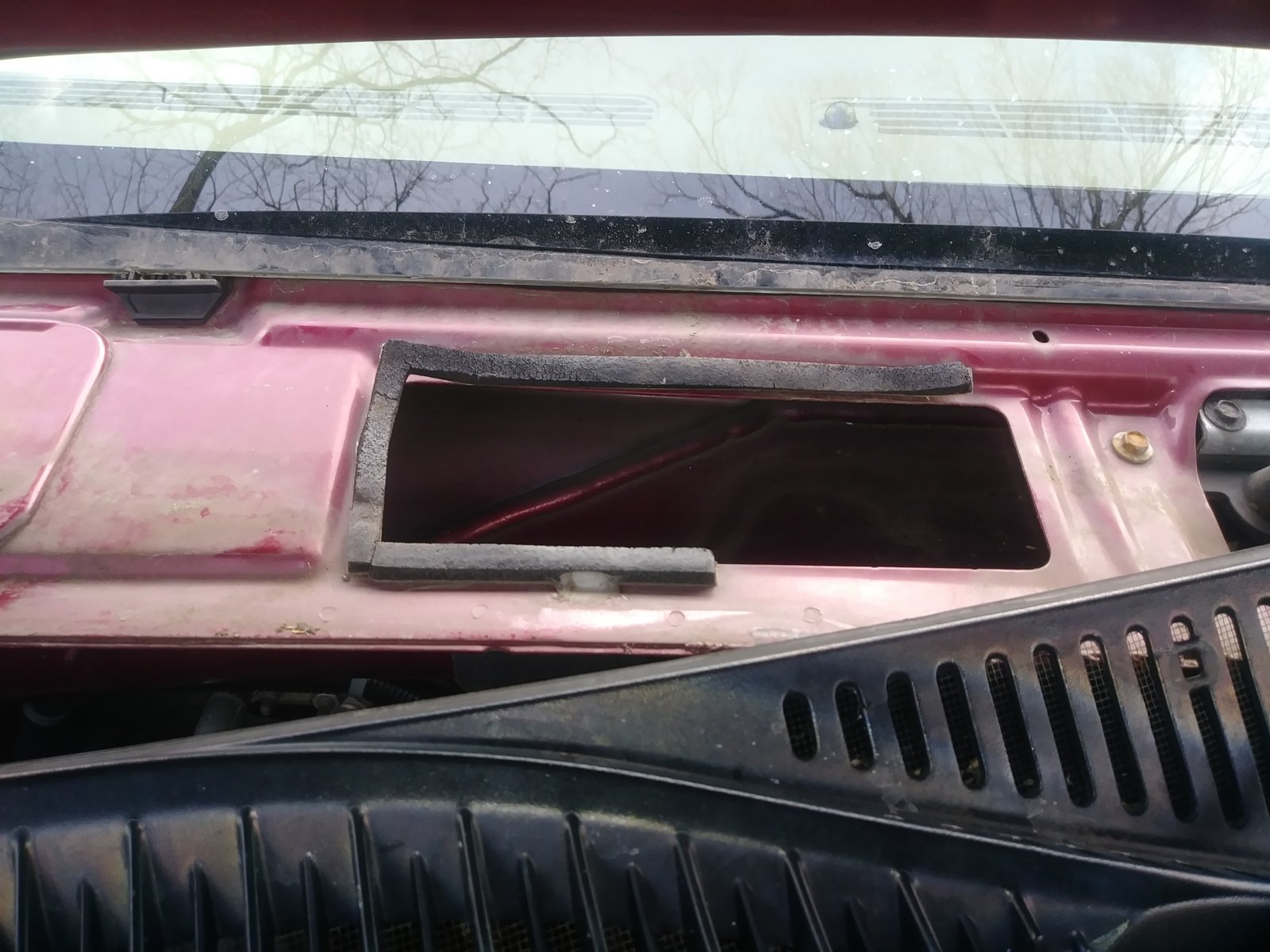

floor got wet again, this time its wetter by the console only damp by the door, up the fire wall bone dry. im really kinda lost on this one.
so i pulled my cowl off to see if that cover was open looking. it looked tight but i gave it a bead and smear of rtv, the foam was pulled off some on the top and left corner of the open hole in the middle, so i rtv'ed that back in place.
thats all the foam that was there, not sure if its missing or not, but it really dont look like anything was ever there.

That’s how it was from the factory I replaced mine with some new weatherstripping forget what size I used got it from Home Depot

I had the same issue on another vehicle. Same fix. Generic self adhesive rubber weatherstripping from homeless despot

you both had wet pass side floor? my fire wall seems to be dry. no water leaking out the air box or behind it.

I never had that issue on that side had it on the driver side it was a bad door weatherstripping, I was replacing the wiper linkage and noticed that weatherstripping under the cowl was loose so replaced it

Im talking about a different vehicle so may not be applicable but i have run into a similar problem where floorboards are wet but firewall is dry.
One other time on my jeep my heater core hose connection leaked and i had wet pass floor and dry firewall. That might be worth a look too.
