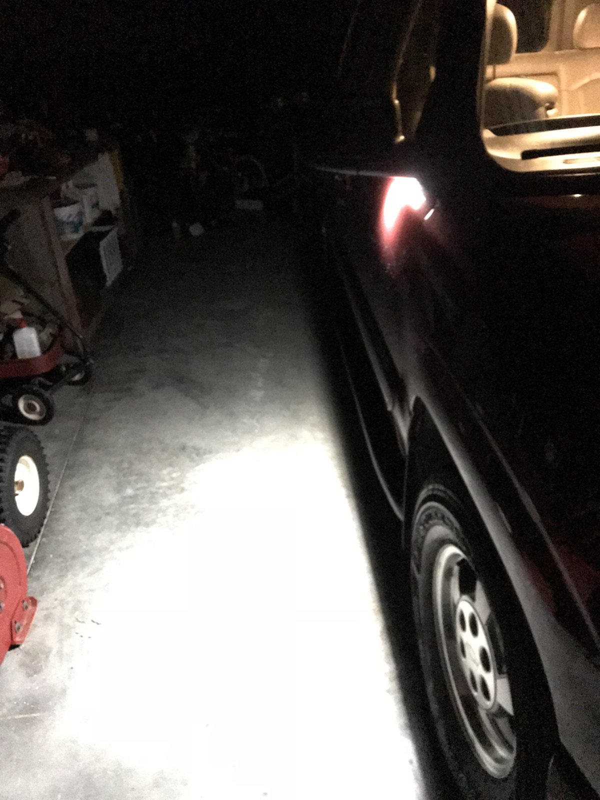

Got some pics of the LED puddle light upgrades. For some reason, the passenger side has the Festoon bulb holder, which I put a 6 LED in, and the driver side has a 195 socket in the side, so I put a 5 LED flat plug that I had on hand. Why would it be this way?? I'm going to make a junkyard run and get another festoon housing. Here are the pics for comparison.

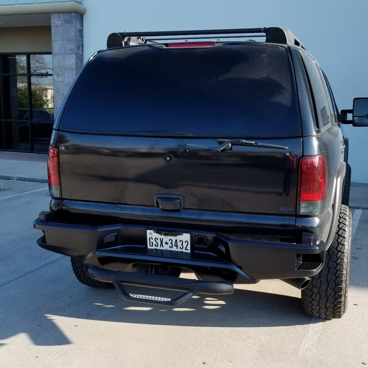

I saw a member on here a while back on IG that put an 02 Avalanche rear bumper on his ride and I thought it looked pretty cool...so I finally found one that was in pretty decent condition, painted it and mounted it last night. Definitely changed the look and not bad for $100 and some paint. I might put some LED reverse lights in it one of these days too.
