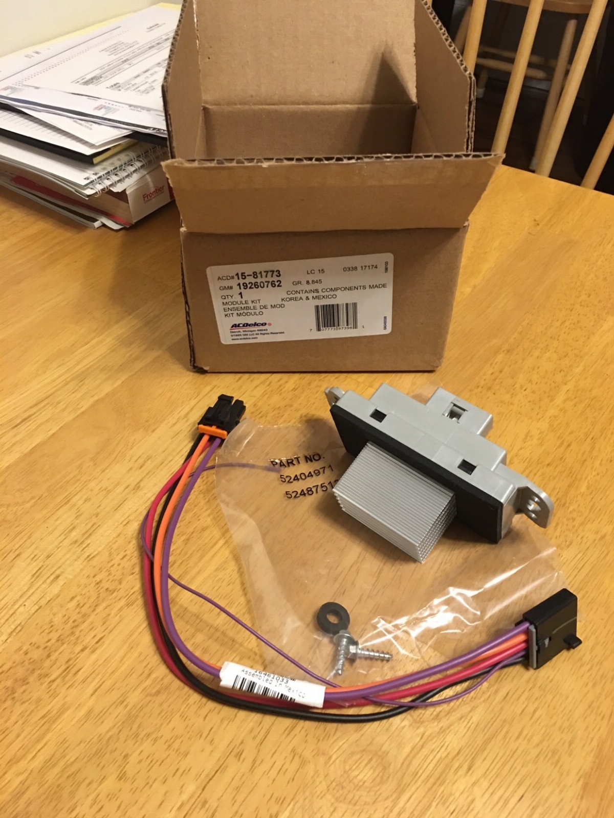

Got the new AC Delco blower motor resistor today figured I'd replace it since I found out when I did the blower motor it was still the original style resistor and with 162k who knows how much longer it has

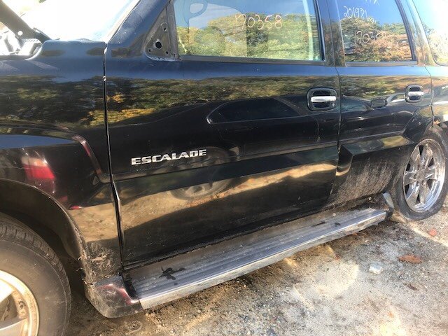

A few months back the driver side door cladding was loose so figured I'd pull it and apply new 3M tape and reattach it but found a pretty nasty dent behind the cladding which explains a few issues I was having with the door so took it to a bodyshop and it's easier to just replace the door so came across this door off an 05 for cheap and picked it up should have it on in the next week or so
Love those wheels.
Crazy on the hidden body damage. Almost a good thing the previous owner or mechanic half ass put the cladding on so you had to take it off and find that dent:(

Might look into scooping up the rims, definitely grabbing the front bumper if it's there in 2wks, I'd really like to know wth happened cause other then this the trucks clean, the running boards mint so idk how the hell they even did it honestly I'll post a pic of the door up
Yea we have a few trucks here at my local yard i wonder the same thing. Clean all the way around but made it to the yard somehow.
Any other good parts on it? Interior? Exterior? Someone might want on here ?
I might have said some of that wrong was talking about the dent on my door in terms of how it happened etc. it seems like they just got it in, it's an 05, they will ship and take PayPal so someone might find something they need, either something mechanical went or the other side is trashed because the list both the front and rear bumpers, seems to be pretty complete, not a huge demand for some reason the yard I got my rear bumper from the truck was there since April and was pretty much complete and there prices were good too

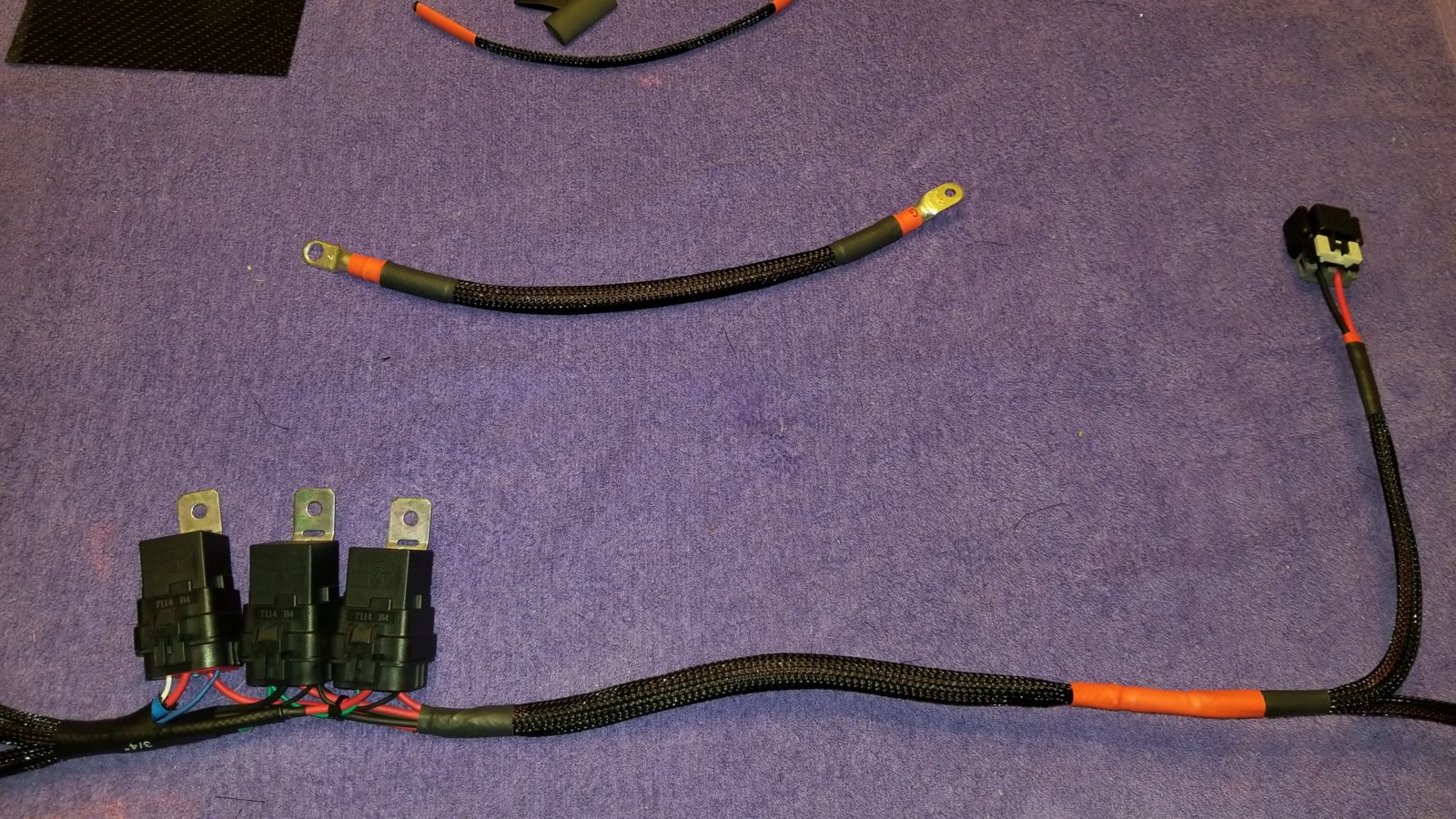

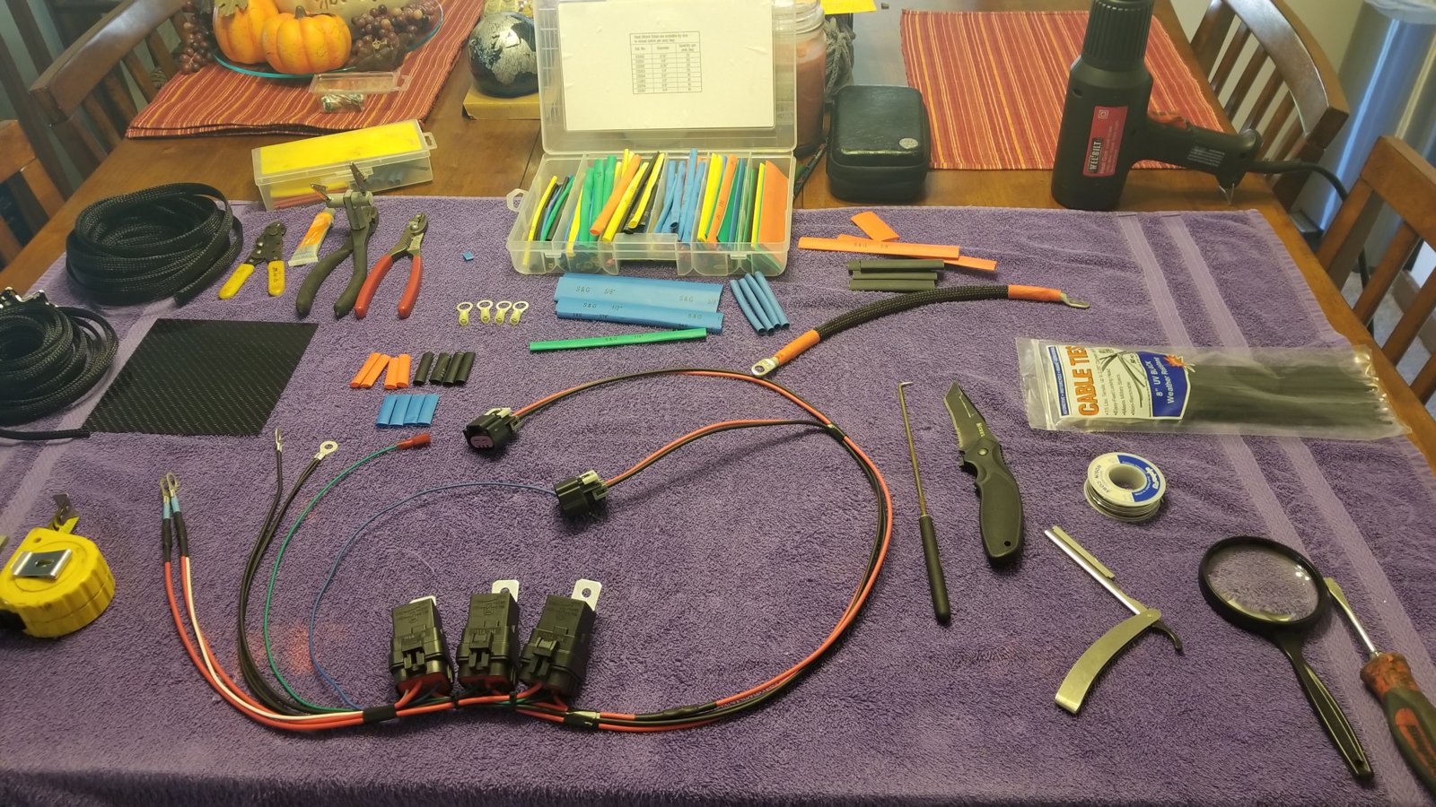

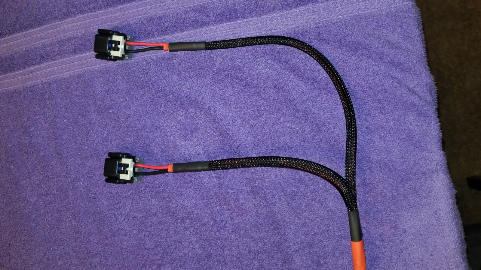

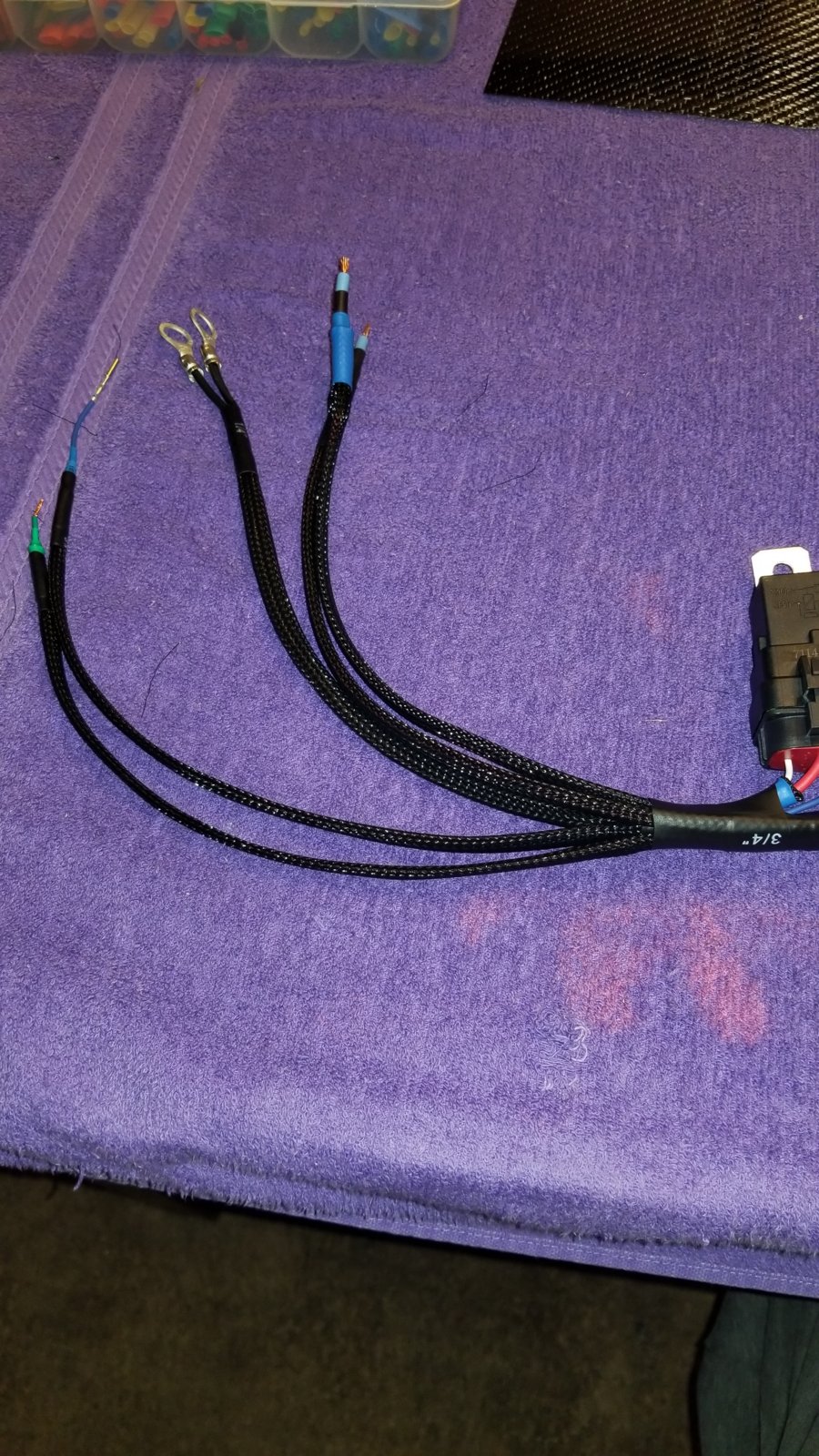

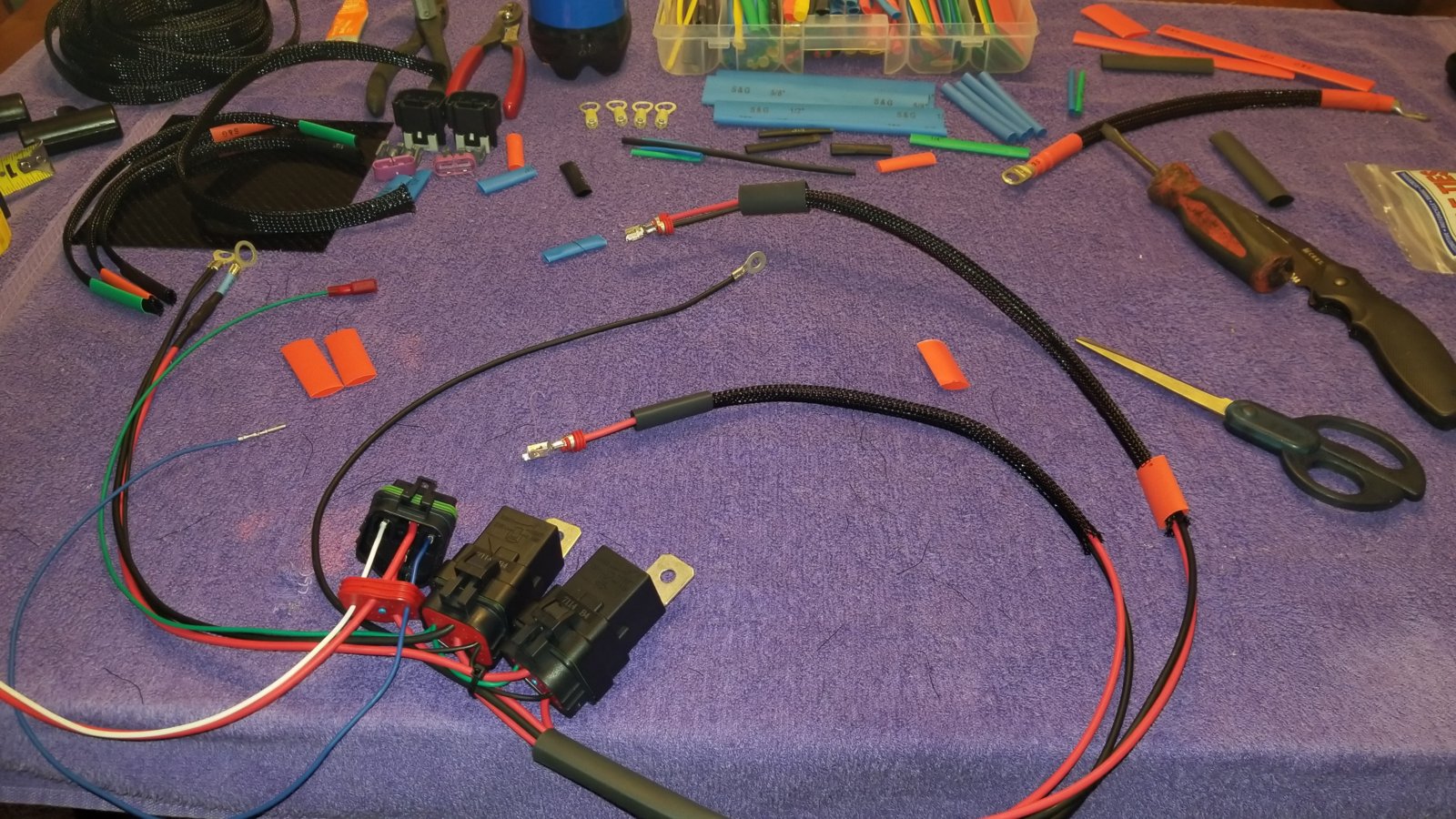

I really dislike split loom. So I rewrapped my Nelson fan harness with braided and made a 4 ga alternator cable. Here are a few before and afters.
View attachment 184857 View attachment 184858 View attachment 184859 View attachment 184860 View attachment 184861 View attachment 184862
Im just asking, didn’t everyone say those heat up and fry the relays or did i read it wrong?
I had a problem burning up relays. I upgraded the harness to 80a relays with the bigger tabs. They handle the load better. I really had to watch watch my temp gauge when running my ac in the summer. I would blow the high ac fan relay and it would stop my fans from cooling from temp unless I turned off the ac. After upgrading to higher amp better quality relays everything is stable and able to handle the load.

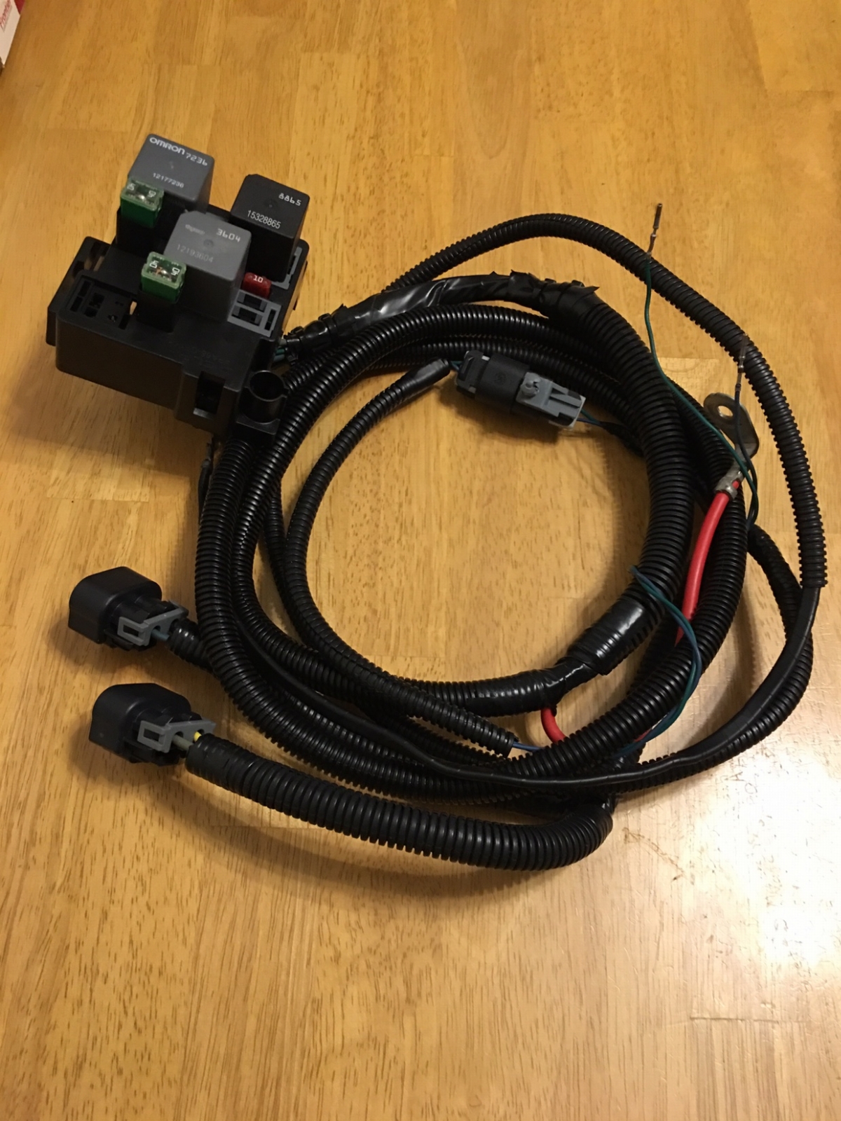

Any pics of the factory harness and the diodes?. Are they just on the fuseblock? That's the only real difference I can think of and maybe better relays but they are not rated anywhere near 80a..

This is the OEM harness

Well it's obvious now what's wrong with the aftermarket harnesses. That gauge wiring is a whole lot bigger for the power wire and from the fans. I'm sure the smaller wire is building up resistance which leads to heat..ugh..where did u get that harness? It looks new.
