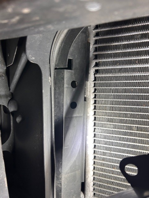

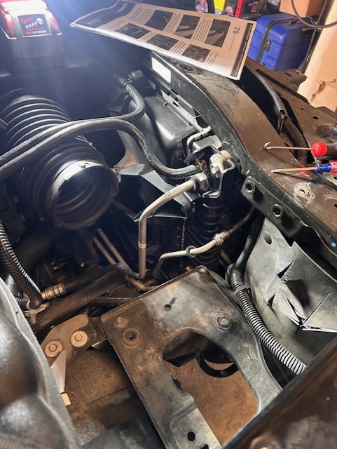

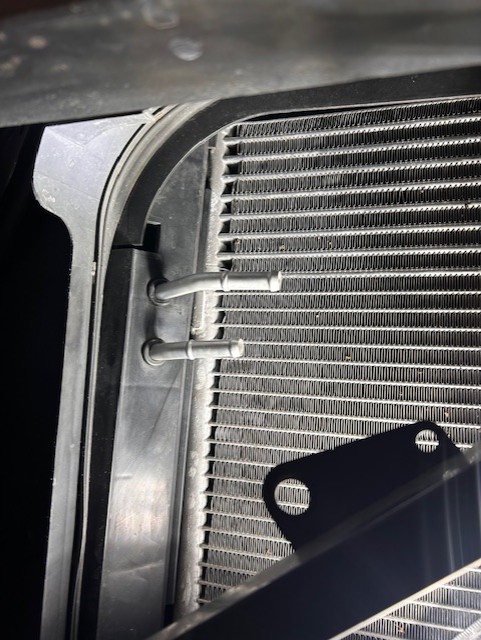

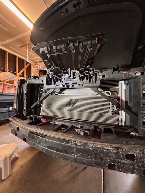

Do you have a part number for this? I keep seeing that they advertise for the 1500 but not a tahoe specifically.
MMTC-K2-14 Mishimoto website will state it fits Chevy Silverado 1500 but it how it is installed is basically the same. The transmission hoses it comes with fit perfectly.

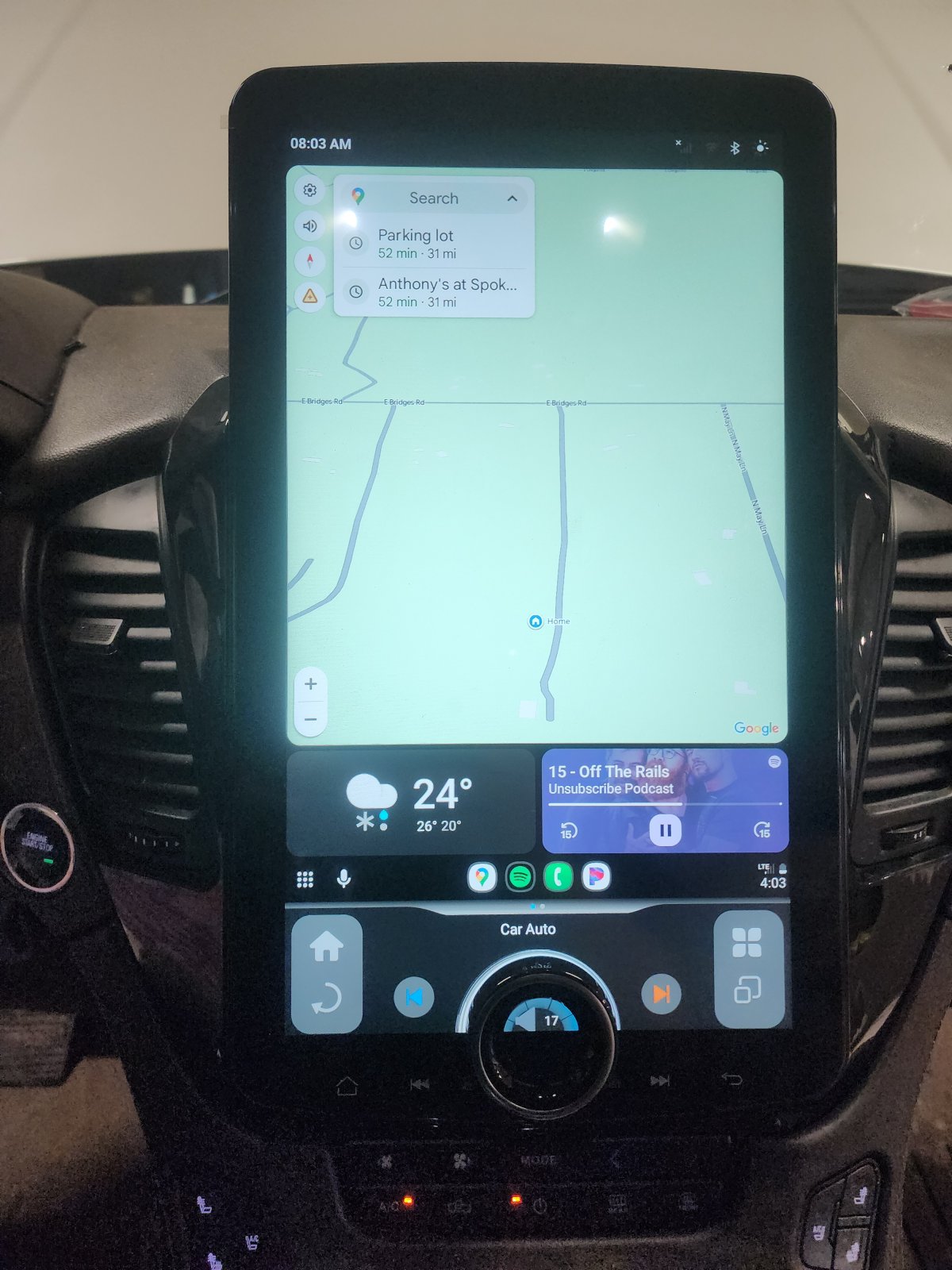

That radio screen is huge! I really like how you still have a knob/dial as well!
Yeah, that was one of the selling points for me. I like having the knob. and that knob works for both fan/temp and volume. Drove the burb to work today rather then the truck just so i can play with it some more

Very distracting to me.
I guess i'm at that perfect age where i can afford big screens and not find them distracting. i mainly have it sitting on android auto with the maps. It's nice having a big screen for the map so you can see decently far out without having to zoom out. if i had it just on the home screen 24/7, yeah, it would be annoying. but being that is 90% map, its more useful then distracting

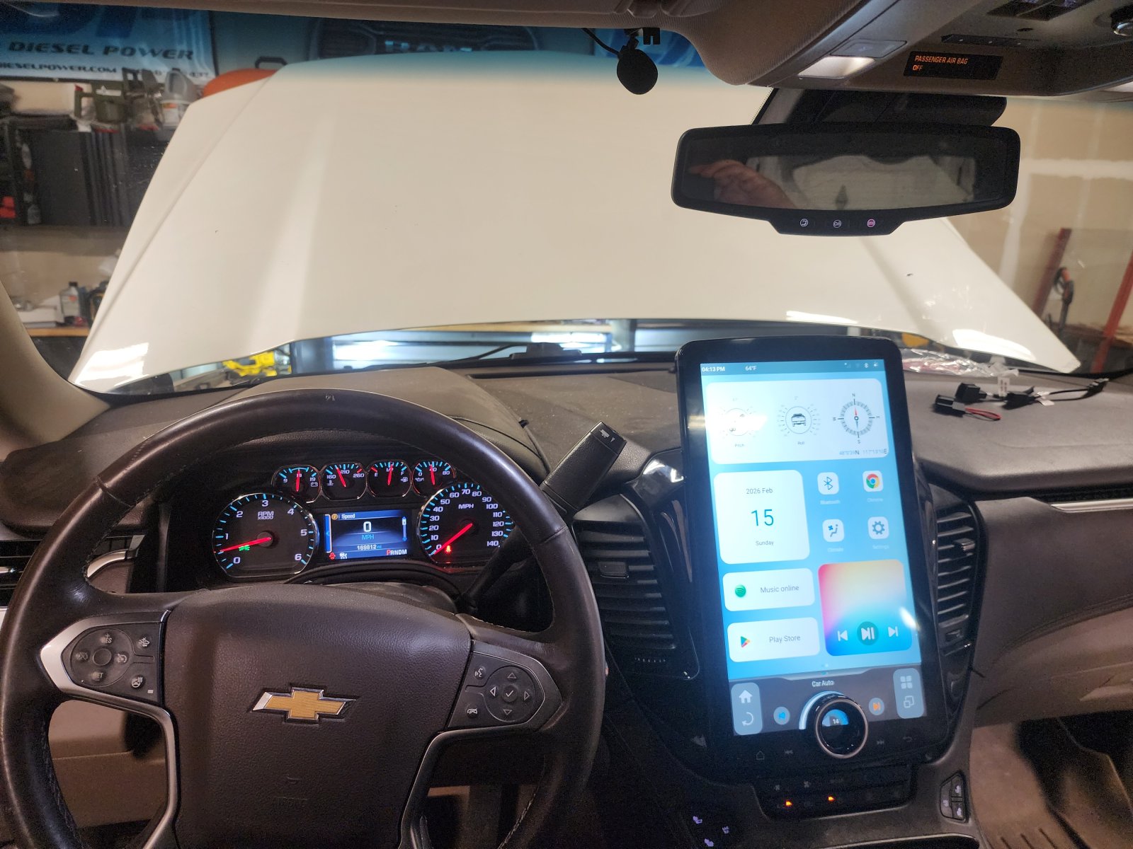

I've never seen that particular brand before, what did you go with? Any affect on audio quality? Any issues interfacing with the oem electronics?
So far its working at 90%. I need to pull it back out and double check some connections. I'm not sure if the canbus module is working right, but basically i'm not getting any HVAC controls on the screen to work, but it reads everything just fine. The hard buttons on the bottom work perfectly though, so i still have hvac controls, it's just not as fully functional as it should be. The other issue i'm having is the backup camera isn't working, but that could be a bad connection on my end. I connected it and pulled and moved the radio several times without rechecking that. So, i'll be pulling it and rechecking things this weekend. Linkswell has the best reputation of the tesla style screens. And i really liked the X-knob as they call it. Works for audio, power, temp and fan settings. Really easy to switch it over to HVAC controls as well. Buuuuutttt all of the tesla style screens are all made in china. Most of the other brands tend to have a lot of issues, so time will tell. If these hiccups can get solved pretty easily i'll be in love with it. Wireless Android auto connects super fast, no audio issues, using the factory bose system. They have an adapter box for that that woks flawlessly. Linkswell also claims all their odds and ends are inhouse rather then outsourced. I think the canbox is the issue, either a bent pin or bad box. I can get some signals, no issues with reading, but writing back up can is the issue from what i can tell. So we will see what happens At this point i would say stay tuned before spending any money

I suspect my "radio" is junk so I've been thinking about something like this. That's way too much screen for me but good to know it can be done. We have a top notch car stereo shop in town and the guy can do just about anything. Interesting!
Car steroe's are easy. Nothing really that complicated about them. I'm not an audiophile, but i am also very mechanically savvy so that probably helps. if you aren't, Crutchfield is your friend. if you are, Crutchfield is a rough guide to lay you out down a path of searching for better prices. Even with this radio being the most in depth one i've done, it's mostly GM's fault. i think Linkswell could've simplified their wiring harness, but i also understand that the back side of their radio is universal, and the wiring harnesses are what they do that is vehicle specific, so doing it that way will almost always require a rats nest of wires to adapt everything correctly

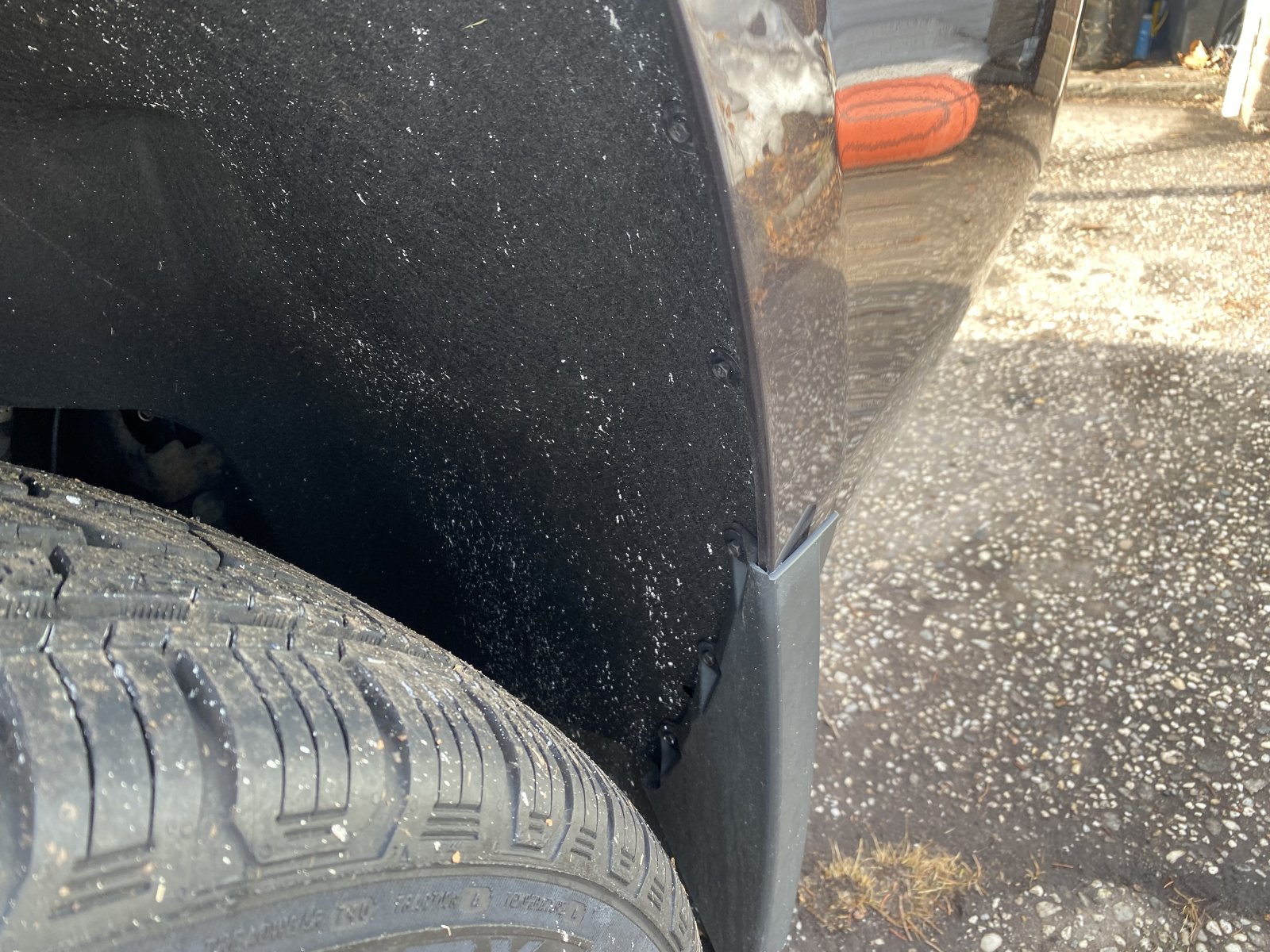

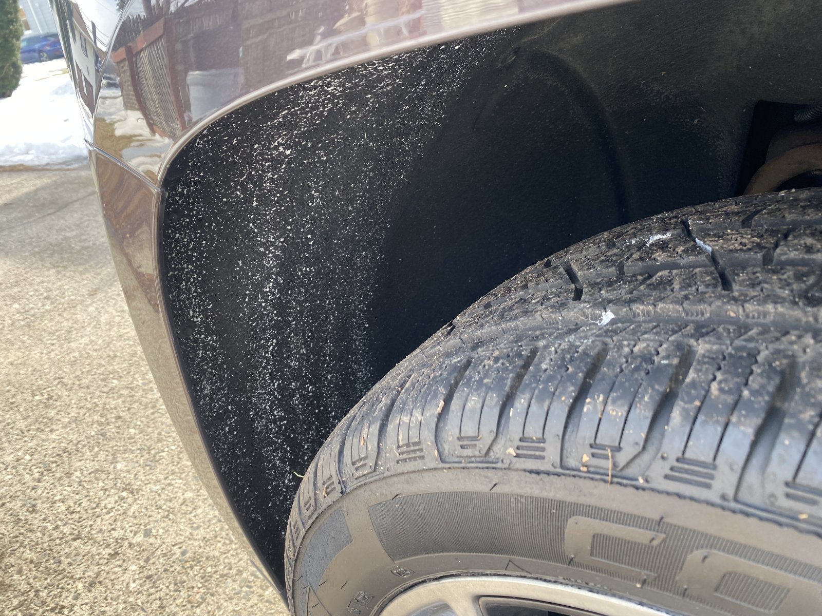

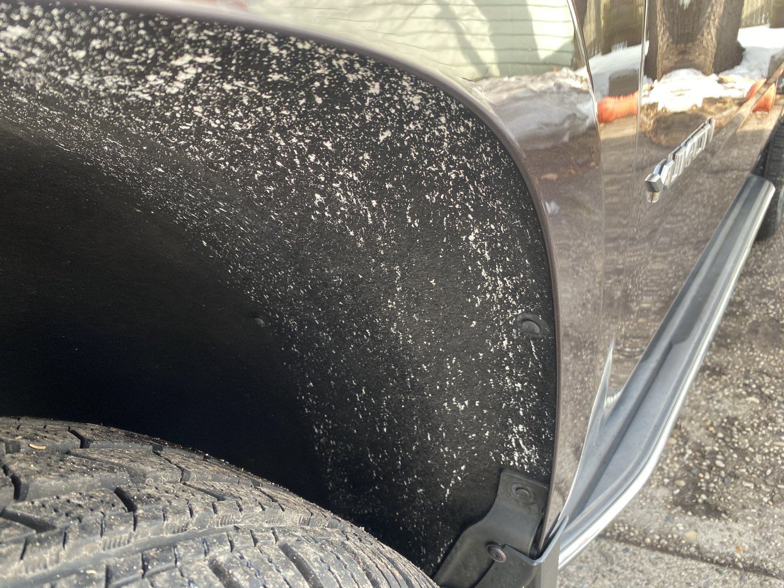

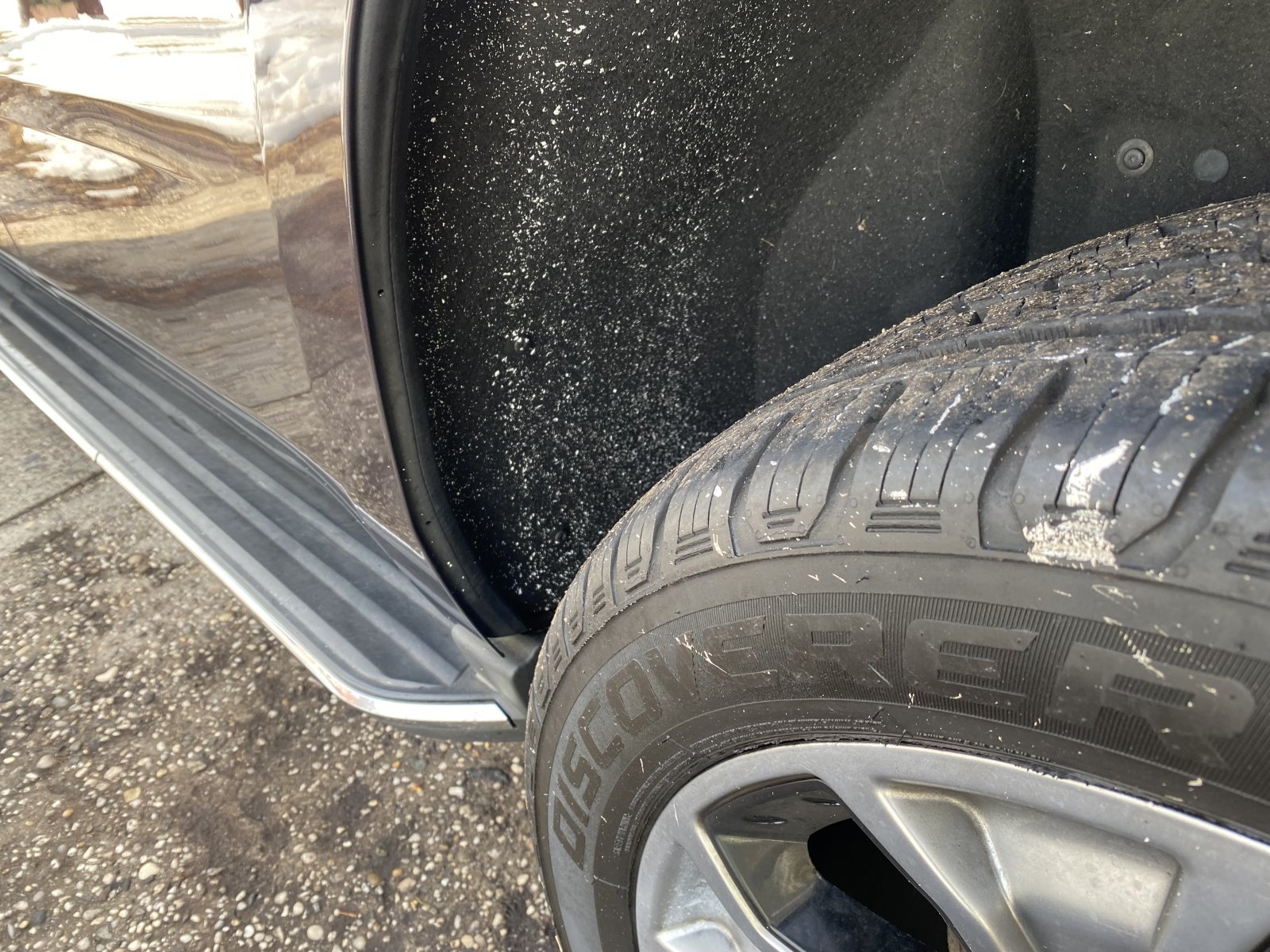

Unavoidably drove thru some spilled paint on the highway today. Slowed down as safely as I could and minimized the damage. Lightweight home power washer and elbow grease got most of it off the body, I’ll use my buffer on the rest, but not sure what I can do about the fender liners.

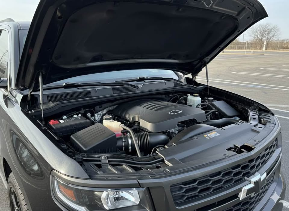

I have never seen this engine cover. Anyone got any info on it?
I know you can get an escalade engine cover, Pn 12669503 with 2 studs 11611691 and then a hubcap for the bowtie after removing the esky cover. but that cover looks different. Whats the PN on it? i wonder if its from a newer generation?
do like 90% of detailers do and just spray the liners black, use cardboard to protect the wheels

I would guess that is either some form of 2500/3500 or diesel engine, the battery is sideways, coolant tank is sideways, the intake is different and it has a different cooling fan for starters,,,,
otherwise a similar cover is 12669503 (for escalade) that can be modified as needed.
