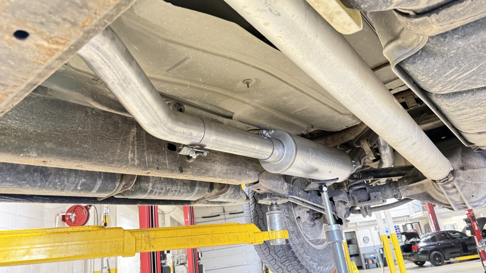

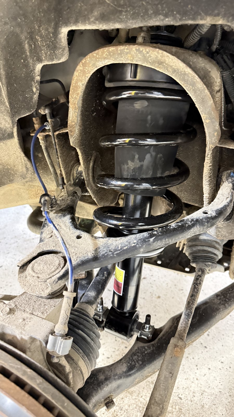

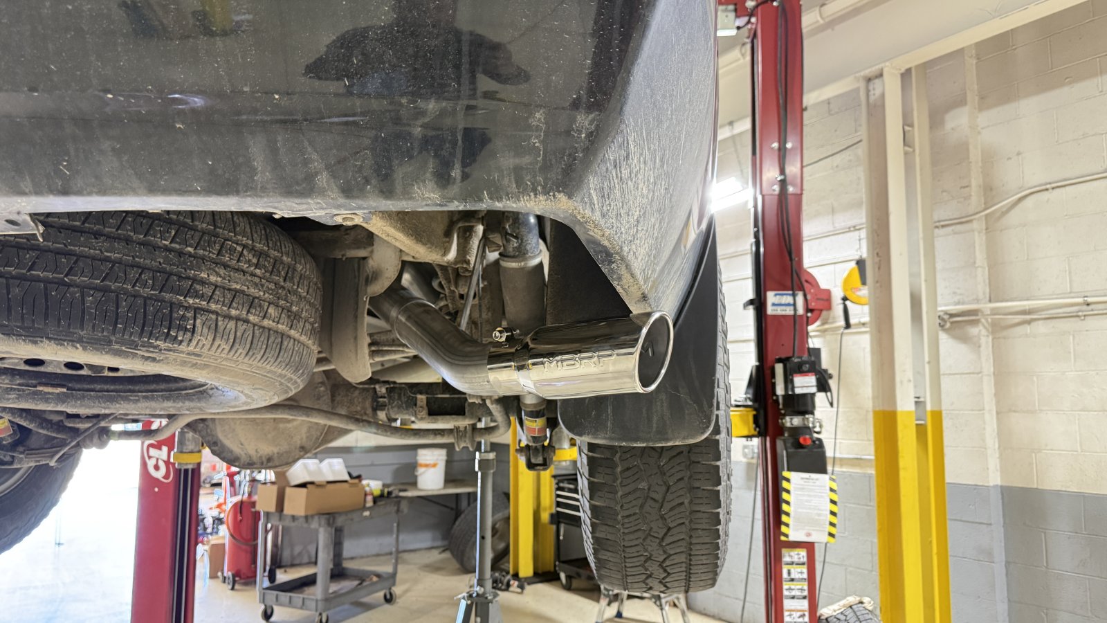

MBRP exhaust and new front struts installed today. Took me 2h at a rent a hoist place. Not bad. The exhaust is nice a bit loud but I like it. The suspension is now all refreshed.

any drone? typically if there is it will be under a load at 70-80mph
No at highway speeds I am at around 1700rpm at 70mph and I have not heard it actually quiets down quite a bit. And once you get over 2000rpm it kinda wakes up and becomes throaty. Its a bit louder than I want it but there is always an option to upgrade the muffler for a different or longer one to quiet down even more but I absolutely love how agressive it sounds.
