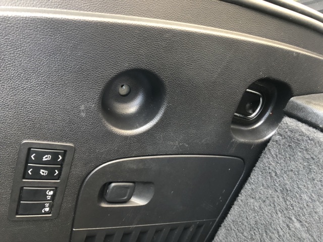

What’s this threaded insert for in hatch?

Noticed these. Am I missing something? One on each side.

Based on your photo it looks like someone took the hooks for the cargo net with them. Usually there is just a dimple there to start the hole. The hook looks like a "T" shaped hook that threads in there and it comes with the cargo net, as Doug said.
I'm not endorsing Amazon or the seller just providing a link that shows the net and the hooks: https://www.amazon.com/Genuine-Tahoe-Suburban-Cargo-23132561/dp/B00LK32TQ4

Thanks all I’ll get the part to fix it. Maybe the net too see if the wife wants it.

GM#11547936 RETAINER, CONVENIENCE NET (CARGO NET,M6X1X20 THD,ABS T-ANCHOR,W/WASHER,BLACK)
