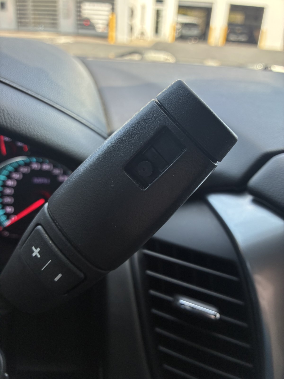

I acquired a 2019 Tahoe and I noticed that a button or insert is missing on the transmission shifter stalk. I think this is supposed to be an insert with a trailer on it. Is this repairable? Can I obtain the button/insert? Is there a GM part number?

It depends on how/why it is missing. If there were tabs on the arm that got damaged or broken off, then you'll need to replace the arm. If there were tabs on the button that got damaged or broken off, then you 'might' be able to repair it by obtaining an arm at a salvage yard and see if you can remove the button without destroying it.

that is just a cover, there is literally no function there, the actual button is on the outer end of the shifter arm, the other +/- button is down farther.
that being said you could could just go to the junkyard and experiment with a small knife or picktool to see if it can just be popped off or peeled off
replacing the whole arm is a option you will just have to remove the trim pieces around the ignition and steering shaft, take out the screw and feed the tow wire around to the bcm connection.
