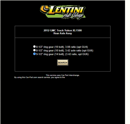

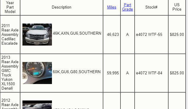

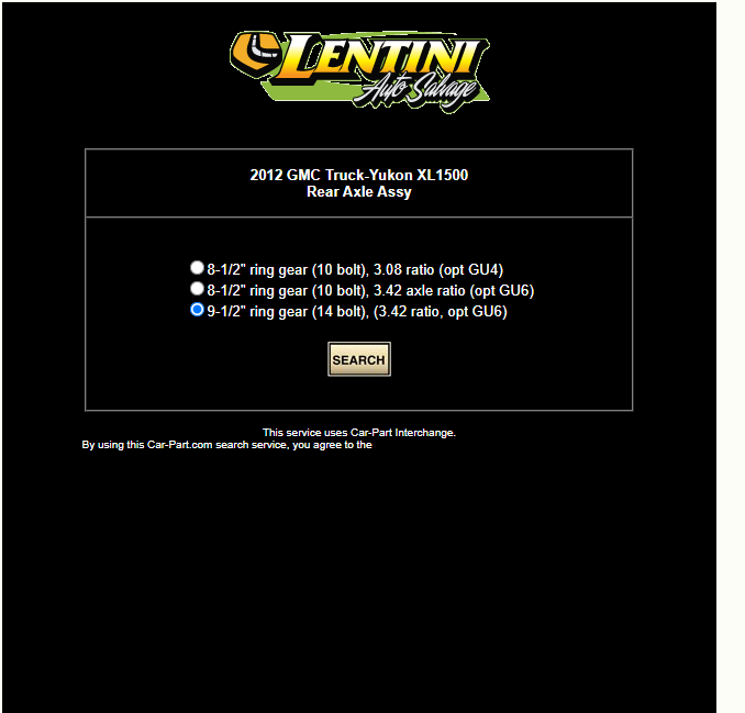

Per my search, they came on some escalades and yukon denalis? I just found one here locally for $825
L
ls1frc
Aug 10, 2019
923
1,352
Called place and verified it's 14 bolt, 3.42 and 9.5 ring gear. Comes as entire axle assembly. I'd much rather do this, can have truck back on road by Monday rather than fiddling around with something I've never done before.
