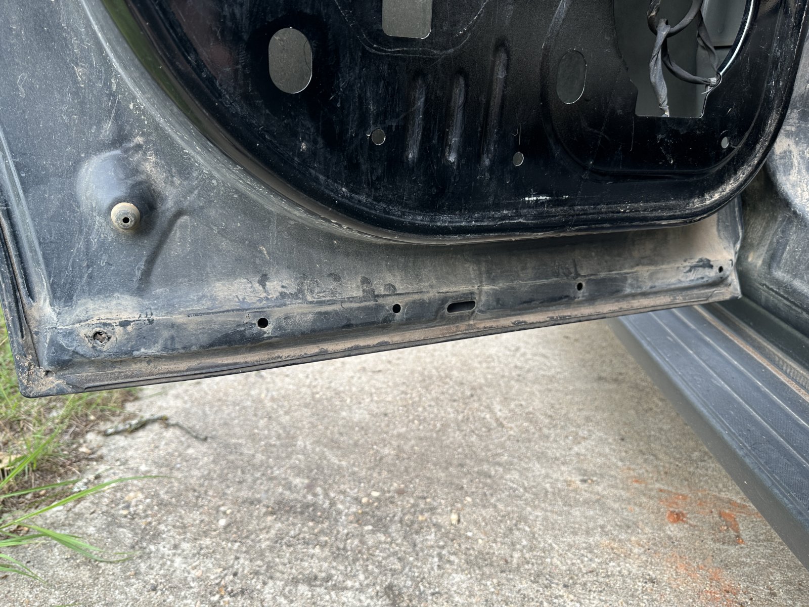

I heard This water sloshing around this morning, Been raining pretty good last few days. Heard it when I stopped at a stop sign today.
I read that the water is supposed to drain through the door panels but wouldn’t that cause rust inside the door panel?
In cases like this, use a soft wire, pipe cleaner, or something similar to gently clear out these holes. Be careful not to damage the door or drainage system. Washing them with a little water can also help remove any leftover debris.

Multiple cleanings wth a garden hose running down the window and a paperclip and pipecleaner still re-clogged very quickly for me. Finally took out center plug and so far so good. Holes really are too small!

I had the same on my 2014 PPV. I pulled the weatherproofing strip off the bottom of the doors and the water poured out. I cleaned the plugged drain holes at each end and when it dried, sprayed Fluid Film in there. Not sure if there's a better solution.

No, of course they're not "designed to" fill up with water.
No, the speakers are not marine-grade.
This isn't a situation of GM "allowing" this to happen -- window seals aren't perfect, so water gets in. Thus, the doors are designed to drain any water that get past the window seals. Every car ever made that I know of has drains at the bottom of the door to allow water out, they just get clogged once in a while due to dust and debris.

Is there any possibility that the waterproof membrane under the door panel is allowing suction to hold the water in?
When it rains a dirty weather strip can become an air stop against the glass and create a suction barrier. The more water that collects at the bottom of the door, the higher the suction holding the water in.
Potentially. cutting a few slats at the top of the membrane would allow pressure to equalize and let the water out.
It’s a big maybe but you never know.

Plus that membrane/plastic isn't sealed that well. There are cutouts/flaps/X's in it to allow the various rods/harnesses/levers through.

I had an issue with water in the d/s door on the Yukon and the cause ended up being a missing seal/gasket on the rear view mirror. Installed new gasket and all good since.
