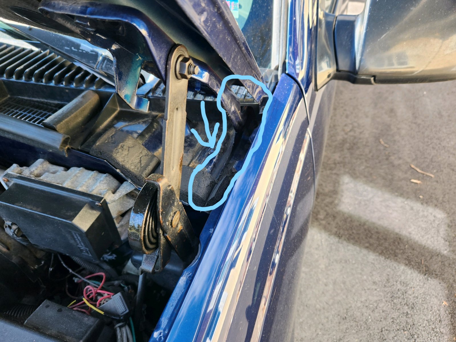

can you post pictures of the area that you are using the sealant on? i know you said near the cowl.. and what all did you have to take off to get to it? was it necessary to take off the fenders.. ?

Here ya go. It's by the hinge where the two top bolts are, that hold the fender. In my case the seam sealer had cracked and allowed water coming off the windshield to drain down and enter at the cracked point. You probably don't need to take the fender off, I got lucky that I didn't have to. (Sorry the pic is dirty, been a little cold to a good wash here in NJ)
