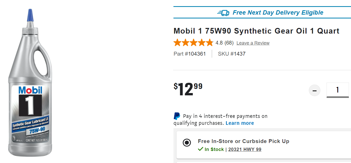

Going to be changing the oil in the differentials coming up. This is the first time changing gear oil and Want to make sure this is what you guys would recommend. I have read a bit about it, but want to double-check. Thanks for your input. Looking at
Mobil 1 75W90 Synthetic Gear Oil

What do you have for a vehicle? Pretty sure the AWD front diffs take 75W90, but I think the 4WD front diffs take 80W90.
Am thinking the rear axle takes 75W90.
Check your owners manual.

Sorry, it was in my signature, but looks like it disappeared. 2002 Yukon Denali 6.0

Thank you for the discussion and replies. Are we saying that this Mobile 1 will work fine??
