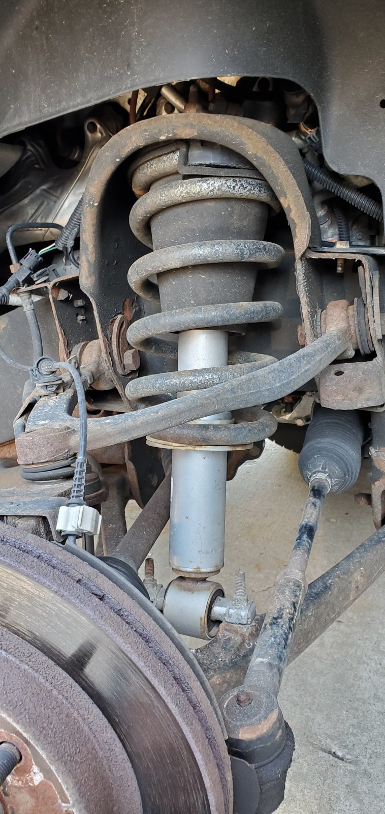

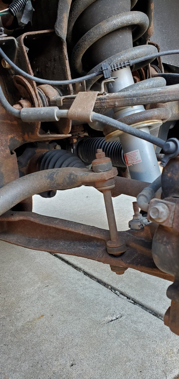

Looking for a light clunk that started up front. Found the driver front wheel bearing to be on its way out. But, while in there...I MIGHT want to replace some of these lol
I didn't see a single one that wasn't severely cracked. At least the front coilovers look fine...oh wait. It's actually worse than it looks
I didn't find anything noticeably loose on either side. However, if I'm fair, if I were to attempt to apply any sort of leverage whilst in an awkward position, my lower back would look like a cat fighting to get out of a paper bag due to the ricochetting discs.
Anyone have a mass bushing kit to recommend? "But which ones do u need?" U ask. "Yes." Is the answer. 20211023_151123.jpg20211023_151205.jpg

How many miles? I took a poll a while back and the average came back to about 160K miles for when the control arms, ball joints and bushings need replacing, or after about 10 years. And guess what? We did the whole kaboodle at 11 years and 160K miles. Rebuilt the struts with all new parts as well.

Gotta love it when a plan comes together. I'm close to 140k. It's lowered 3/5ish and I tow close to capacity so I'll just blame that for the "expedited" deterioration rate.
Hopefully I can find some good vendors and quality (non counterfeit) bushings for another 60k outta ol' Hector here

No bushings are sold separate. Buy new OEM GM arms front and rear and a new panhard bar. Makes a huge difference.

At ~145k miles, I just replaced my struts, coil springs, upper and lower control arms (which include all bushings and the ball joints), and the sway bar and connecting rods and bushings. Now, I don't need to be concerned about wear on any of those parts.
