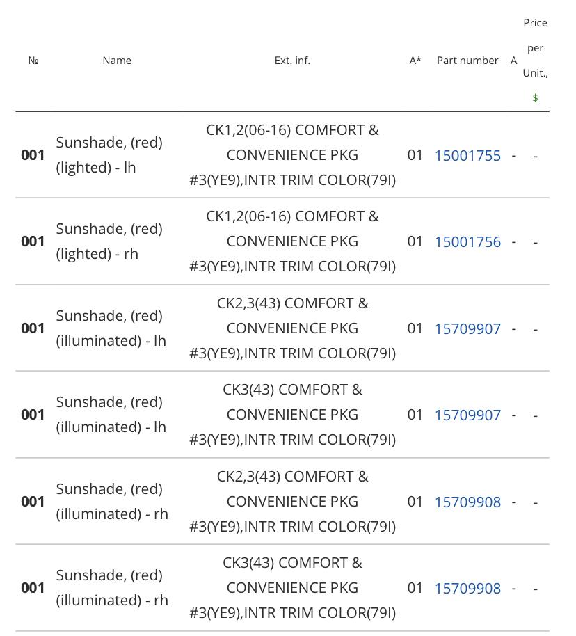

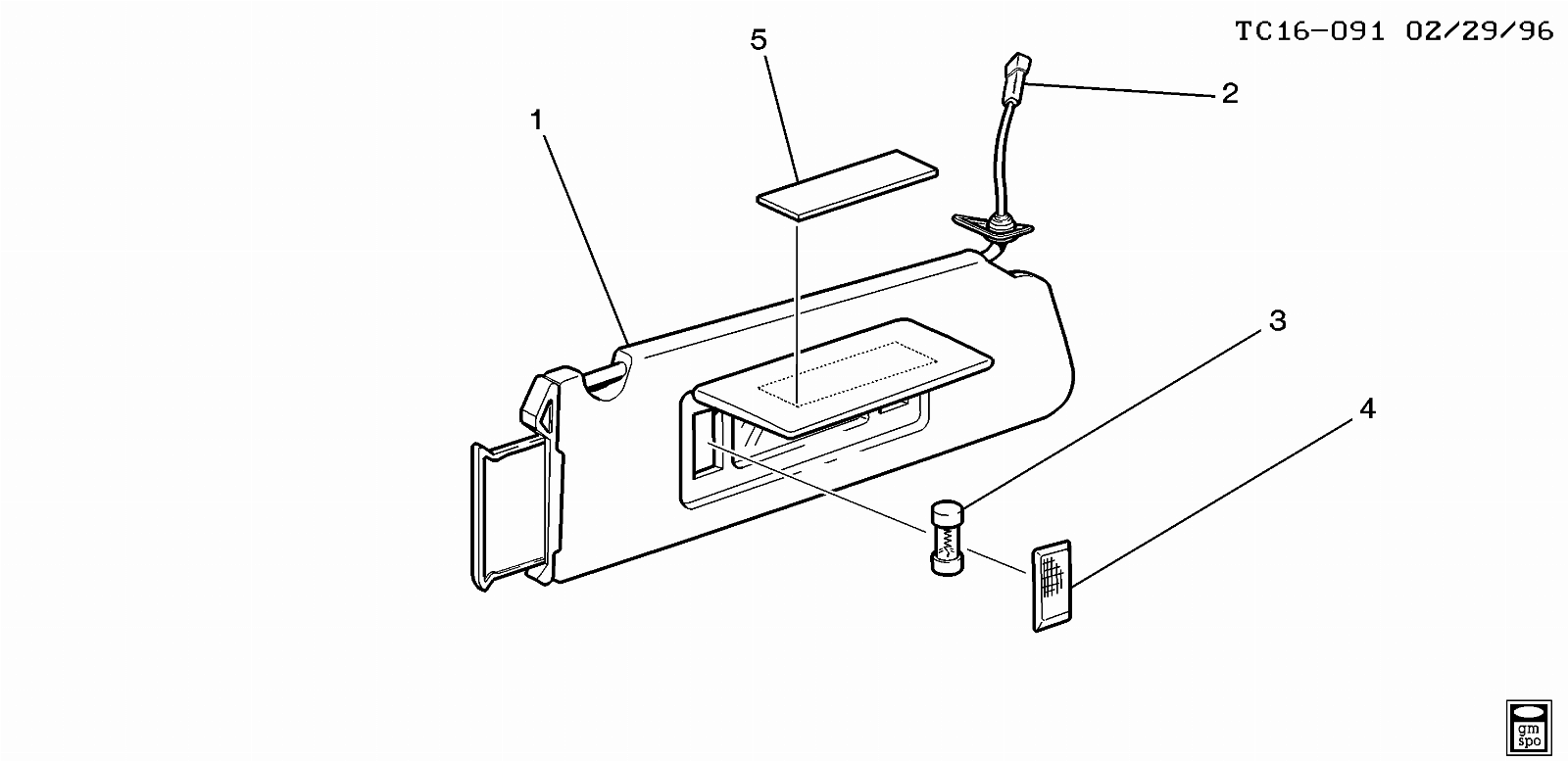

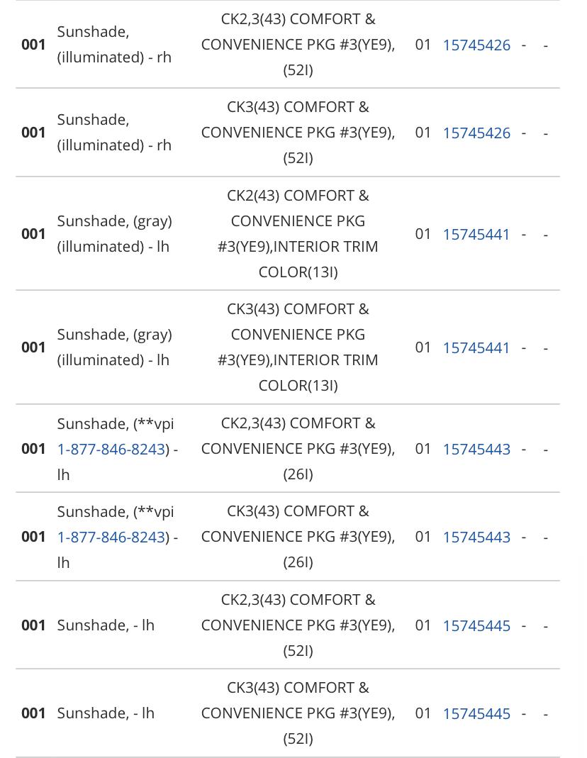

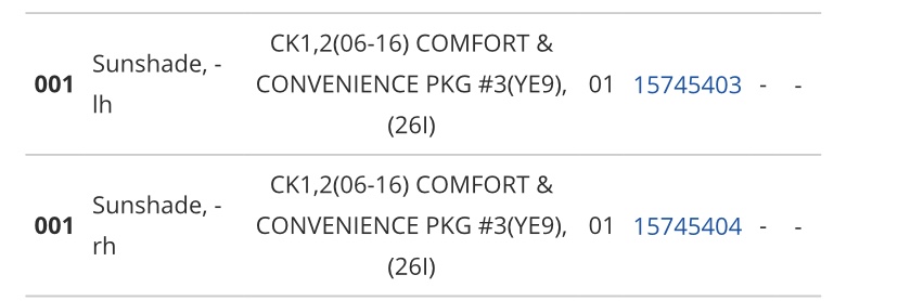

It looks like the cover was not sold separately. For color blue (26i) two and four door utility (Tahoe/Burb), the GM part numbers are on the right.
Item 5 was the airbag sticker.
Edit: here’s the rest of it for the other colors
