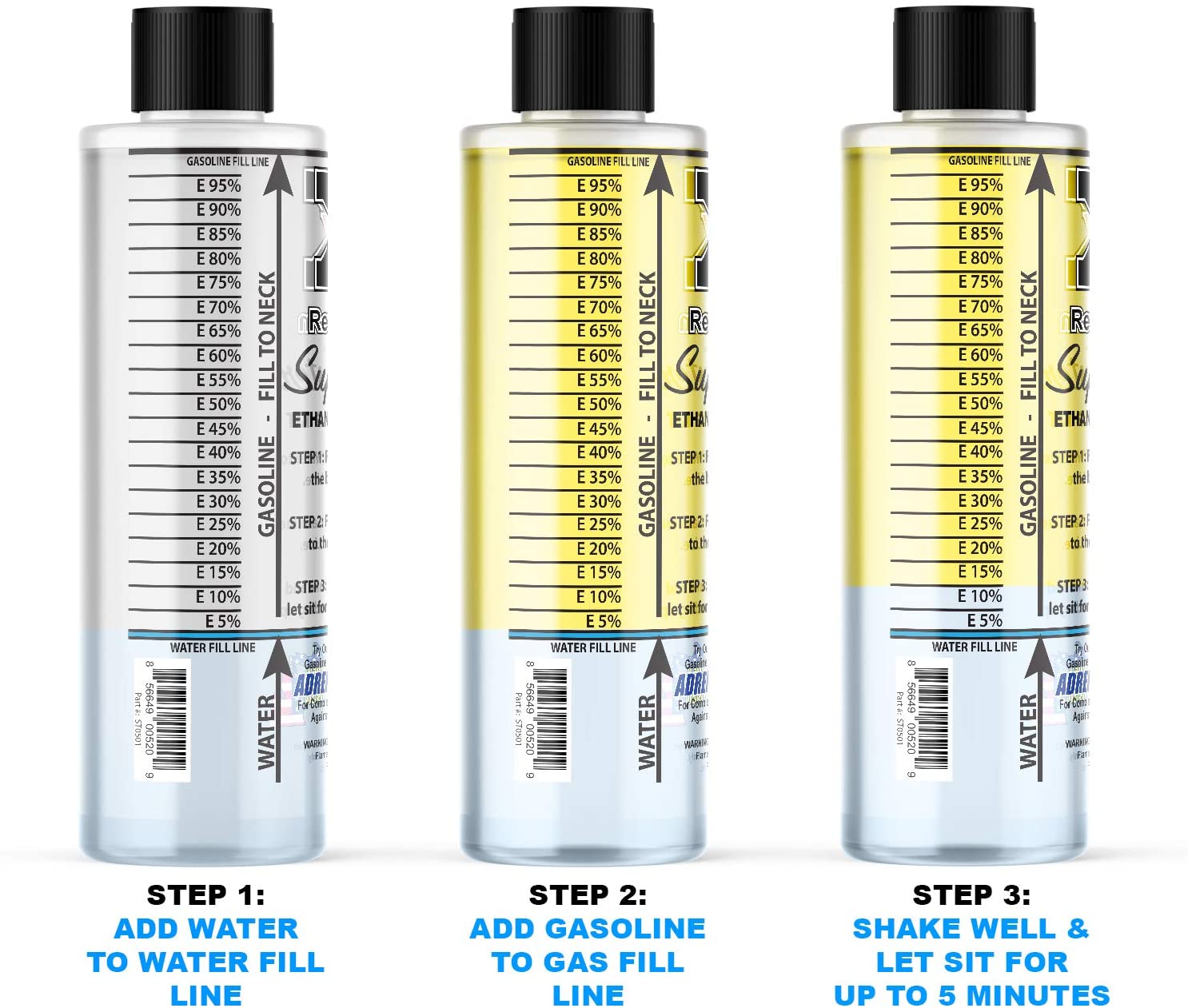

Was recently asked to do a comparison between what the engine computer shows as the alcohol content and by taking an actual sample of the onboard fuel from the fuel rail.
Both vehicles have been driven less than 30 miles since refueling.
The 2012 6.2 Sierra showed a virtual alcohol content of 21% and the actual measurement came out to about 19% after letting it sit for 10 minutes or so. This truck was refueled two days ago.
The 2009 5.3 Yukon XL showed a virtual content of 77% and the actual measurement came out to about 80% after letting it sit for less than 5 minutes. This truck was refueled today and the fuel has about two hours of run-time on it and the beaker was slightly over-filled.

Are you testing the fuel in one of those little beakers?
