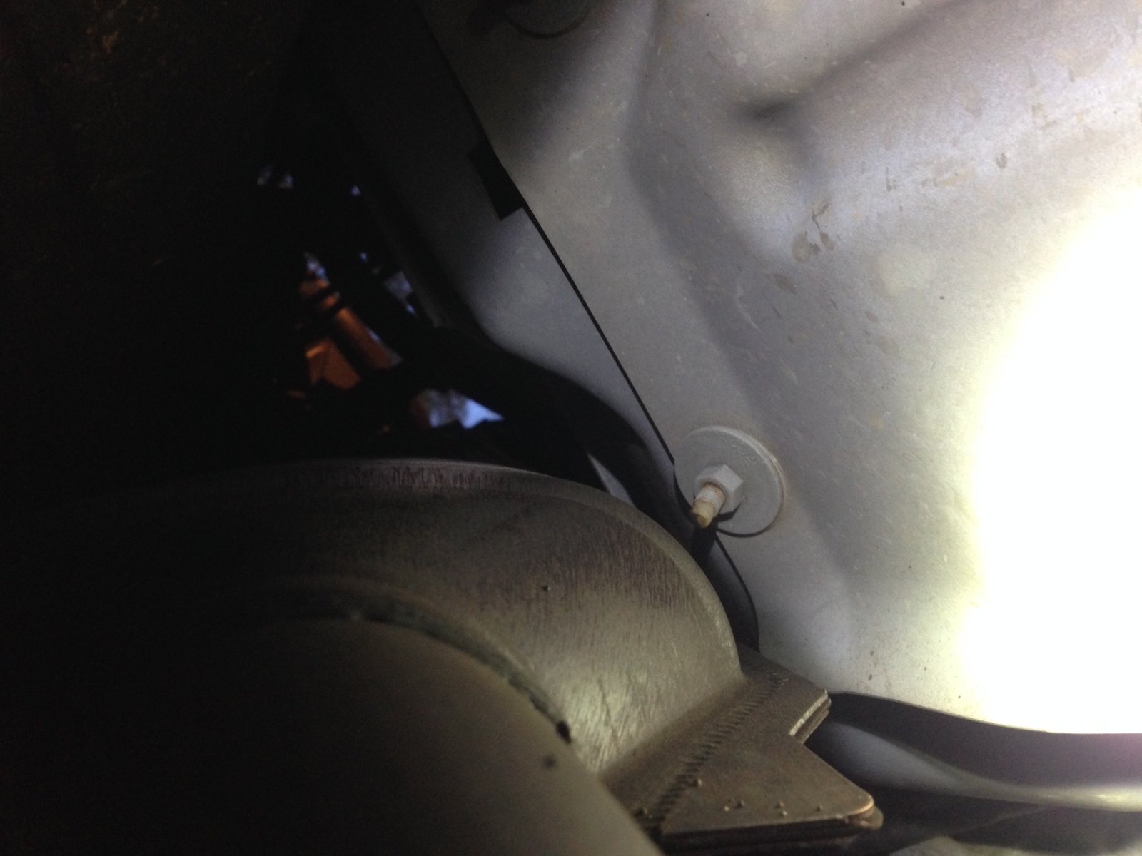

Solved!
This bolt was the culprit... The cat was making contact. I managed to get a dremel up there and grind off a good amount. No more vibration and terrible sounds!
