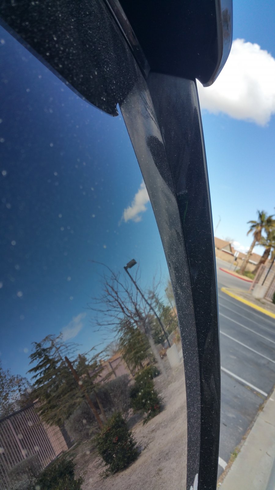

I didn't know that these had an improved CD. So are you saying that most of it comes from the redesigned rear?
yes the square rear shape helped changed it....
that is why the 2015 has the evolved version since it's based on the hybrid rear end the main revised part is the flat glass
21,321
30,315
Cool, we think it funny that my truck is more aerodynamic than our little Kia Spectra sedan!

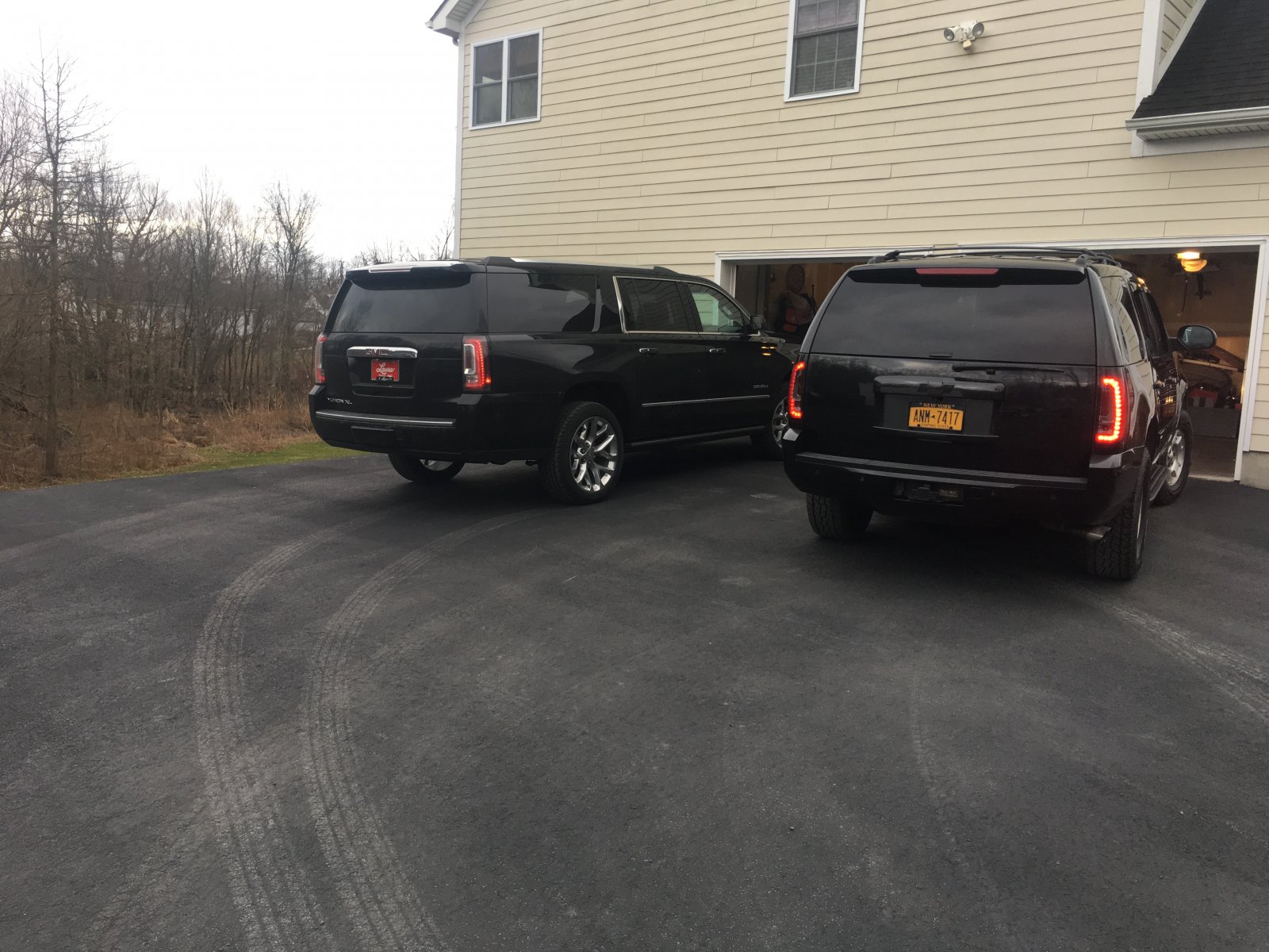

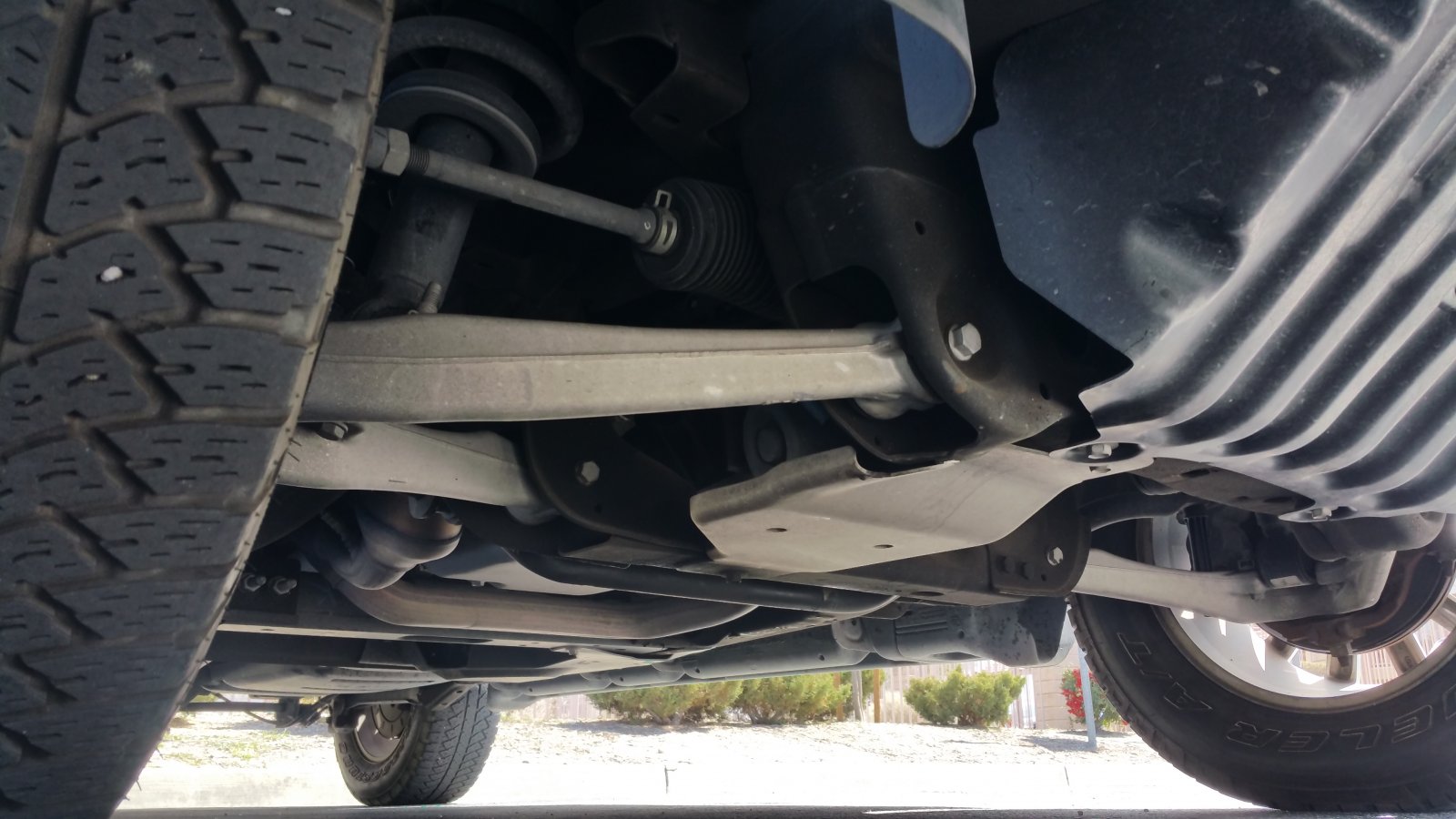

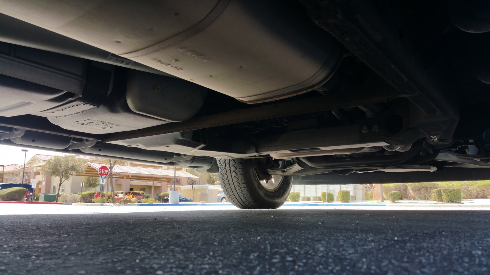

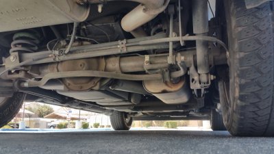

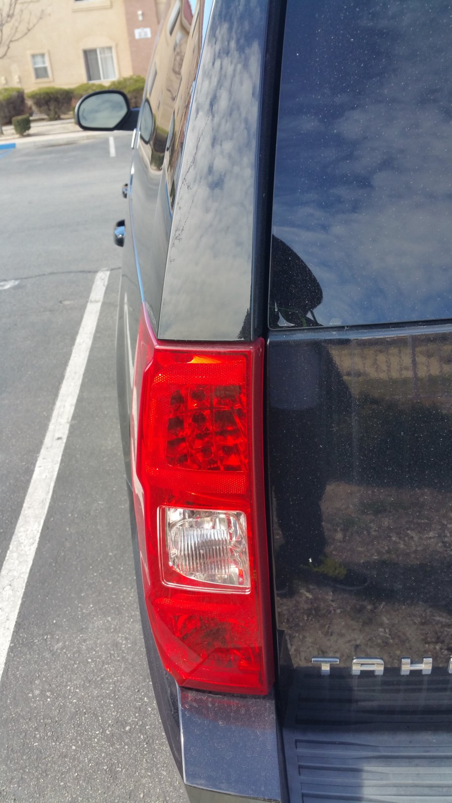

i took some forced prospective photos to you can see it better
Geo metro has a coefficient of
0.34 Geo Metro (Hatchback)
so the tahoe has the same as a Geo metro but at 5200 pounds you will not get Geo metro gas mileage ..
