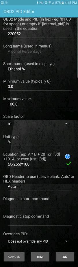

Ok... Success finally
I did some more digging around and finally found the PID parameters that worked for my 2008 to show the ethanol content.
It is as follows...
Now I can see that on my 3rd tank of E85 I am at 74.9% Ethanol.
I hope this info may help someone else.
I am still trying to figure out the oil temperature and oil pressure and transmission temperature.
If any of you guys have these working could you please post up the PID parameters from the Torque Pro app.
Thanks.

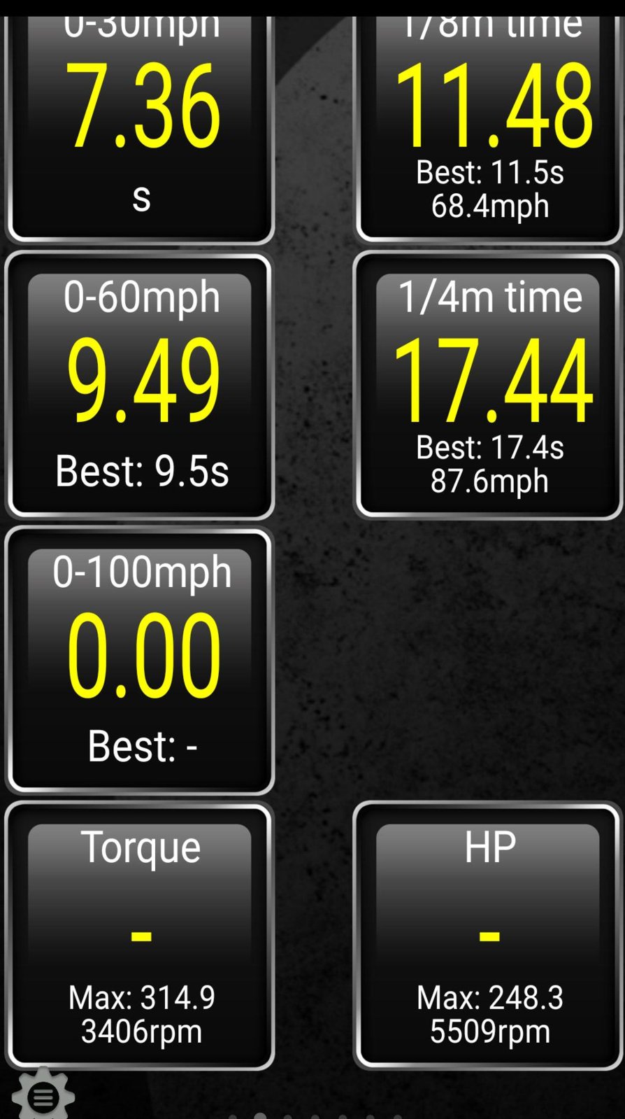

So I did some testing with the Torque Pro app today...
2008 Suburban LTZ 2wd 5.3L LMG 4L60E 4speed transmission 3:73 G80 rear end..
On E85 at 74.9% Ethanol content
Out side air temp 90°
Traction control and stabilitrac off
Full throttle from a dead stop.
Here are the results...
Not to bad for a 6000lb+ tank... lol
I have the Suburban set in the app at 6500lbs which I think is pretty close to being accurate.
I am interested to see what the differences might be running 89 octane which is what the truck is custom tuned for.
