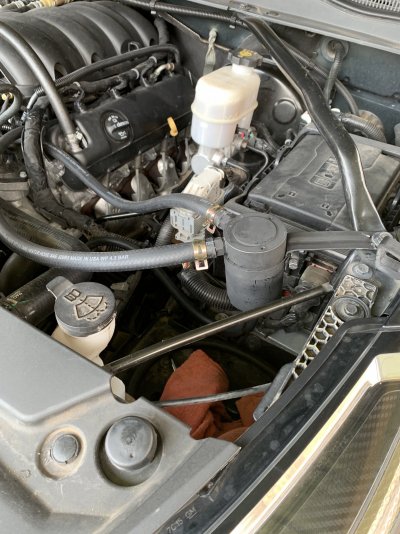

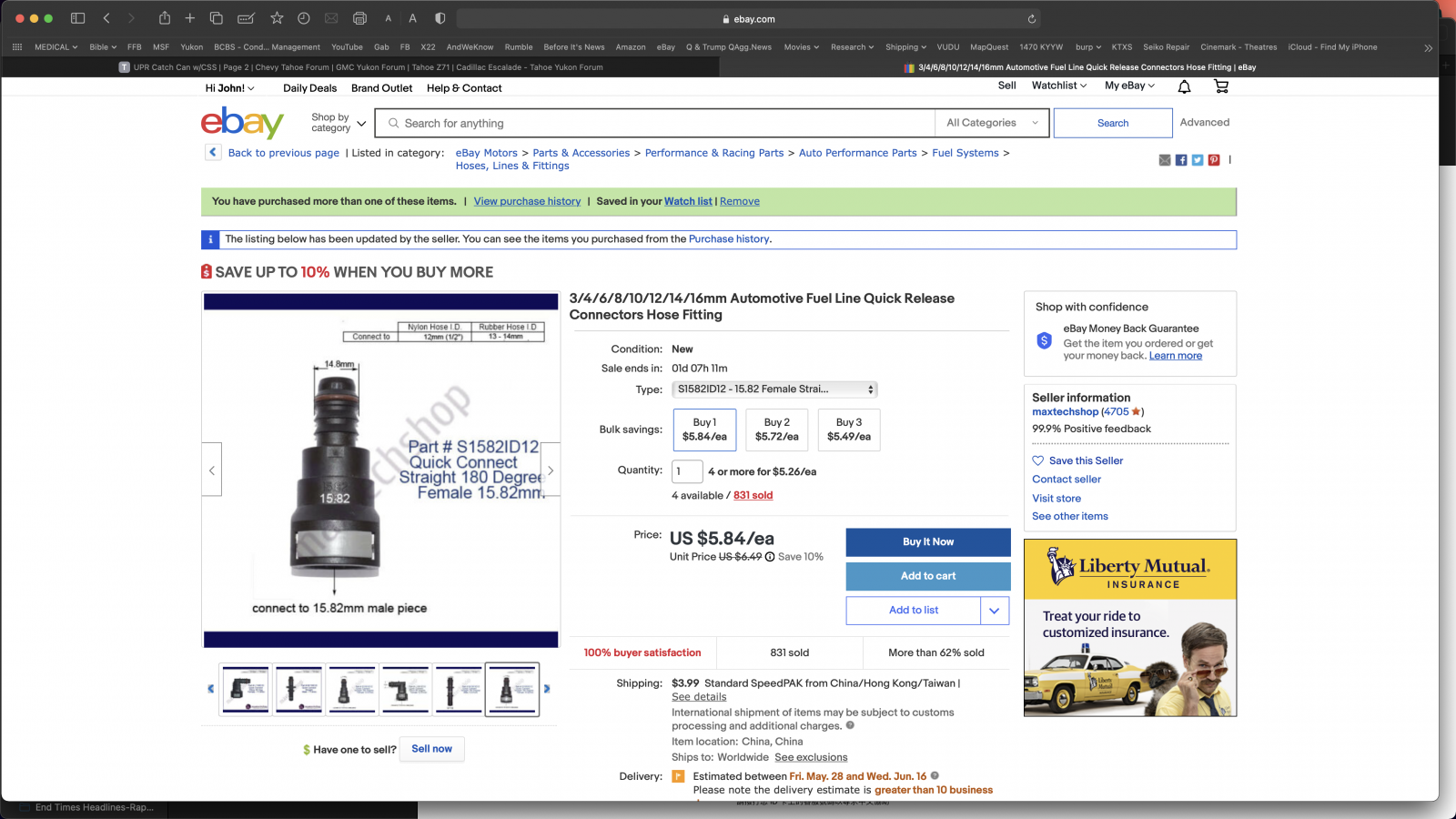

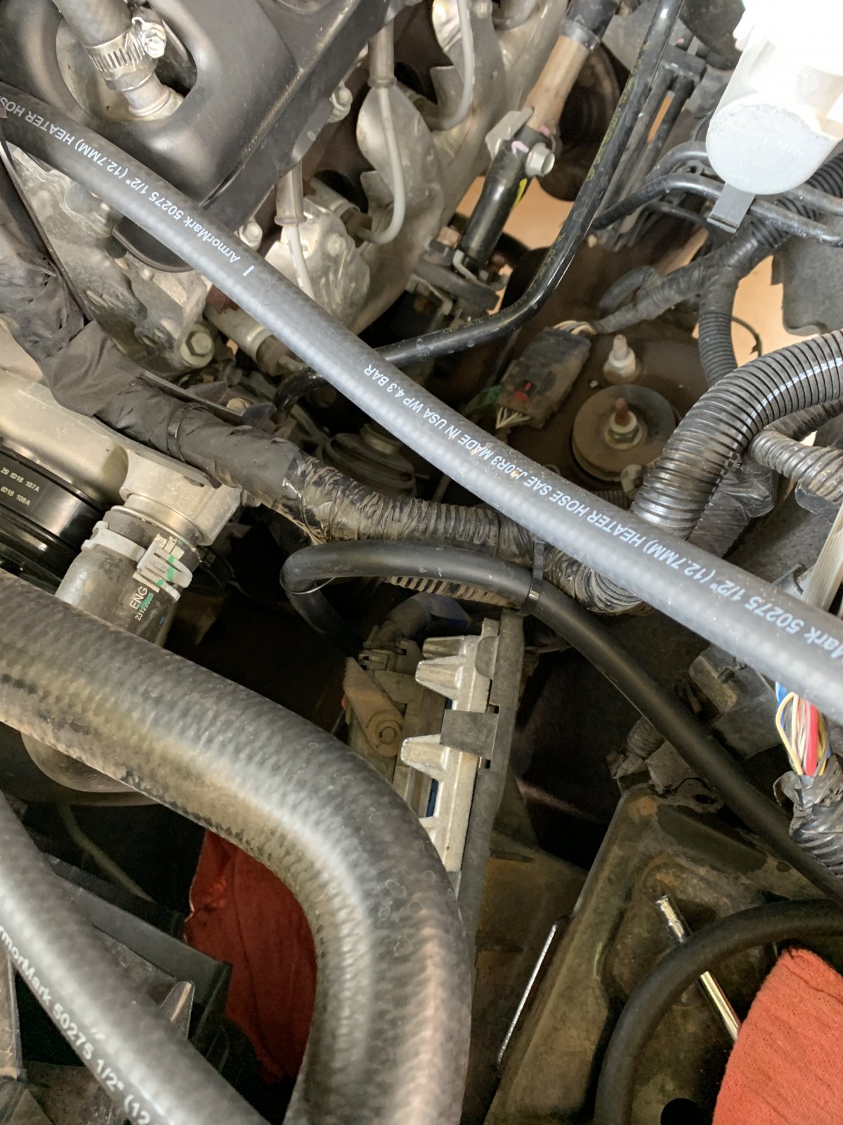

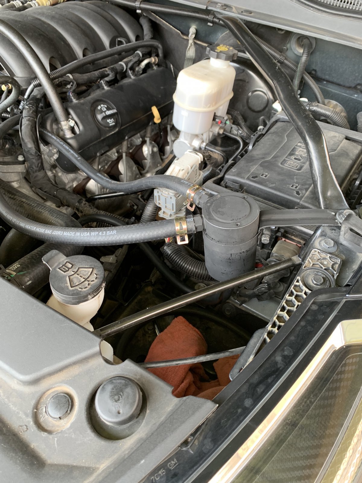

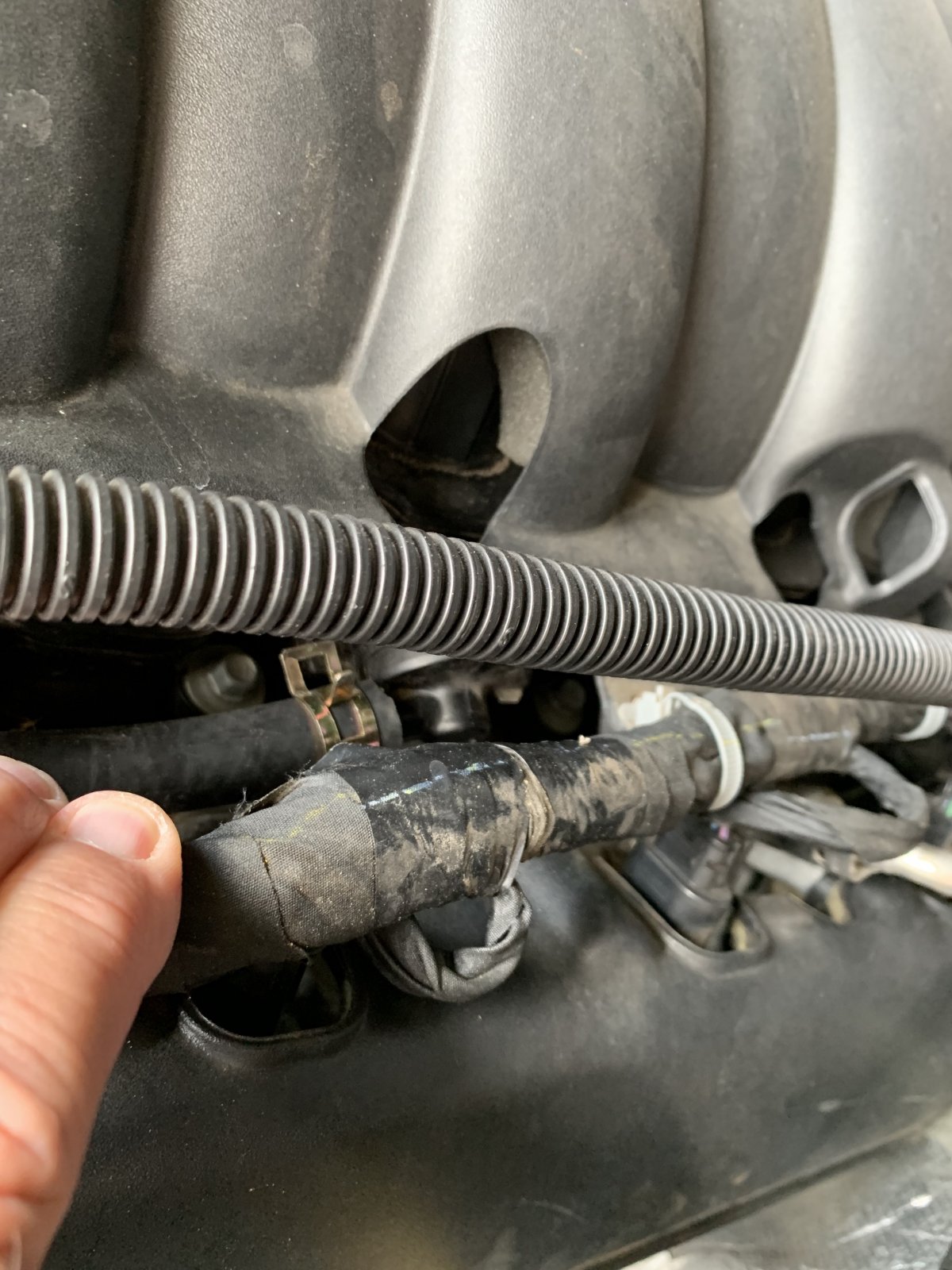

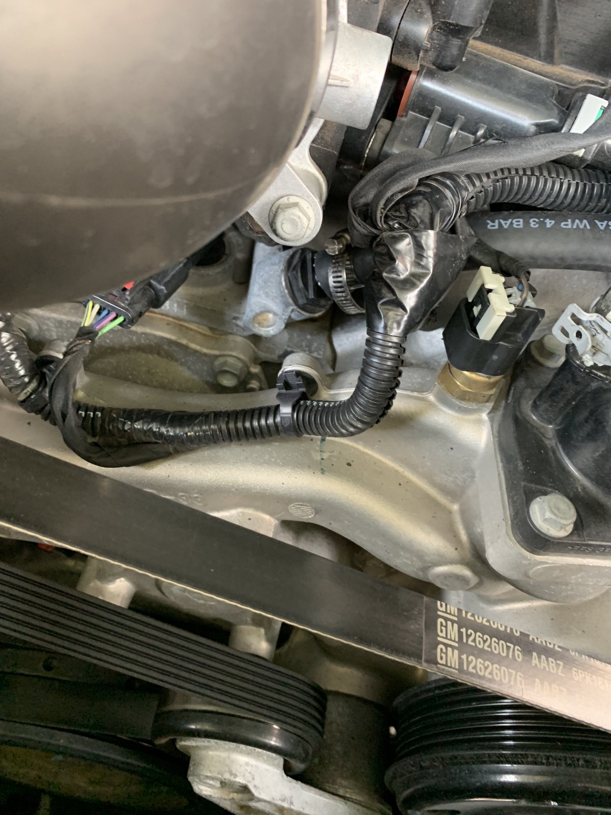

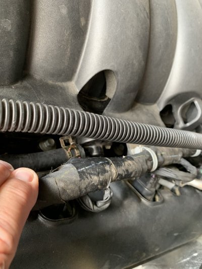

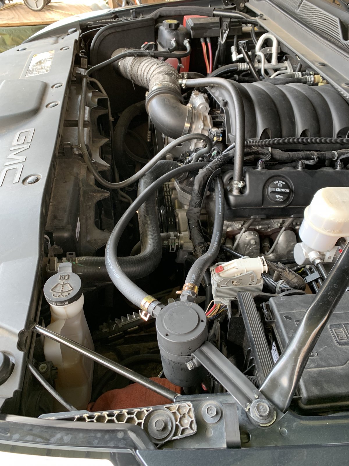

went with an Ebay universal....
  • OCC & Spectre CAI w:header tape.jpg
