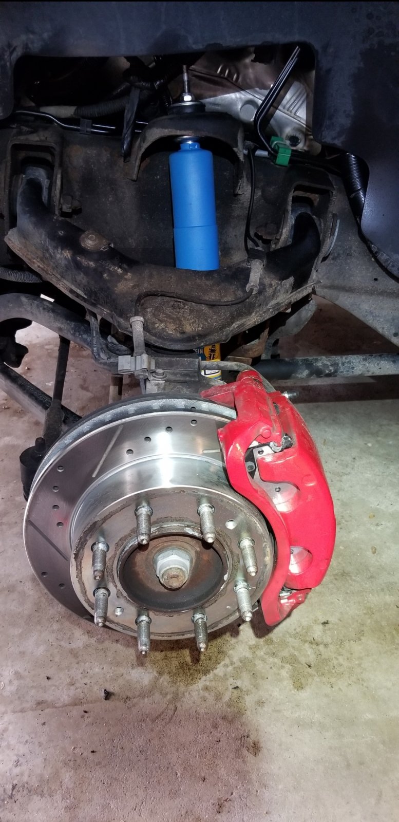

@intheburbs Hey Bill, do you have jounce bumpers (bump stops) on your front suspension? Not seeing them at GMPartsDirect.
Well, if I had them, they're not there any more...
