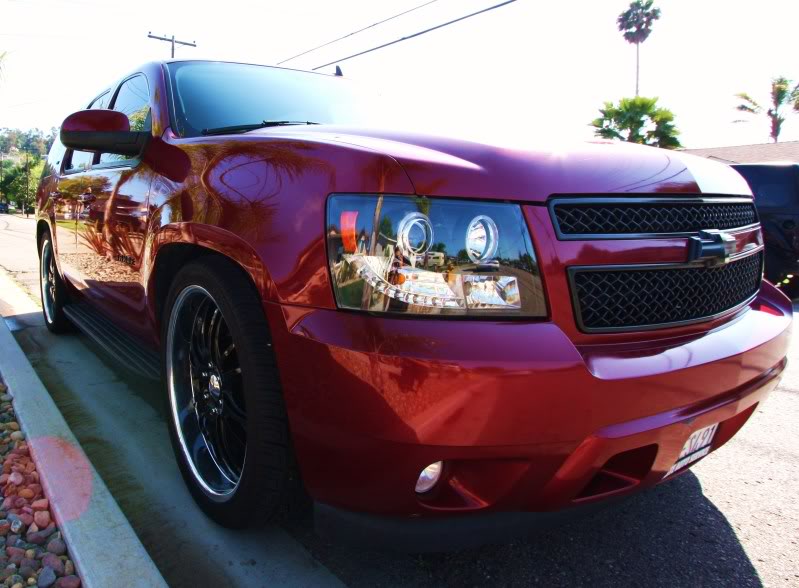

I did those same lights and HID's. I found the beam pattern looked like crap too. I posted pics on here and someone else mentioned using a spacer. What did you use for a spacer and how big? The other guy mentioned 5/8". I was worried about sealing off the bulb and spacer from moisture... Here's a pic with the lights in and a stock pic for the other guy wanting a close up. They do look like crap at night without modding...
We actually machined a spacer that was just large enough for the light to go through and fit into the recess in the light housing. I don't remember what the exact thickness was since we kept modifying it. We also machined it to where it wasn't perfectly square to get the light exactly where we wanted it.
You could accomplish almost the same thing by bringing a bulb down to home depot and picking up some stainless or aluminum washers that are just large enough to slide the bulb through. Buy a few of them (preferably thin ones) and then start testing.
We took the housing out of the tahoe and turned the lights on and then moved the bulb in and out of the housing to see where we got the best beam pattern. Then just add or subtract some washers until you get it to where you want. It's never going to be a perfect HID beam pattern, but you can get it to look better than what you got...
After we got it all put back together we used silicone to seal the lights against moisture.

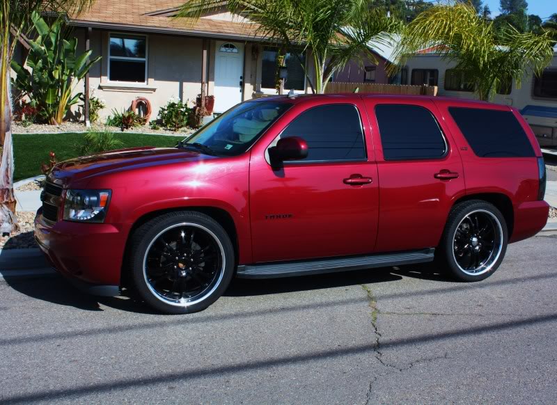

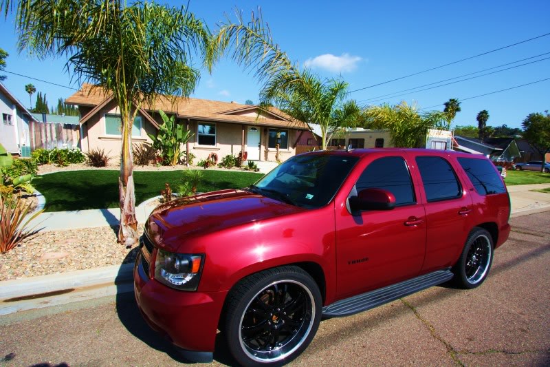

Took a few updated pics of the Tahoe this weekend. Since the last pics we got the roof rack off, color matched the mirror caps and painted the lettering on the sides...
I think its all done (besides buy a new center cap some douchbag stole)

Nice ride by the way! How low did you go?
It's a 3/5 from norcal SS (member in the forums). It's the djm a arms in the front and Tbss drop coils in the rear. It rides VERY nice for a dropped SUV and the install was very straight forward.
Off the tip of my head I think we r running 305 35 24's front and rear and they rub in the front but r fine in the rear. Overall we r very happy with the drop.
