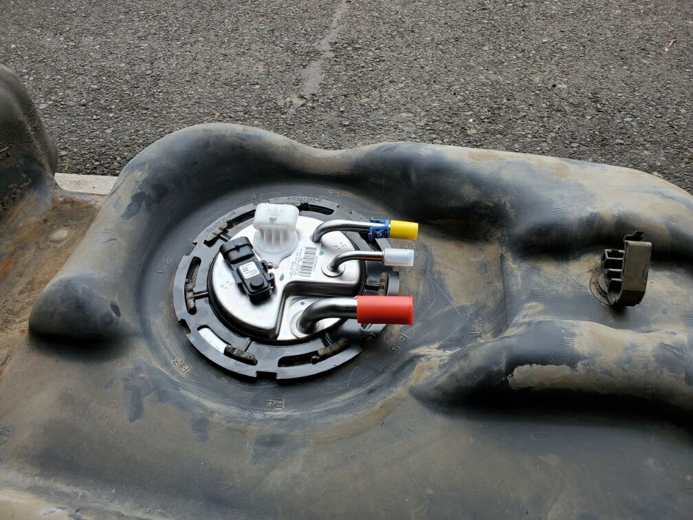

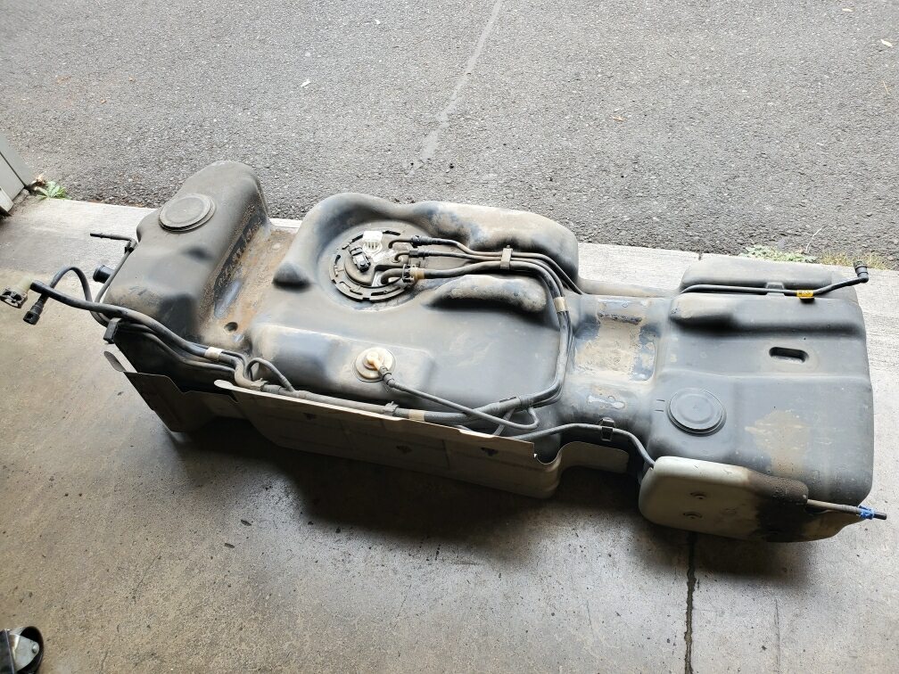

Here's what a 2004 Flex Fuel tank looks like from the top. I've dropped the tank both ways: with and without removing the evap lines (they're "on" in the pic below, on the righthand side of the tank). Non-Flex will look different, but I'm not sure how.
