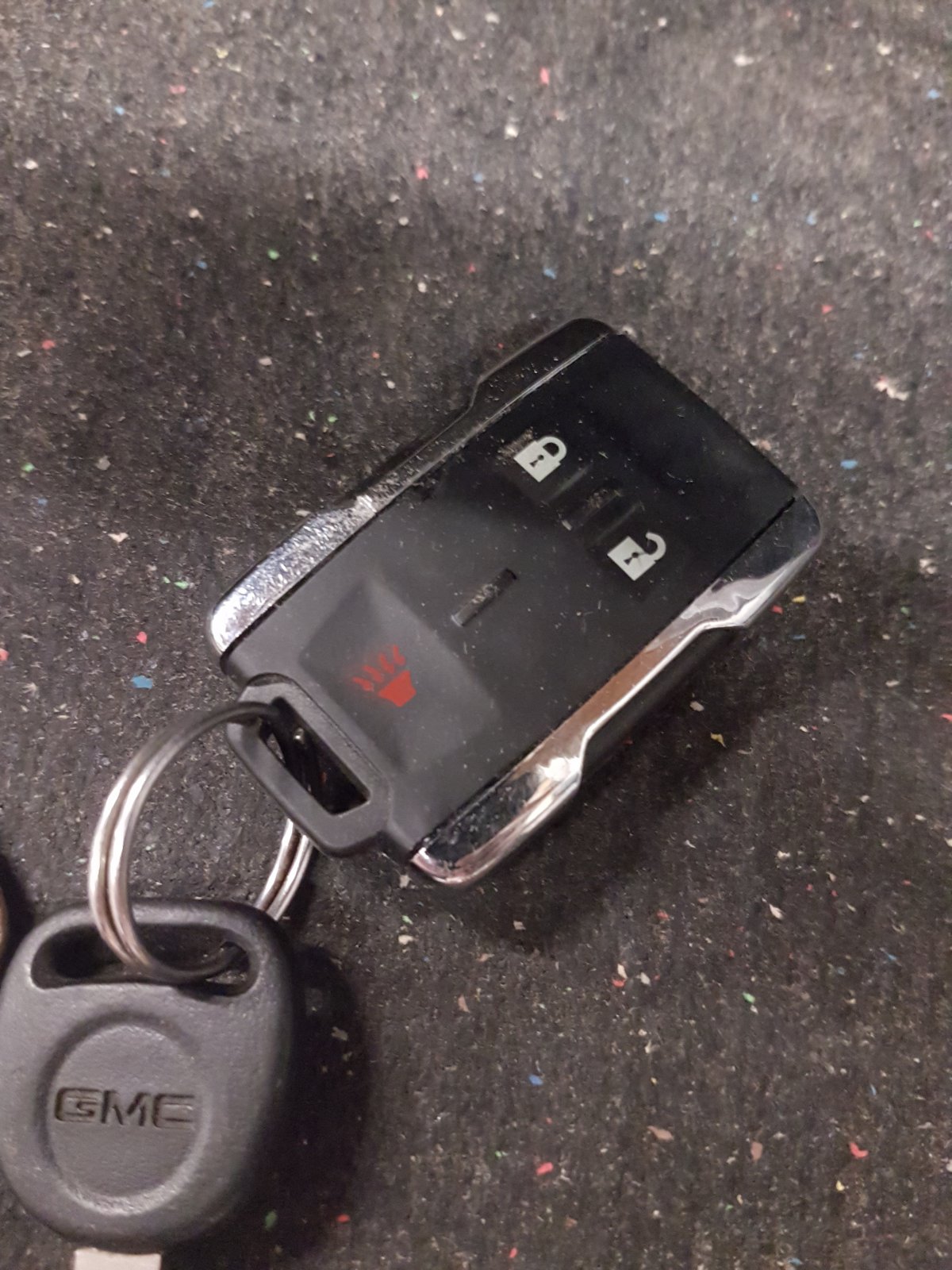

Hey all. So i hop in my truck tonight (03 Yukon Denali ) to go to work and normally key in hear a beep and seat and driver memory kicks in. Tonight no beep and no driver settings.
If I push driver 1 all is normal. On key out no beep but interior light comes on but no easy exit setting.
Where to start looking?
I did add a new remote about a week ago. Been good so far.
Thanks in advance for any help.

Did you try a different remote? Sounds like your settings might've gotten messed up. Did you go into settings to see if they're still the same?

Weird update. In the dic it keeps saying driver 1 reset and wipes out all settings. Turns all user settings off. Pain in the &$##^!@ a$$.
Maybe a faulty switch or wiring? Driving me nuts.
52,949
I would pull the fob apart and check it out then reassemble it. Maybe one of the buttons is getting pushed repeatability and causing it to reset. That’s the one thing that changed.
