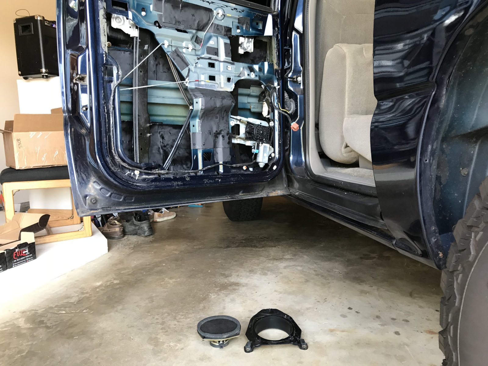

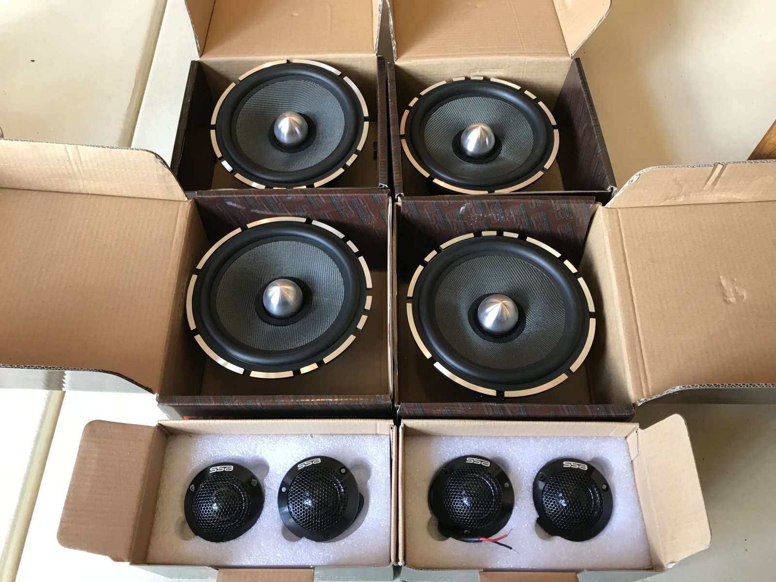

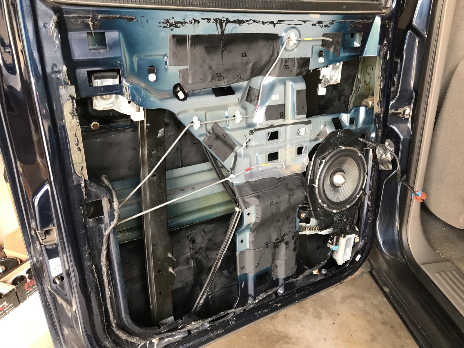

Got some of my speakers in!
Went for more of a Sound Quality build this time, 4x SSA Evil 6.5s and 4x Silk Dome Tweeters.
Went to modify the existing rear doors to fit them
Had to do a lot of demeling, but got them to fit
They sound great!

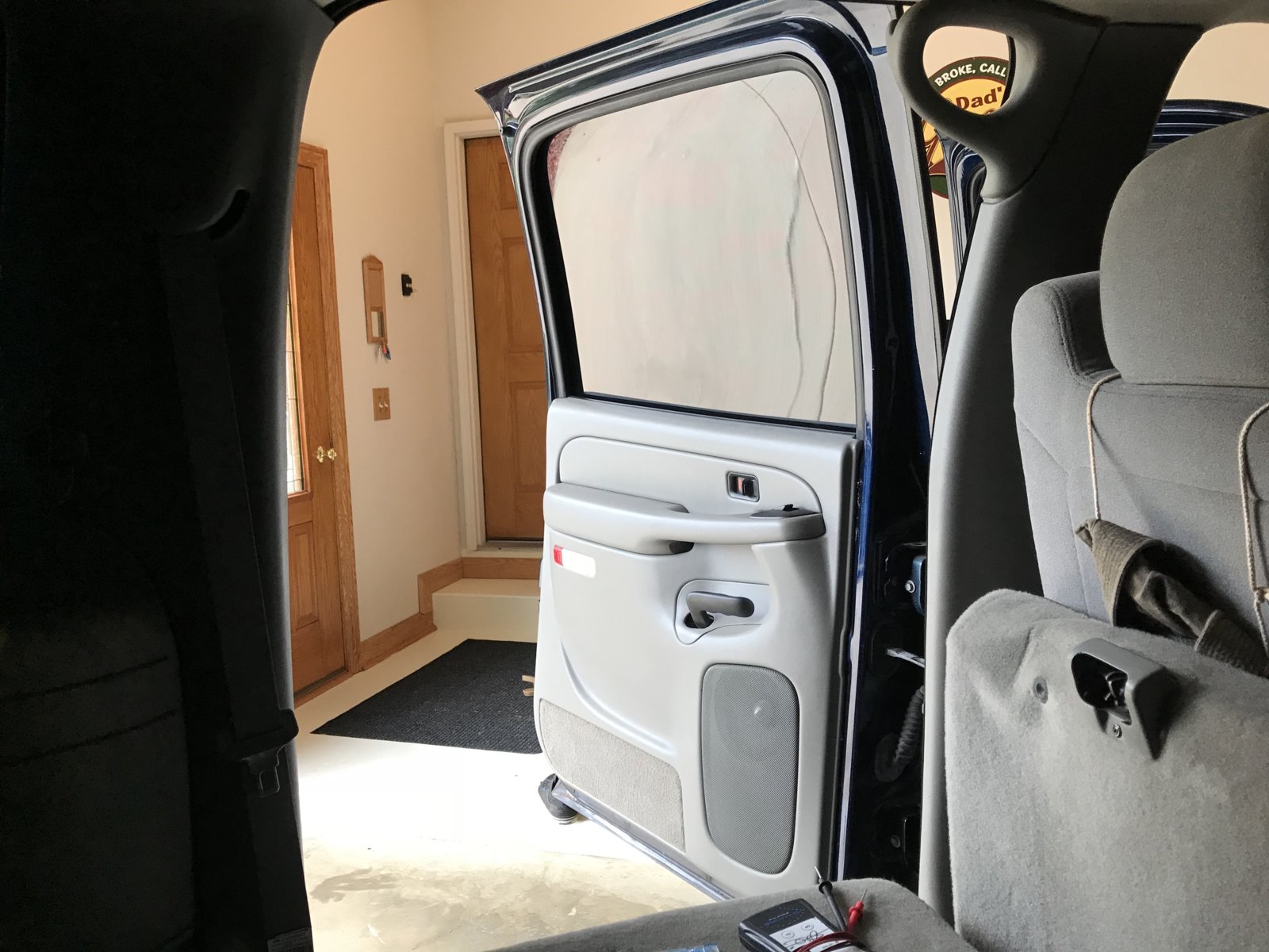

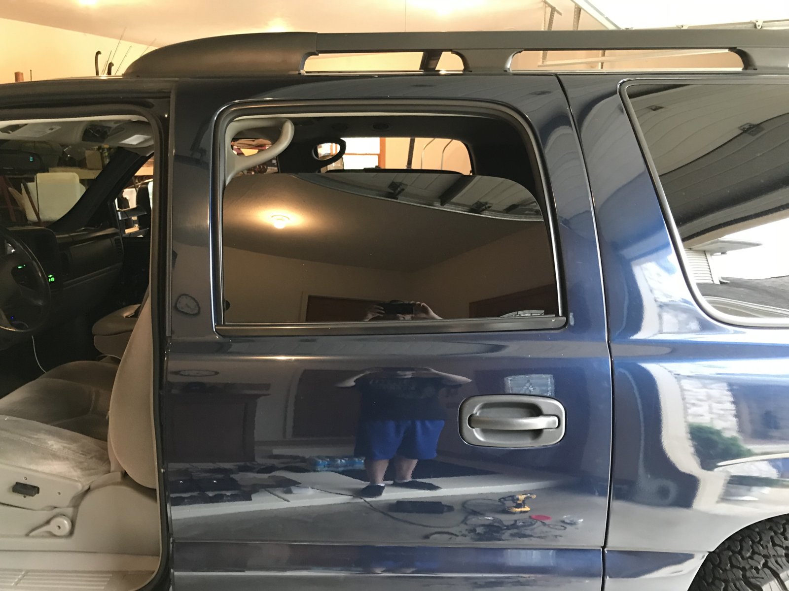

Unfortunately, I didn't check clearance, and after putting the doors back together, my rear windows no longer roll down further than this
gonna have to make adapter rings or something, but that'll be another day

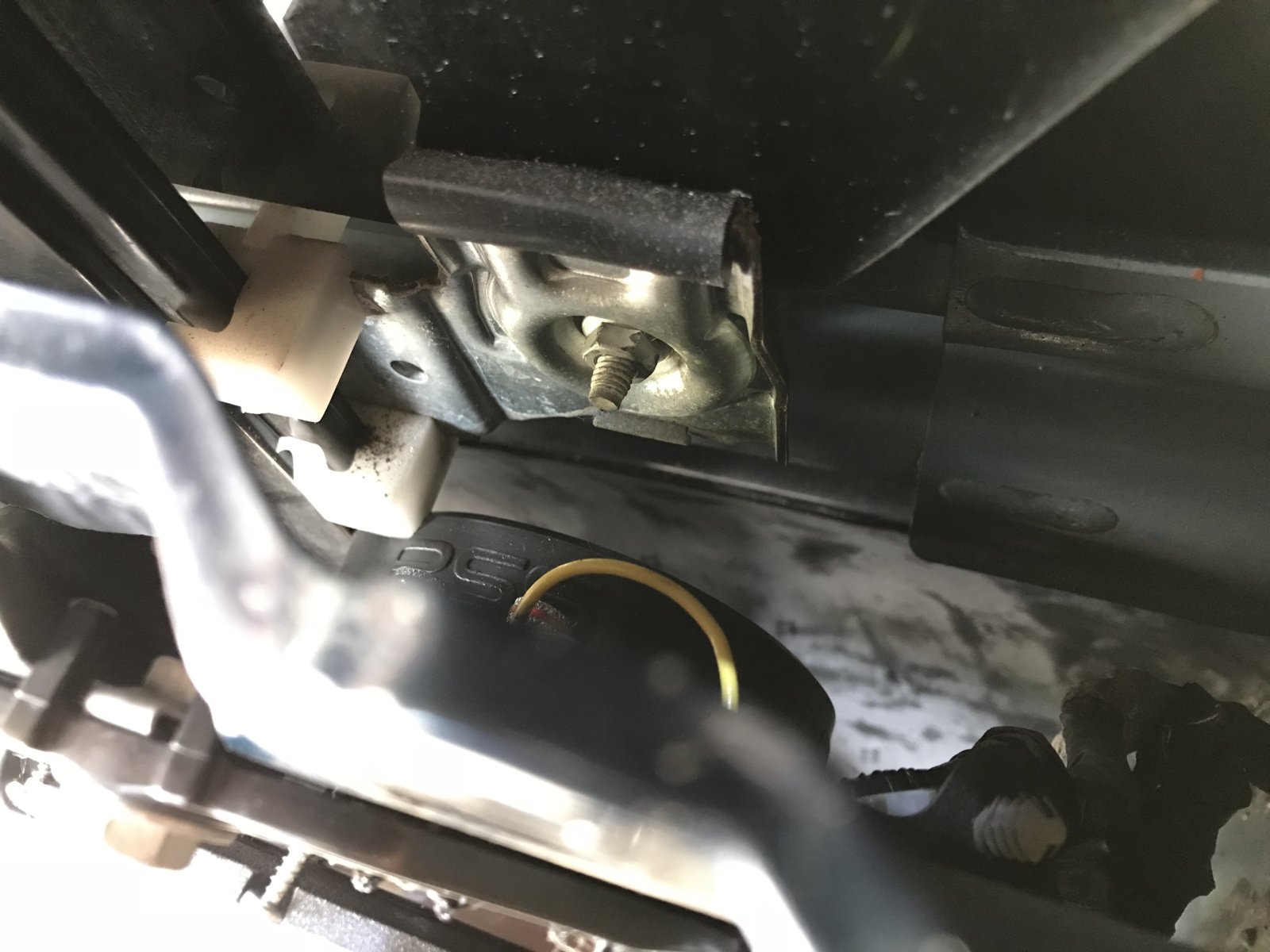

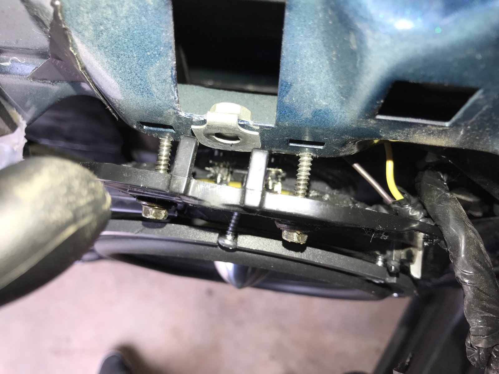

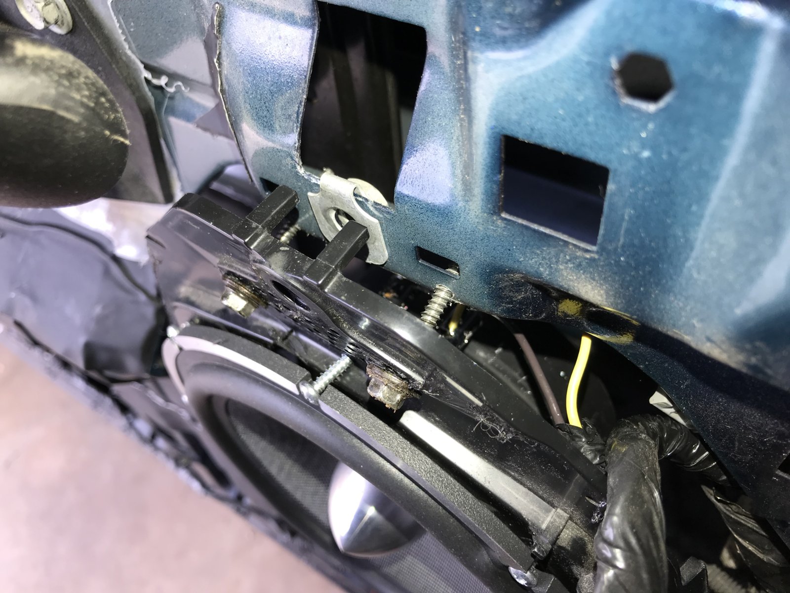

I went in and figured out what was actually preventing my back windows from going down
the motors on my speakers were hitting a plastic part of the window track mechanism
I removed the top 7MM bolt and instead of using the plastic locators, I used them to offer distance between the metal and the door, then put two additional &MM bolts in to hold it secure.
Doesn't look pretty, but it gets the job done, and nobody will ever see it

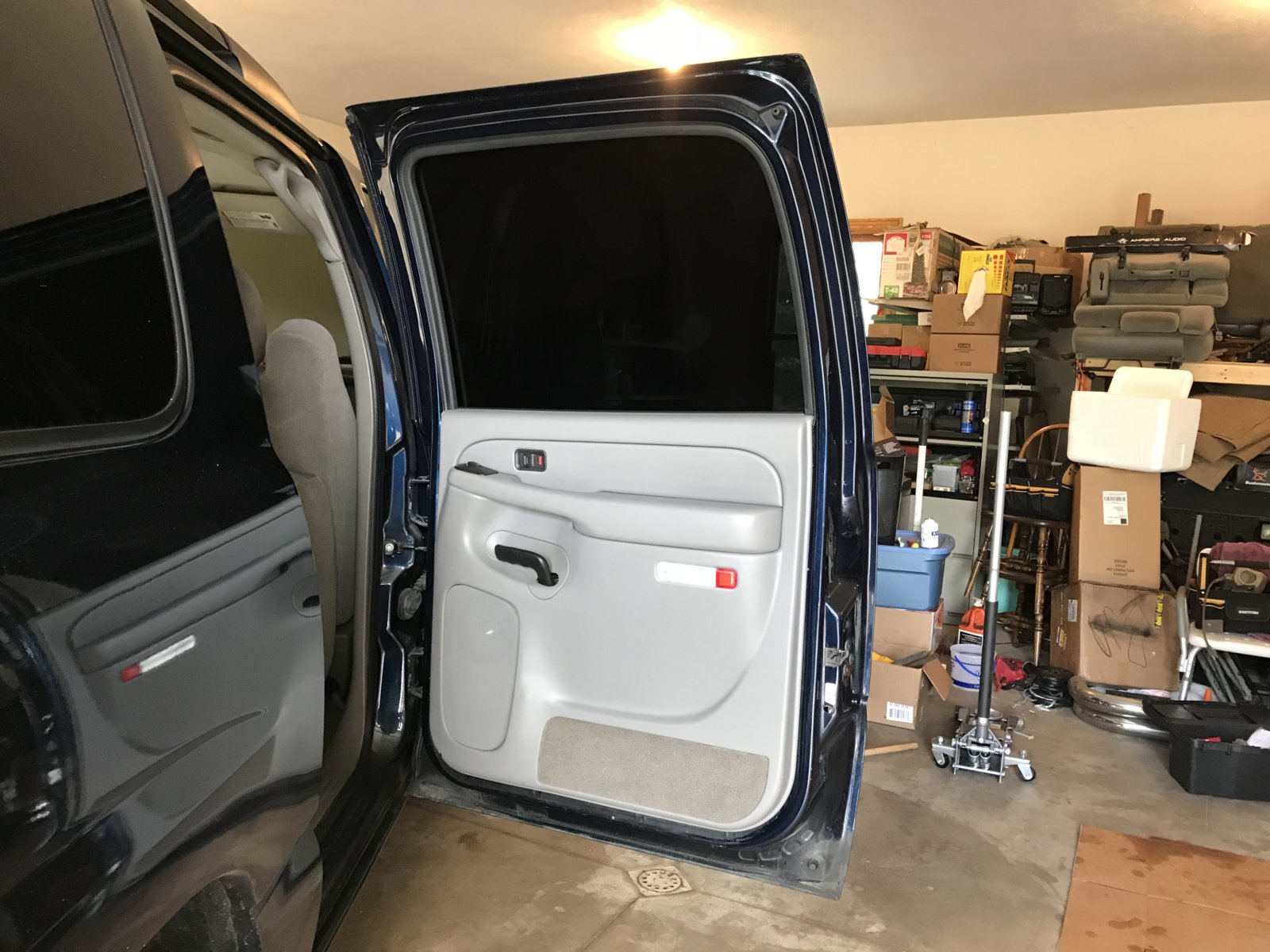

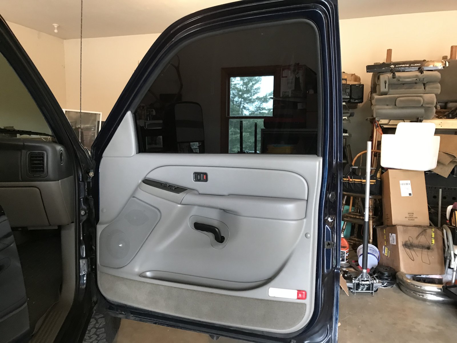

and some pictures of the doors back on
I really like the little shimmer of silver from the SSA speakers, that you can see behind the grills lol
also the pictures do a good job of illustrating the difference between 5% tint (front doors) and 1% tint (rear doors) HUGE difference
