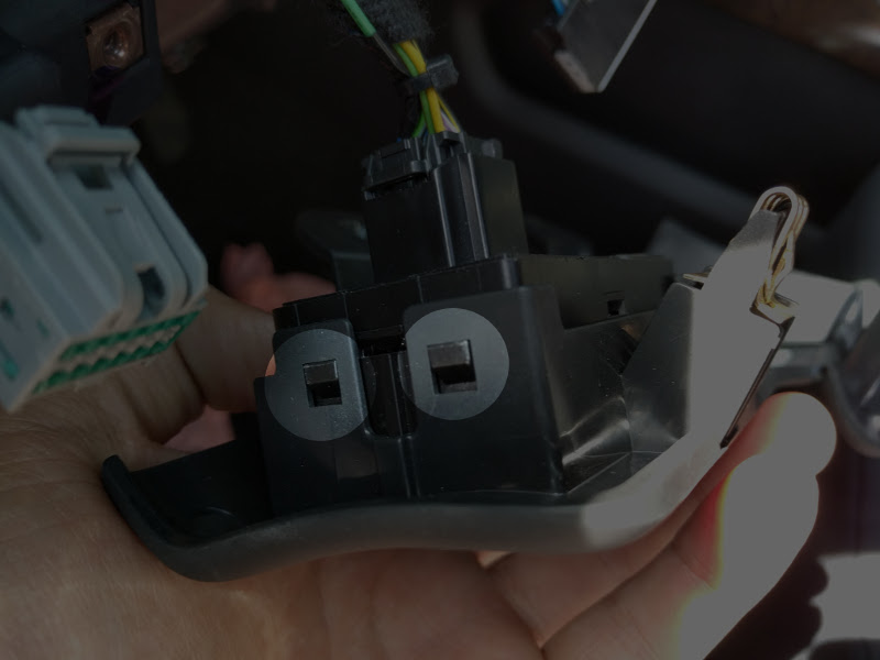

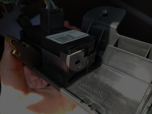

Once you take off that lower dash panel, you should now see two 7mm bolts holding the switch panel in place. Take those bolts off and pull that panel off – again, pull toward the rear. There are maybe two or so clips on this one. Unplug the harnesses and swap out your switch then set the whole thing aside.
The switch is held on with these clips...

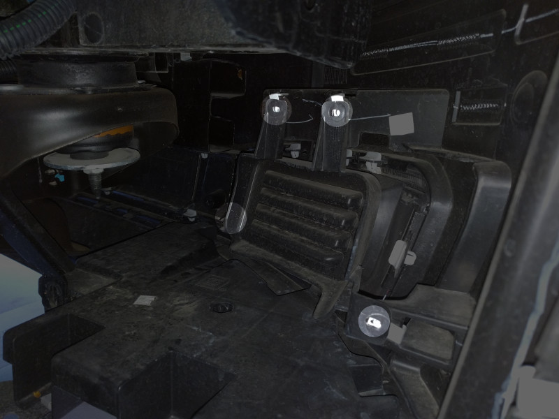

Remove the 7mm bolts securing the felt wheel-well cover on the front bumper.
Get under the bumper and remove two 10mm bolts and a clip holding the felt cover on from each side of the truck.
Reach in and remove four 10mm bolts holding on the fog lamp blanks. (the left-most screw is out of view in the image below due to the angle)
Put the new fog lamps on, turn your wiring up through the fender and into the hood area, and put it all back together if you'd like. Don't forget to secure the wiring with a few wire ties to keep everything tidy.

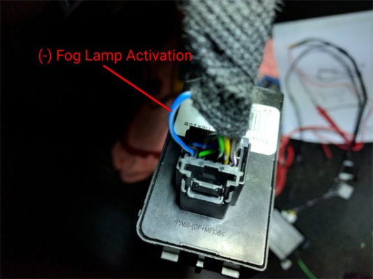

Headlamp switch
Fog lamp request wire (Blue/Gray)

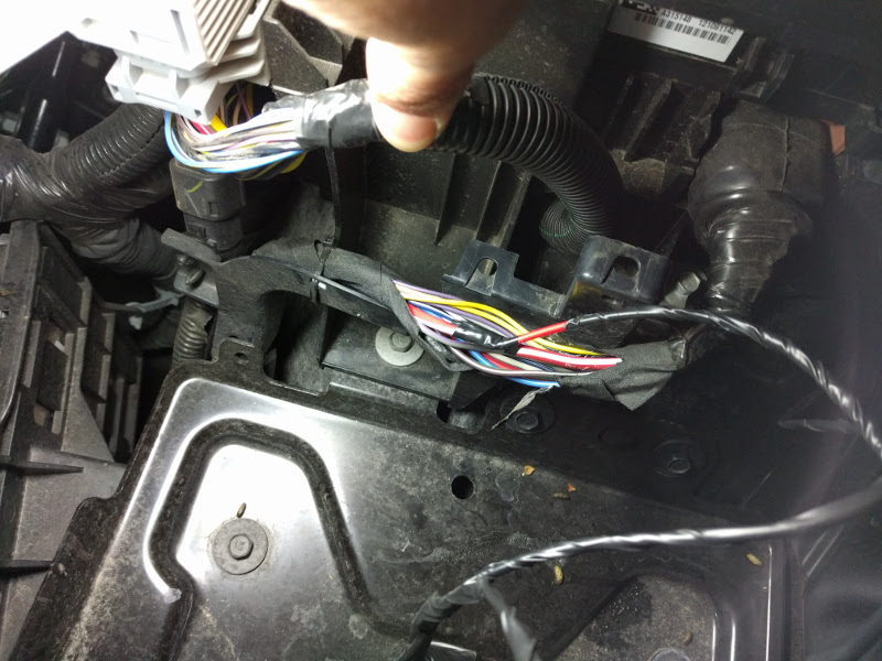

X5 connector with parking lamp (Blue) and fog lamp (Brown) relay activation wires and a decent constant 12V+ source (Red/White) for the 611T note: the fog lamp relay wire may be Brown or Brown/White, take note of which color it is for you!
Underhood
Trigger wire for your fog lamp relay, should be the same color as you found inside at the BCM
Just in case it's not exactly clear from the previous picture where that harness is, here's a more zoomed out shot...
Good 12V+ source for your fog lamp relay
