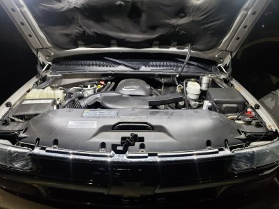

There are a couple spots that cast shadows but probably 85 to 90 percent of what I'd need to get to under the hood
4x10w (12v) led modules thermal epoxied to the bottom of the hood. Acts as a plenty fine heatsink. Wire them up in series. CC/CV controller - really should use an LED driver but the local electronical gadget shop was sold out. Set limit to 12v, current to whatever the lights draw.i need more information on this i want this on all my vehicles.
There are a couple spots that cast shadows but probably 85 to 90 percent of what I'd need to get to under the hood is plainly lit

i dont think a fiber glass hood will work that well for heat transfer. going to look into the rest tho. ill probably opt for something with a built on heat sink or something4x10w (12v) led modules thermal epoxied to the bottom of the hood. Acts as a plenty fine heatsink. Wire them up in series. CC/CV controller - really should use an LED driver but the local electronical gadget shop was sold out. Set limit to 12v, current to whatever the lights draw.
Wire up, toss in a waterproof box, you're set.
