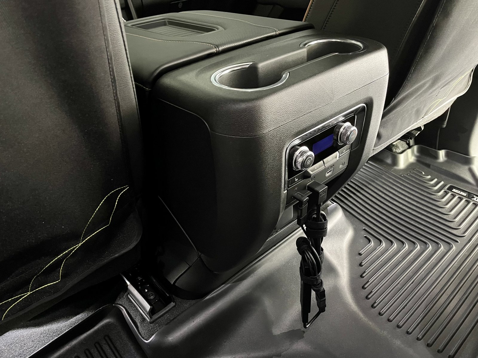

Here's my setup with the Amazon Firestick. I tried tucking it behind the drivers seat with double sided 3M sticky pads but it kept falling down. This setup has survived the two kids climbing in and out the past 3 weeks.

Yup, just went with the average run-of-the-mill plugs. They usually have "elbow adapter" or "right/down angle adapter" in the description. Just make sure you match up your male/female ends accordingly.

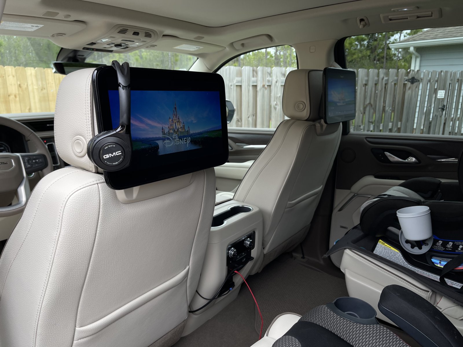

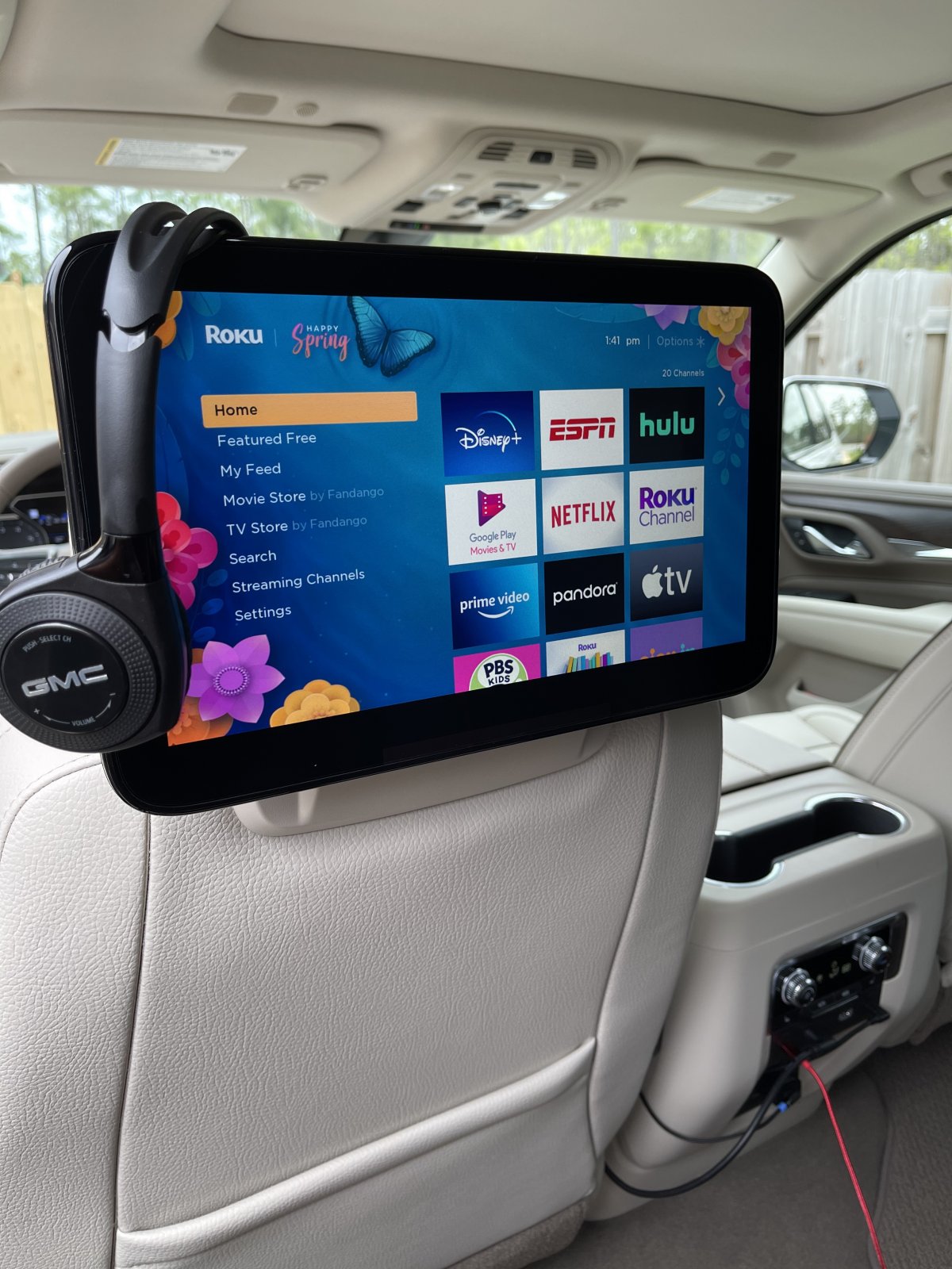

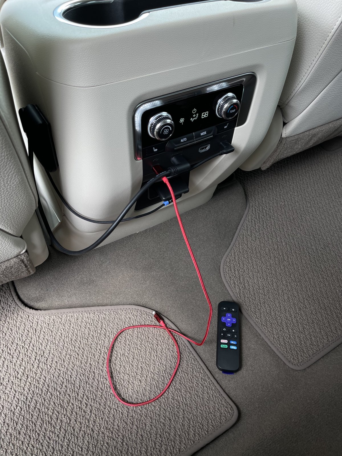

Hey guys! I’m a long time reader, but just officially joined the forum. We just traded in our 2016 Denali for a 2021 Denali. Since I received a few tips and inspiration from this thread, I wanted to put this together to hopefully help some other folks.
I’ll attach a few pics of our setup, explain it a bit, and link everything down below.
We have a Roku Express HD plugged into HDMI 1. I mounted this to the driver side of the console with double-sided sticky pads. It is low profile enough that it doesn’t seem to interfere with the seat at all. I went with this side because the older kid who will be operating the remote sits behind the driver. We signed up for the unlimited data plan for the in-vehicle WiFi for $15/month through Onstar/AT&T. It works great for the Roku and even an additional iPad connected to it at the same time, even in our small town. With the Roku, the kids can stream shows on Disney Now, Disney +, PBS Kids, Nick Jr., Netflix, Prime, etc. And the quality is great.
I also have a 500GB Sandisk SSD plugged into a USB-C port. I have about ~25 movies on the drive that can be viewed on either screen. The drive is formatted NTFS and works great. I used another sticky pad to stash it above the power plug, but it can also be held in place by the door for the plug.
We weren't really impacted by the removal of the DVD/Bluray drive. The only downside I have found so far is that you can no longer watch the RSE on the front screen when the vehicle is in park. We used that a good bit and are pretty disappointed.

Hope this help! Sure keeps the kiddos happy & entertained! Feel free to ask any questions and I'll do my best to answer!

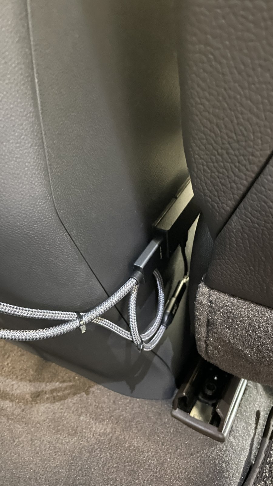

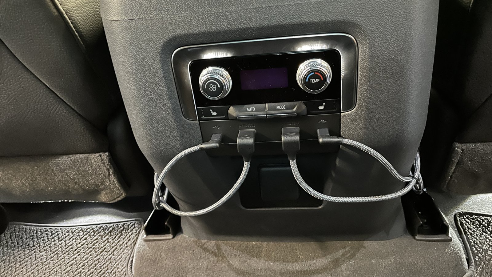

Thanks for all your help on this. I just got my new Denali set up with 2 fire sticks powered on the usb-c so the kids could watch their own shows . Very clean and it works great.
Do you mind posting a link to those exact cables you purchased? I can't find any online that look that perfect!
