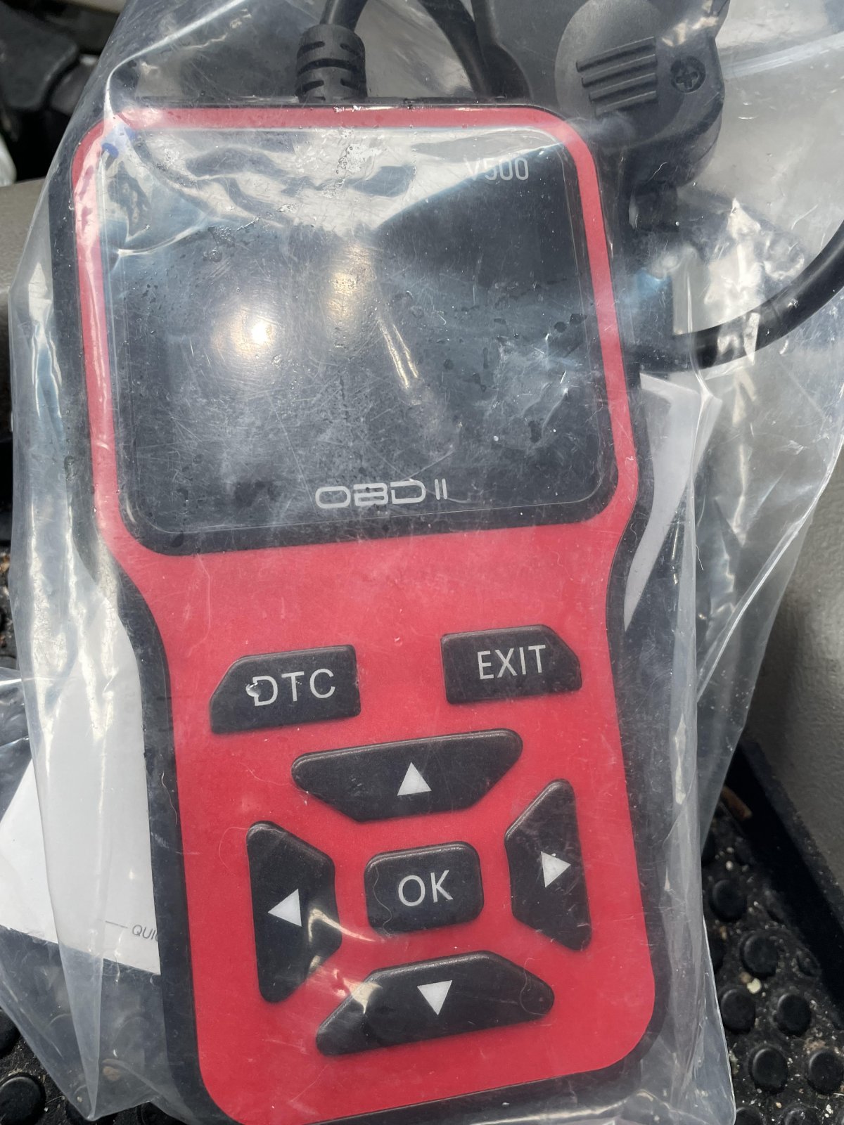

Hi guys,
2006 yukon.
Engine light on. Truck started running rough. Oil was low but its been low before and did not run rough.
I had someone tell me sometimes when oil goes low the engine will run rough though he is a bit of a guesser and I dont know if he is correct all I know is the oil has been low before and did not run rough, so maybe this time is a coincidence and running rough is a different issue.
Oil is back to normal now.
I am disabled so its a bit hard for me to keep track of things thats why it ran low but as i said its back to normal and truck still running rough.
In addition to running rough I have had the traction control sensor issue that been happening long before this.
I purchased a code reader so I could figure out 2 things:
1. What is making it run rough
2. Which sensor is the issue
The code reader just keeps telling me to make sure key is on and that the reader is securely plugged in to the port, it doesnt tell me any codes.
I get a "vehicle fails to respond" message.
The reader does tell me voltage is 14.2 or so so that means the fuses are good and rules out a couple of other things, I think.
My primary question is has anyone had this issue with a code reader and what can i do about it to make some progress here?
code reader pic and link attached

Generally, you want the ignition on, but the engine NOT running. With the "failure to respond" message, it's telling you the computer isn't talking to you.

check the cigarette power port fuse, if that fuse is out there will be no obd communication, the obd port will still have power but no communication.
that is what causes that issue.
also if the oil is getting low it is either burning it or leaking out
if it is burning it then what typically happens is the plugs can get fouled and then the chain reaction is a misfire i.e running rough.
just something to look for, doesn't mean that is the problem but it is one thing to check out in the process.

This makes the most sense, thank you...
For the lighter fuse, i didnt check because i have oneof these plugged in and it tells me the voltage so its working. I will check plugs

Checked all the fuses and we’re good. The code reader wasn’t working so I didn’t know if I had a bad unit or if my port was bad.
I brought truck to AutoZone and they use their reader which worked so that means my port is good, but my reader is bad.
Came back with a code 0300 and to clean the injectors.
I had already run two bottles of gas treatment through it and did not help so I bought spark plugs hoping that is the solution. They need to be replaced anyway.
When we ran it through the reader at AutoZone, that was the only thing that came up. I am having the traction control issues, I was hoping that would come up and it would tell me which one, but I guess that was asking too much.
