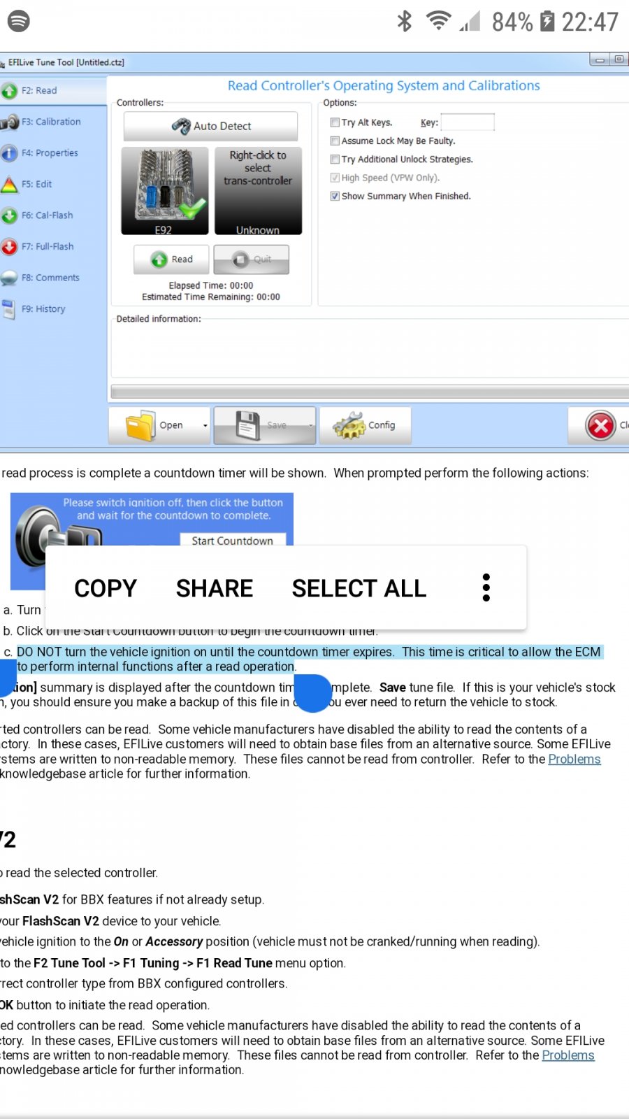

When installing the tune, my instructions say to turn the ignition off, and then the AutoCal will start a countdown timer before I can resume the tuning, or start the truck.
My tune file was flashed, and as soon as it says: Ignition off NOW!, I turned off, and removed the key. But it’s never started a timer, and has been just sitting on the “Ignition off NOW!” Screen for several minutes.
Is this normal? Can I start the truck?
