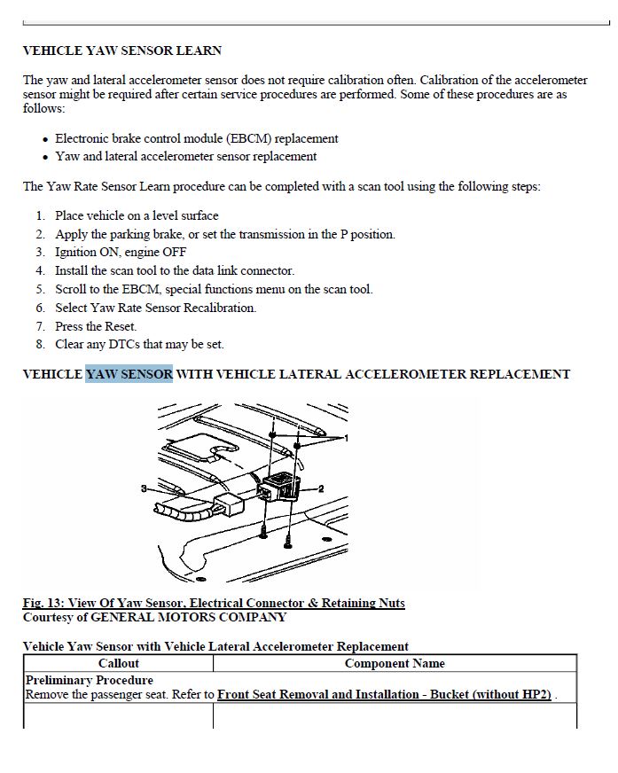

On my 2007, the yaw sensor is bolted to the truck's metal bed under the passenger seat.

it should be either under the passenger seat or center console, but that's if gm left it where it has been in previous years, it's supposed to be there logistically to get correct readings
did you try a relearn already?
this is the procedure for 2010-2014 it should be the same procedure just with gds2 instead
