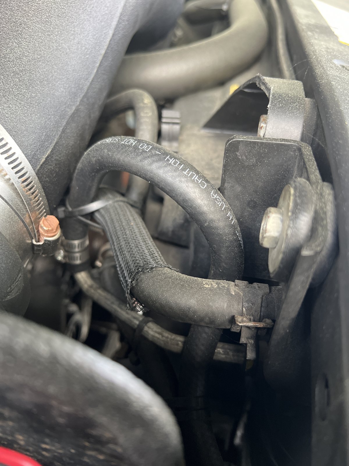

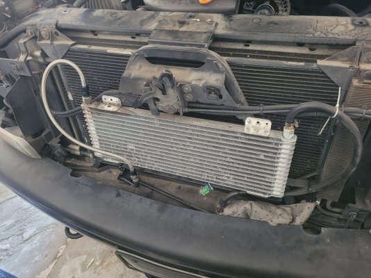

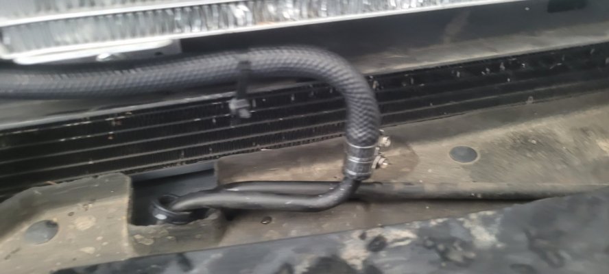

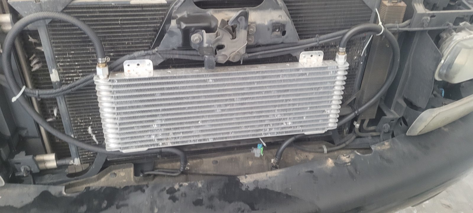

Update: I didn't take pictures when I first finished the install a couple months ago, here they are now. Any input is appreciated

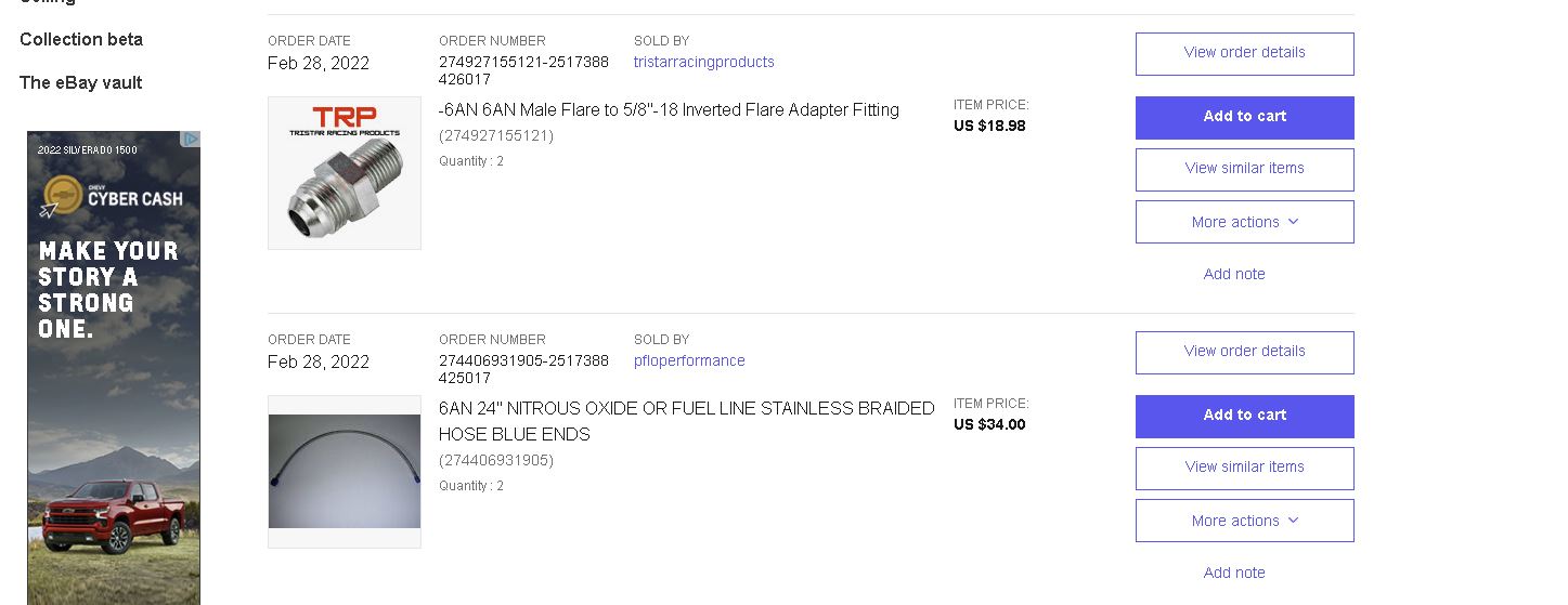

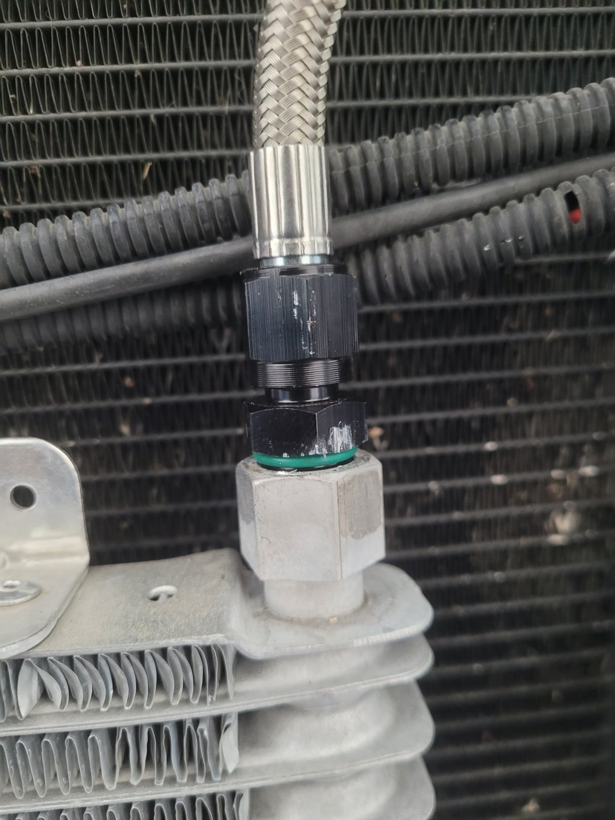

those worm clamps wil leak eventually. getting these would be better for the long term, they make it all plug-n-play tight no leaks.
View attachment 435789View attachment 435790
I didnt cut any of the metal trans lines, as you can see I just put the hoses right onto the existing ones as it seemed the ends were already flared. So plug and play is exactly what I'm going for, so thank you. Gonna order these right now
30,706
48,359
you need 2 of each
