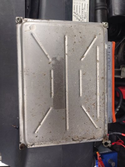

might want to check all fuses and inspect any related sensors/relays i.e.
I think you can rule the pcm it's self out now though since you got the same results with a known good one.

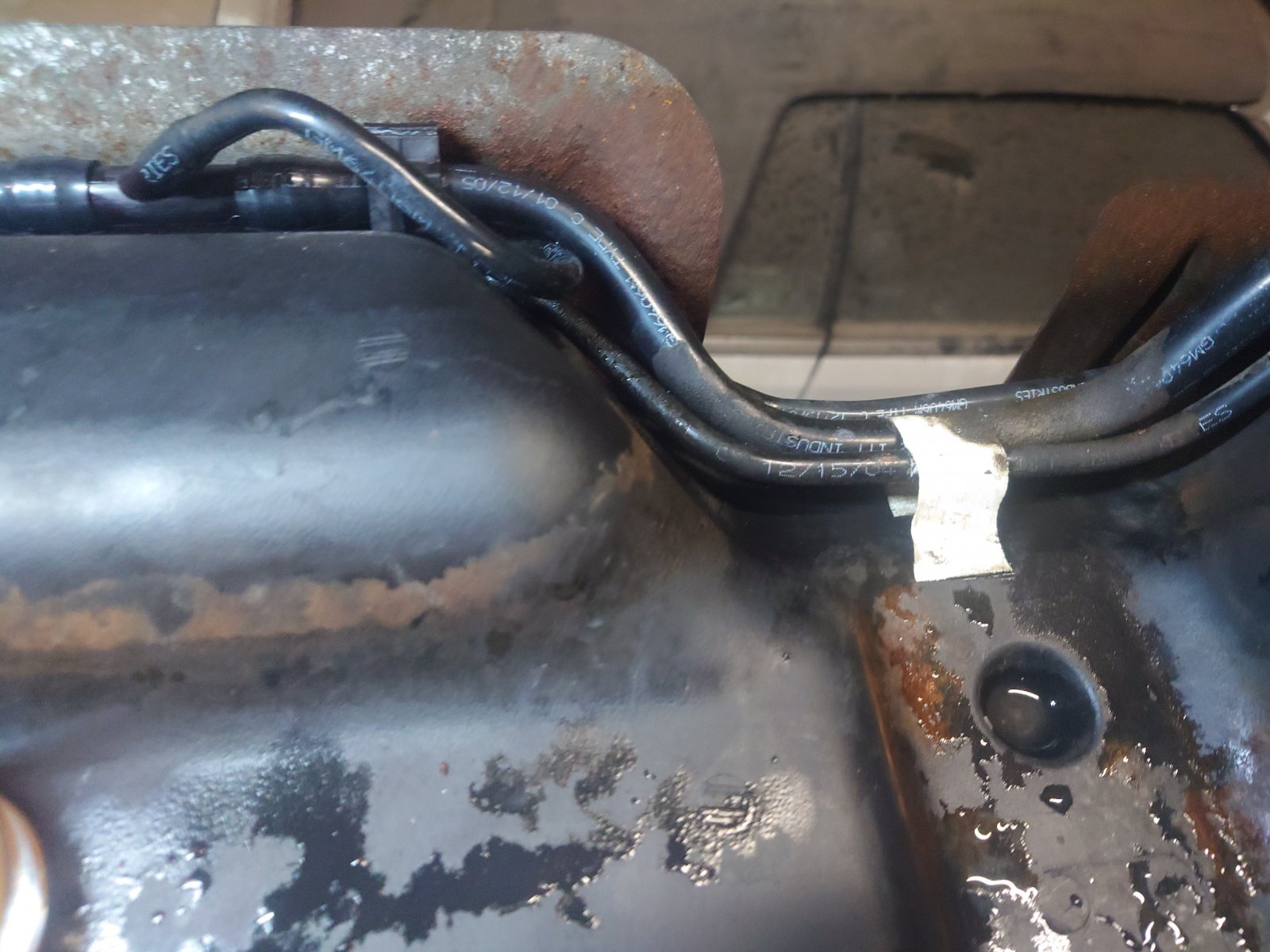

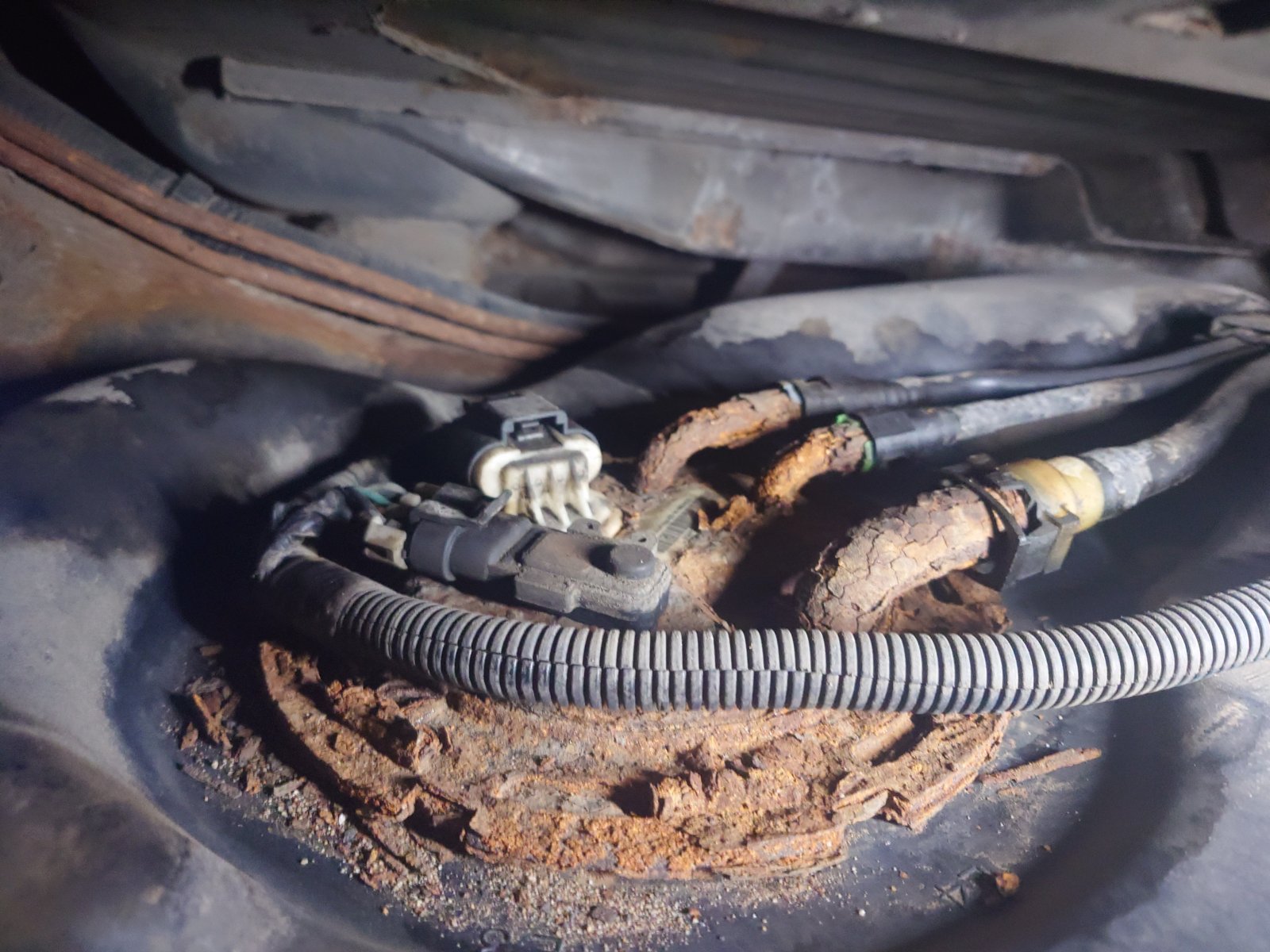

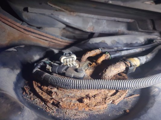

I have removed the tank. Looks crazy. Harness seems to be ok...
Now I try to open the ring from the fuel pump...

ugh that's a lot of rust monster....... man I would put some kind of coating on the new one before you slap it back up under the body

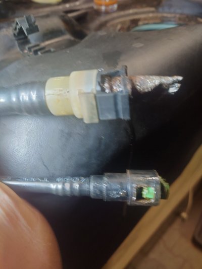

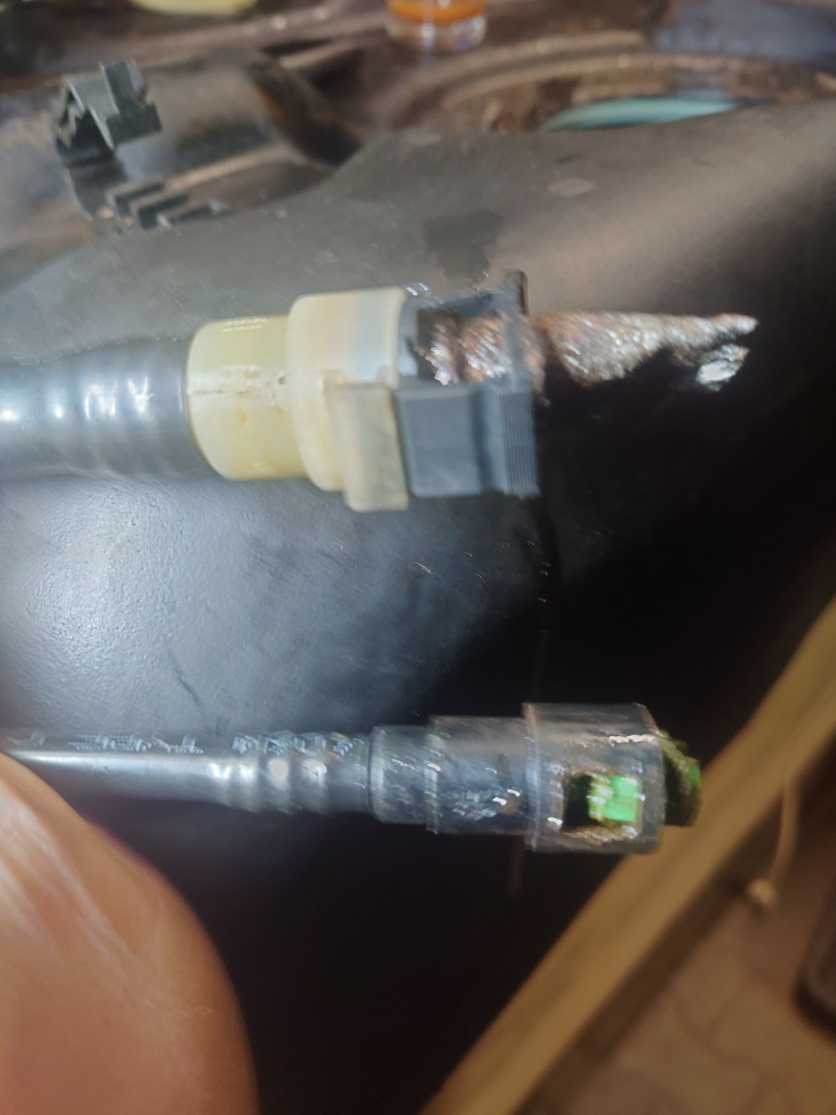

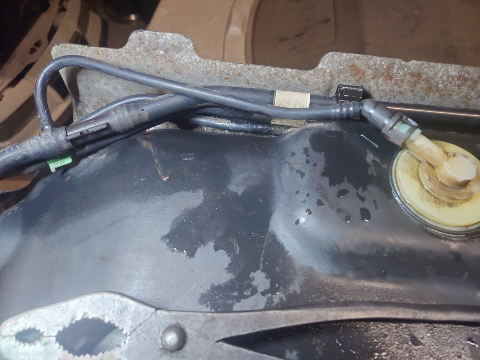

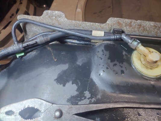

The pump is out, but now I have the problem that two connections can no longer be removed. Does anyone know if these connections are available separately or do I have to buy the hose separately?
i'm guessing that your going to have to try and spray those with something and try to work them out carefully.
similar to what happens with the heater hose-t's that everyone claims can just be pulled off haah, not....after years of being hermetically sealed

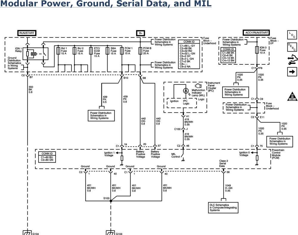

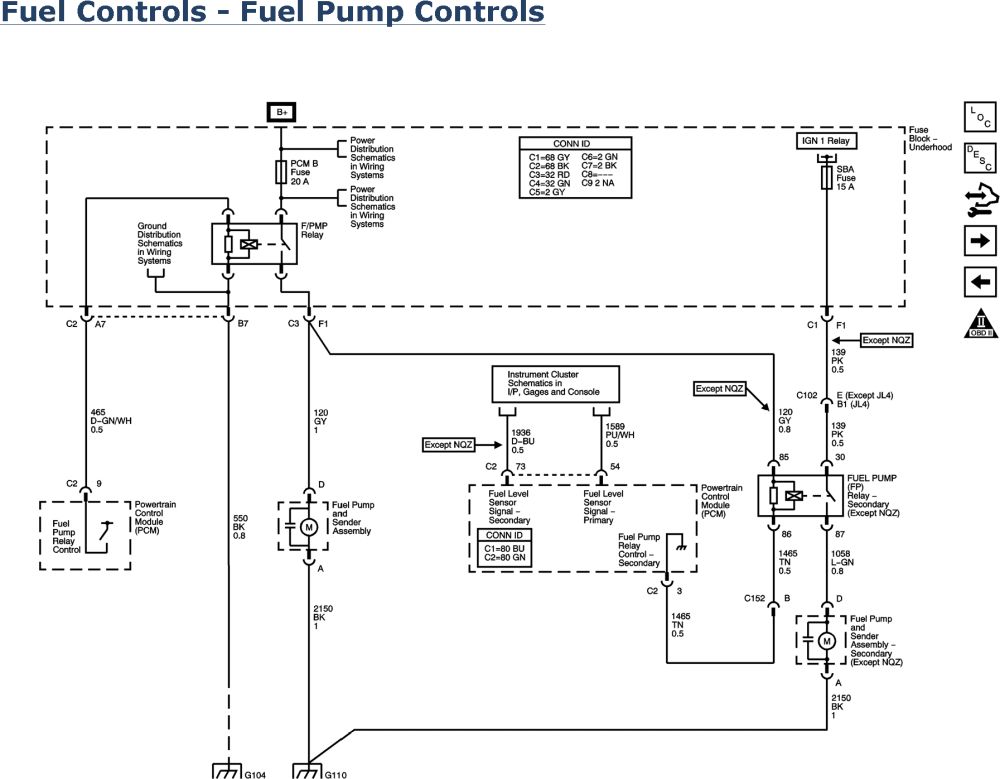

Makes sense now according to attached schematic they are using PCM B fuse also to power the Fuel Pump via the Fuel Pump Relay. Wonder why GM did away with the previous individual Fuel Pump Fuse.

Here in the states its a known problem that "rustproofing" ultimately causes moisture to be trapped between the coating and the metal which ends up looking like your fuel pump module top. Its well hidden under the coating until the rust expands enough to start cracking the coating and chunks start to fall off.

@89Suburban were you the one who used something like the ones that come with 18" of fuel line and a splice?
I think these are the ones:
Connectors only: Dorman 800-080 (5/16") and 800-082 (3/8")
Connectors with pigtail: Dorman 800-058 (3/8" with 18" fuel line) and Dorman 800-057 (5/16" with fuel line)
Thank you very much, that helps a lot. I will check today where I can purchase these in Germany.

That fuse powers through the contact set of the fuel pump relay straight to the fuel pump. It could be the pump is shorted (Its motor windings melted together which lowers resistance and increases current draw)*NOTICE* I did NOT say short to ground for the pump or you have a wiring harness short to ground fault. Go to both contact terminals and measure to ground to check for a short to ground (with pump disconnected).
