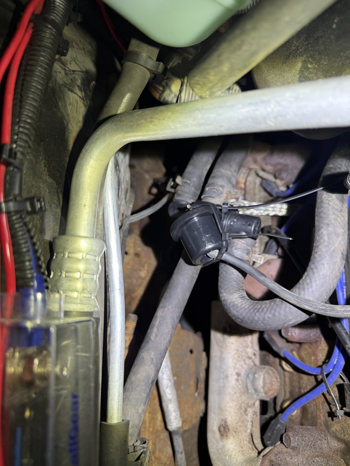

Flushed whole cooling system today, replaced thermostat, thermostat housing, upper and lower hoses, and this “heater valve” with the AC on it seems like it’s not diverting the coolant back into the cooling system and just going into heater core thus making the AC struggle to work cause it’s blowing through the hot heater core. Unsure if it’s related to replacing it, it’s. GPD heater valve right now have it zip tied to so i get AC. Could it be the vacuum motor, or the switch inside the cab

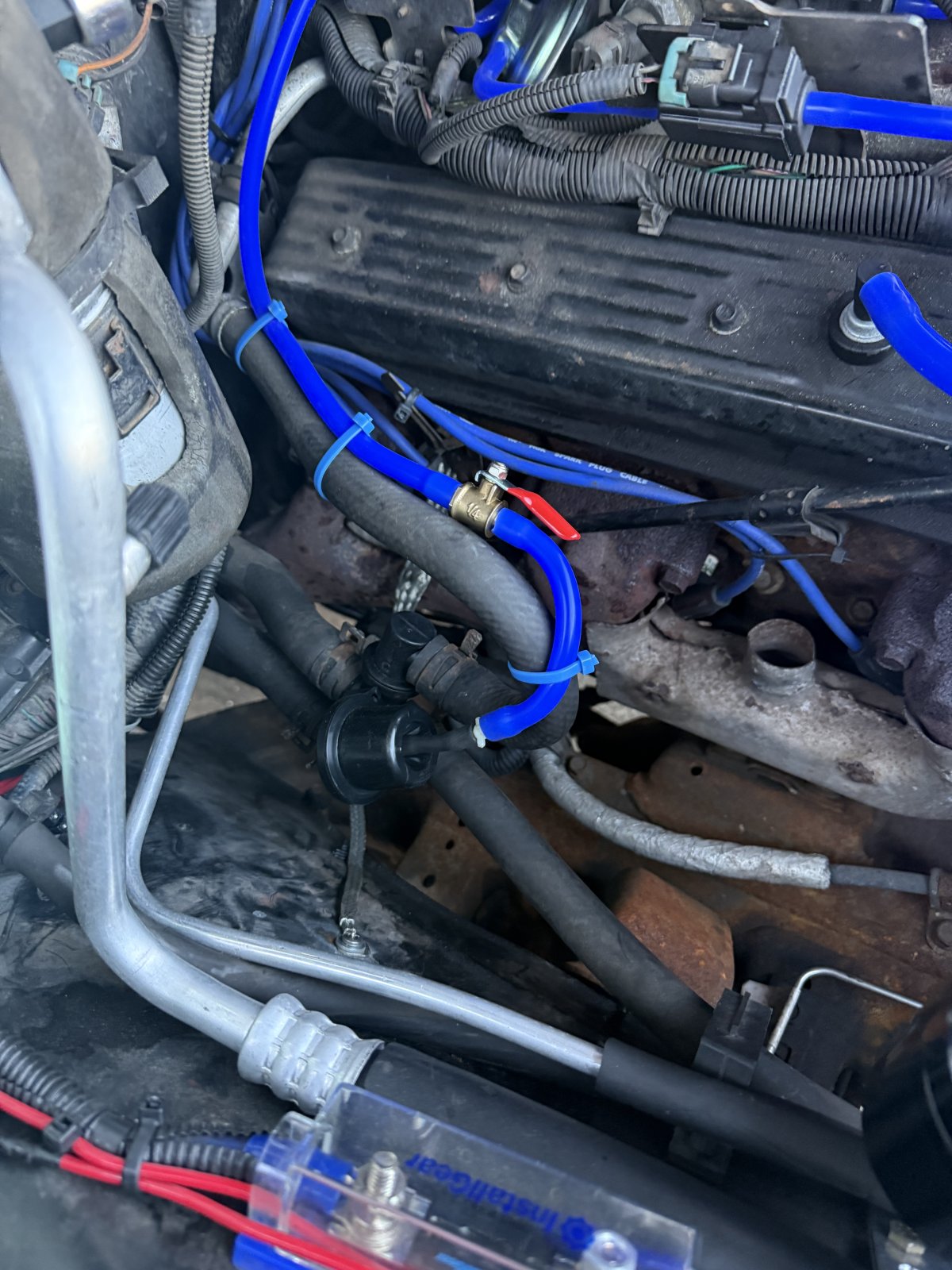

This is what i came up with after testing the power with the ac on full blast and still wasn’t getting it to power. Ran all new vacuum lines to everything, put a 1/4 valve from back of intake manifold directly to heater valve turn it off for winter and on in summer. Simple fix
