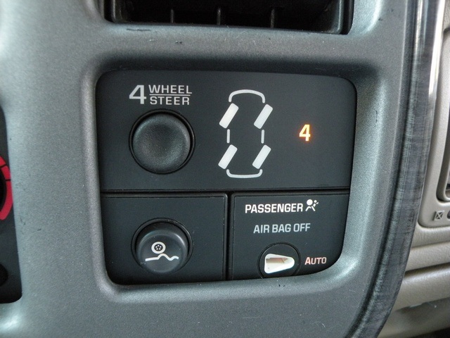

I believe I discovered I the service records why my yukon is shifting strange.
The was a shop and I believe the idiots topped the differentials with lube that has the limited slip in it.
Thanks though. I can at this time only order a bucket 18.9 liters of dextron 3. Though I am going to check and see if they have dextron 6 in a bucket.
See I noticed. My yukon denali is slightly different from the average yukon. It has 4 wheel steering.
Owners manual says use limited slip additive in the diff for a Yukon. But with 4 wheel steering you don't use limited slip additive.

what the hell! you have 4WS?? that's badass. people love those trucks. I would be bragging about that.

I know. Odd. I didnt expect it. It was an option. Until i saw a fuse for it didnt know it had 4ws.

You probably don't have Quadrasteer then. It's VERY conspicuous.
I know I wouldn't mistake this ^ for traction control, even if I was from Mars or otherwise.

Well I could be mistaken but then why would a fuse have leads and it states 4 wheel steering? Plus it comes up when running the Vin code?
I would think that vehicle isn't the same year as mine. I have also seen vehicles without a switch that have 4 wheel steering.
Besides the older ones don't turn the wheels a heck of a lot anyways. Well in any case I am just dealing with the problems the vehicle has.
All my information does suggest it has this feature, although if it doesn't no big deal.

I will also mention my owners manual does NOT refer to it as Quadra steer. As well in the Vin code lookup it states 4 wheel steering. I think this one was before they made a better system perhaps and gave it the Quadra steer name. Oh well can't wait to change the fluids.

If memory serves, only the Suburban and Yukon XL had Quadratrac, not the short ones.
Just saw your new post above, the digital owner's manual does now call it Quadrasteer, go figure. Page 4-16.

Ok smart ass I get the point. Now let us talk realistically. One I understand what traction control is and 4 wheel steering. 2 there have been vehicles with 4 wheel steering that believe it or not, we're deployed WITHOUT a large button to turn it off. Also I can read. Now that I have decided you are not part of this conversation. Let the rest of us alone kindly as we have adult conversation, intelligent things to say.
