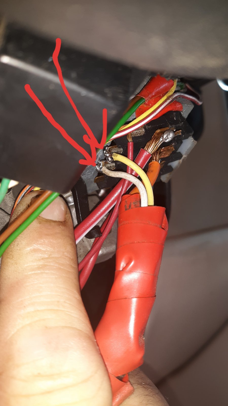

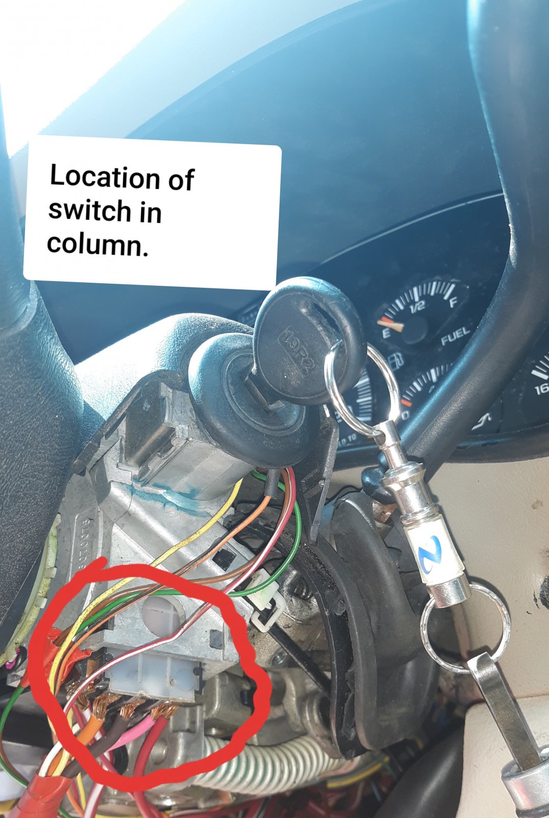

The pic with red arrows are pointing to the white wire that had completely became unattached from solder point and yellow wire that if I breathed in it hard would also be unattached on ignition switch. The other pic is just the switch circled to show you where you need to look for the switch. I also removed the ignition switch from column to be able to solder ok and not damage anything else.
