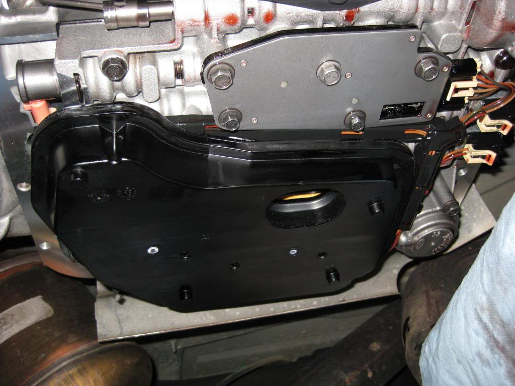

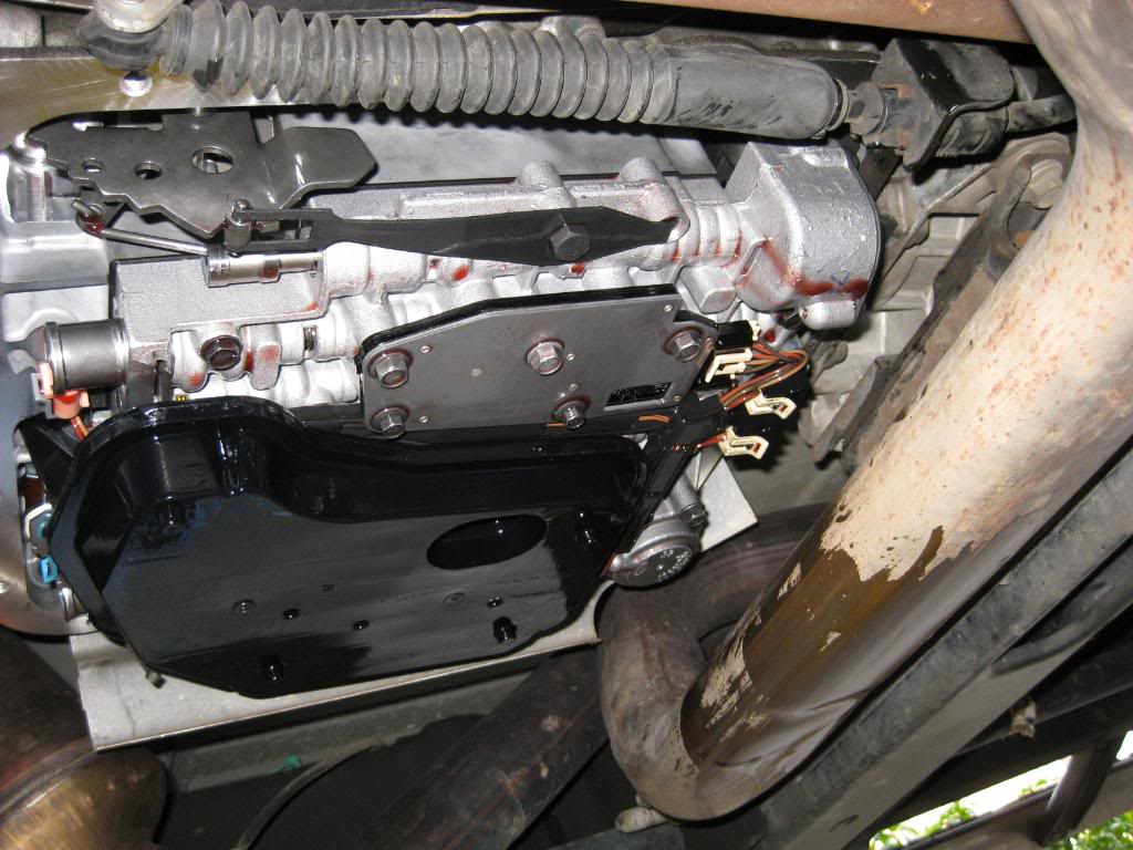

Remove the pan bolts and snake the pan out. You'll see this. Obviously, be sure you've got a catch pan for any residual fluid.

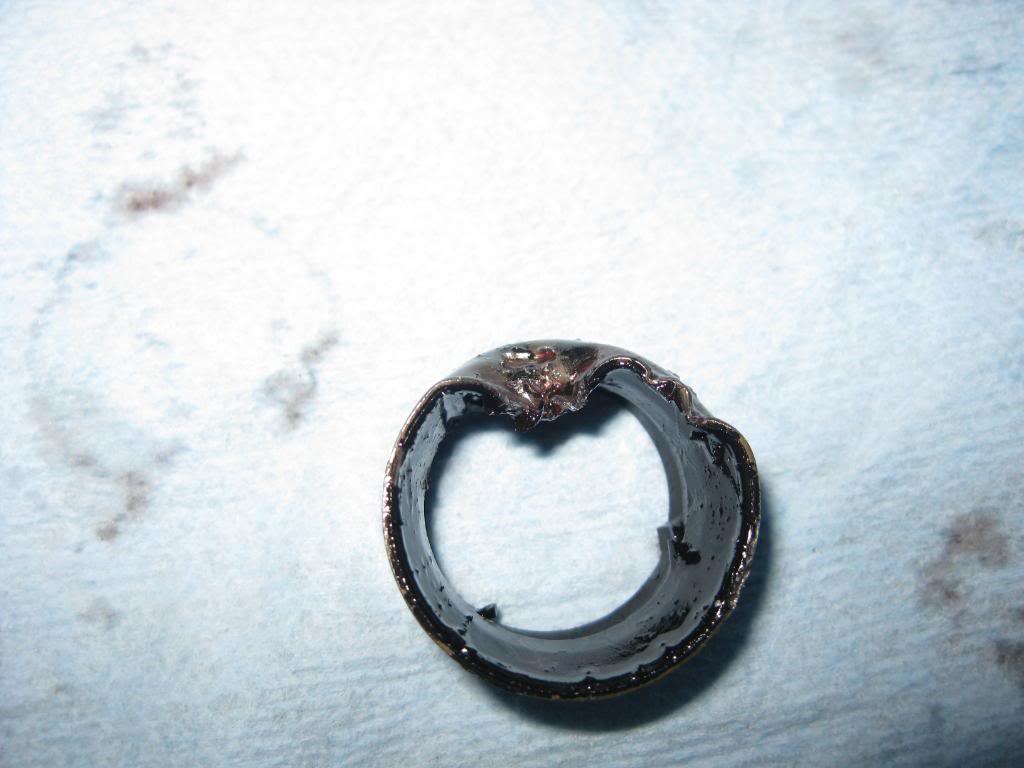

Now it's time to change the filter and filter seal. Pull straight down on the filter. You may have to twist it a little. Be careful because there will be some fluid in there. Once removed, look at the hole that the tube on the filter came from. You'll see the seal that matches the one in the kit. It's a huge PITA to get out. Some just inspect it and leave it alone if it looks good. I chose to replace it. Most folks use a hook tool to get it out. Mine didn't feel like cooperating. So I used a small flathead screwdriver and a light touch with a mallet. Once I got the edge away from the wall, I used needle nose pliers to get it out. Denaliano said anyone could borrow his reverse pliers to get this thing out (nice to know that now). He'll even pay for shipping.:crazy: In all seriousness though, be VERY careful not to damage the metal wall. It needs to seal tightly around the filter.
Here's what the filter seal looked like once I got it out.:eek:
To place the new seal, coat it in trans fluid and use a socket of the same diameter on an extension (to give you something to hold onto) and tap it into place. The bottom of the seal should be flush with the bottom of the hole. Now, just seat the filter and be sure you've got it oriented correctly. It should look like this.

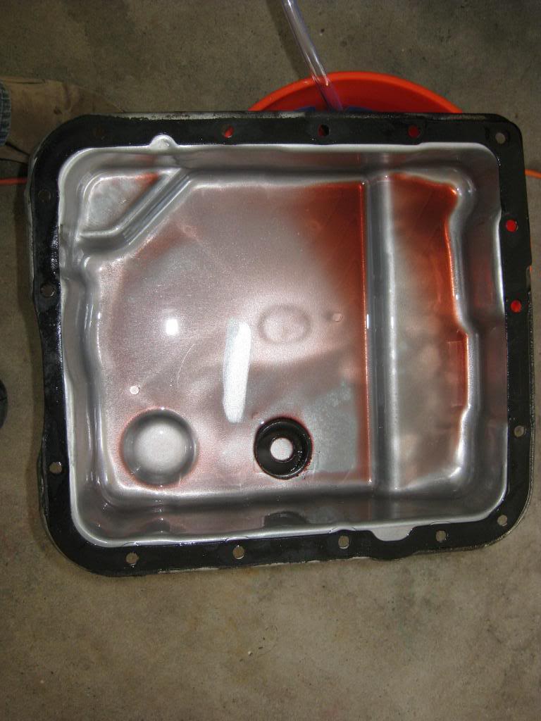

Let's turn our attention to the pan. Here's a shot of mine after removal.
Remove the old gasket and clean the pan and magnet. Use a couple of bolts to orient the new gasket and secure the pan back to the trans. Replace the remaining bolts and get them finger tight. Torque them to 97 in-lbs. Next, replace the rear Torx screw on the shift linkage bracket and tighten the front one.
Just clean up any spilled ATF (especially from the exhaust) and that's it for the pan/filter.

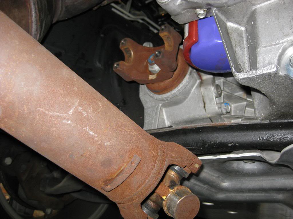

The shift linkage is located on the driver's side of the trans. The two Torx screws are on the top looking at it from the ground towards the rear of the trans. Those of us with a 4WD or AWD will need to remove the front D-shaft from the front axle to gain better access. It will rest on theexhaustY-pipe. Some have done it without removing it, but I couldn't tell you how.

the shift linkage partially obstructs pan removal. you can just push it out of the way but that person chose to loosen the mounting screws for the linkage.

I had to unbolt the front driveshaft, remove the shift linkage (PAIN), and unbolt the rear of the y-pipe to get the pan out. The y-pipe was the worst because a bolt broke and I had to spend time after the flush drilling it out and replacing it with new stainless hardware.
The only other pain I ran into was getting the filter seal out. I had one pick, a 90 degree, and if I'd had a set of them I'm sure that I could've gotten the seal out easier. Instead, I had to end up bending the seal with a screw driver and pulling it out with pliers.

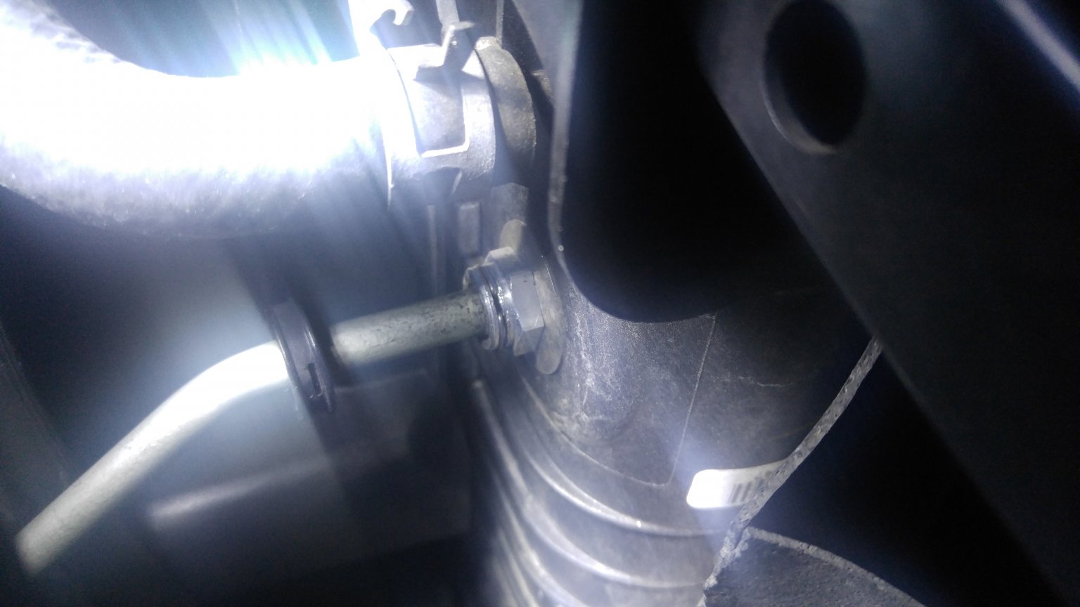

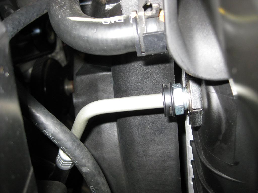

Ugh problems from the beginning. My trans line doesn't have that 5/8 to unscrew....
Meccanoble
Oct 3, 2016
1,166
355
Georgia
There seems to be a difference. From the right to left it goes big then small. On the instructions picture, out goes big small bigger. The bigger it's missing on mine.
52,954
Yours looks a bit different, but still has the same quick disconnect. What happens when you try to unscrew it- does it feel like it's moving or does it feel like it's going to break? It doesn't look like a soldered fitting, looks like it's made for a wrench. I dont know for sure though. Maybe someone else with a 2011 will know.

According to previous posts, removing the big head closest to radiator Will cause coolant to come out. I'm wondering it'd removing e clip Will allow me to just pull line out then i can poor my clear hose in same place. I'm at 125k miles and prepared to wait another weekend before i fubar my car.
Meccanoble
Oct 3, 2016
1,166
355
Georgia
According to link below, simply remove clip and line should pull out. Also helps show how to properly remove and install clip. Lets see how this goes.
52,954
You won't be able to install a plastic line in place of the stock line by removing the e-clip without an adapter . I replaced my trans line a couple weeks ago so I do know that much. That's why the instructions for installing the plastic hose say to not remove the e-clip but instead remove the threaded fitting. The stock line has a flared fitting that the e-clip utilizes to hold the hose in with. It's designed with a flat side to the outside and a tapered side to the inside. But I did find an adapter on Amazon that will go in place of the flared metal line and allow you to attach a hose. You have to use a pick to remove the e-clip, and when you reinstall one of these fittings you install the e-clip into the fitting first and then just push in the metal line until it clicks. That's the reason for the tapered side on the inside and the flat side to the outside like you see in the picture.
