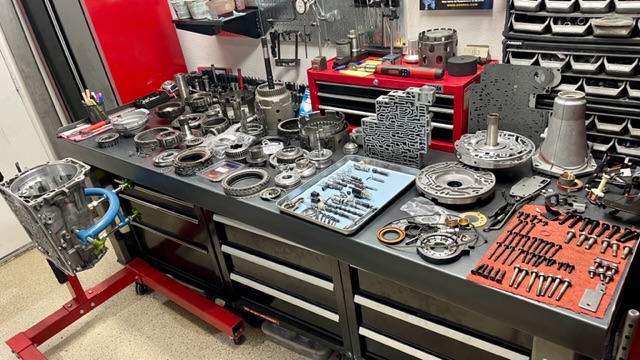

Here's one example build (next week's project). The video(s) should be on my channel by end of next weekend) IMG_7425.jpeg
60 vs 80: The 80 will require a segment swap, rear cross member relocation, driveline cut and re-balance (and maybe other things). They also consume about 15% or so more horsepower compared to a 60 and weight more.
That said, the 80s can be bullet proof with minimal mods up to 600 horse (especially 1997-2000 units). Beyond 750, you'll want a super drum, billet input shaft, case saver, etc...

The unit I'm putting together this coming week (in that pic above) will have a better, stronger Sonnax input drum, better 3-4 clutch pack, billet steel rotor and stronger output shaft than the '75E but otherwise will be very similar.
Just subbed to your channel. (I used to love watching the AT teardowns on the Precision Transmission channel before they got a billion subs then went private $$$).
