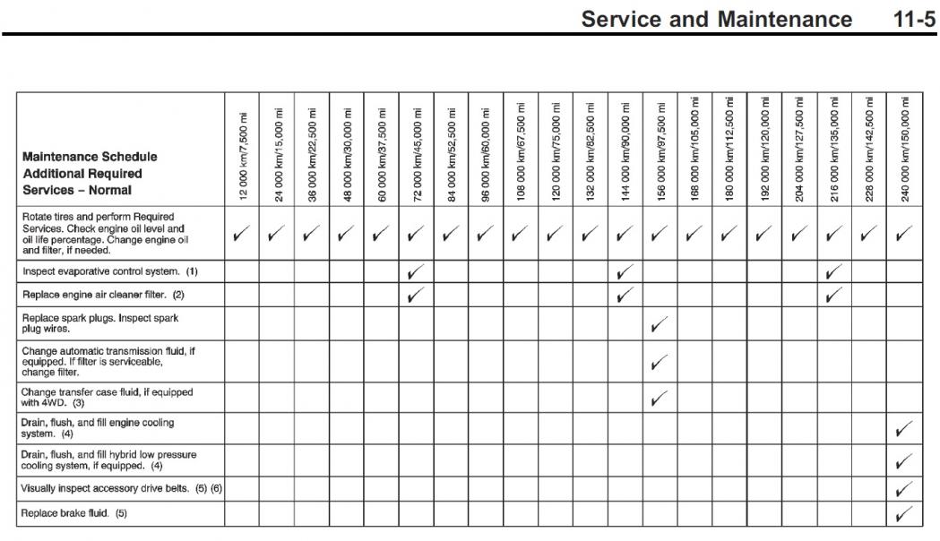

What is the trans service interval for a 2010 Tahoe? 45K? Also, does anyone have a maintenance schedule they can share? I know there's one in the manual but that one seems too simple?

I believe it is a 50K mileage interval. Coolant every 150K. 50K for the transfer case and 20K for the front and rear differentials. At least that is what I would do.

100k.

I do a trans service every 2 years but I tow a trailer. $250 for a trans service is cheap insurance compared to the cost of replacing a trans.
I did front and rear axles at 50K
And don't forget flushing your brake fluid. Most manufacturers suggest every 3 years but only us racers tend to do our cars, most people don't ever do it.
