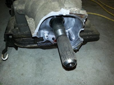

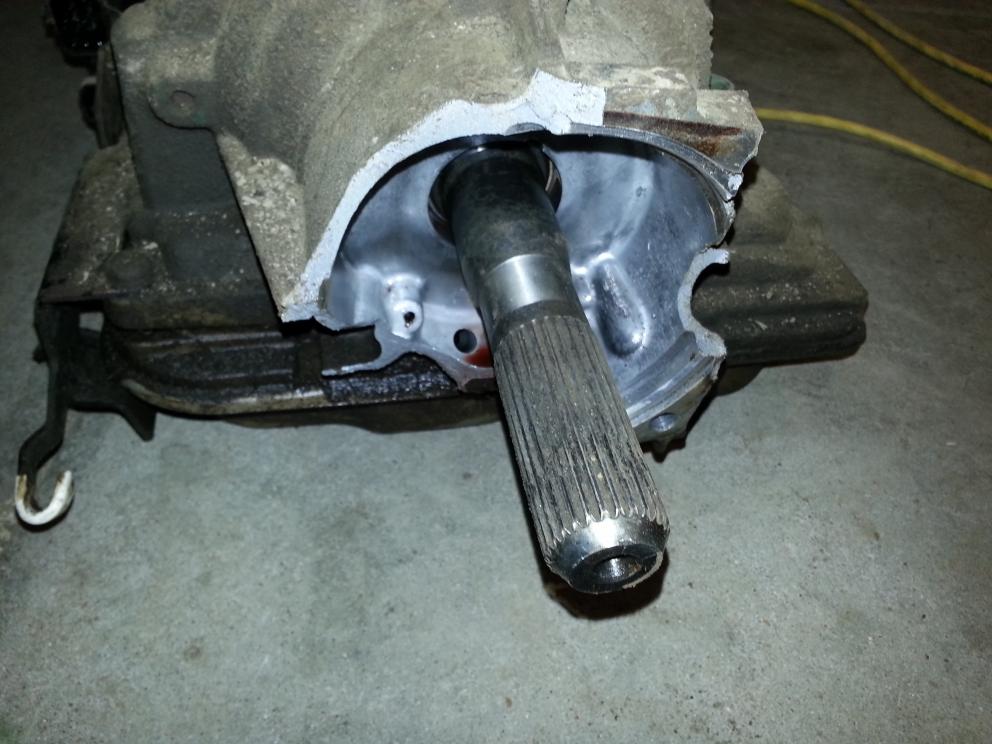

This is what mine looked like after my drive shaft dropped doing about 90

Ouch.... Well I'm okay with a 95 right now. Need wheels. Was riding the bike since the snows melting. Then it got cold so I grabbed and put plates on my dads 73 Sprint.
