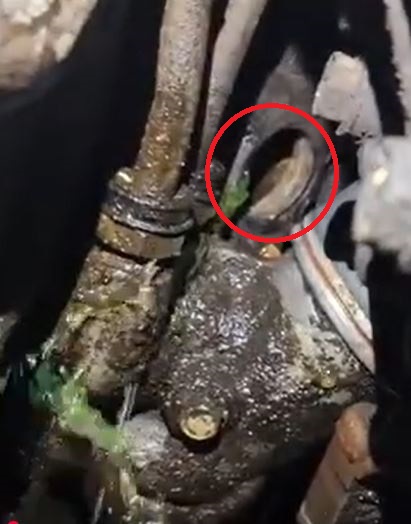

I usually work on Japanese cars, so I'm hoping someone can help me out here. I inspected a 1998 Tahoe with the 5.7L Vortec engine. On this engine, there's a hole above the oil filter. I'm gonna be honest, I have very little idea what this hole is for, but what I DO know is that there's an enormous amount of coolant leaking from it.
Whenever coolant is poured into the radiator, it takes a moment to settle, and then pours out of this hole. Never in my life have I seen anything like this.

I can't tell if it's really originating from where I circled it below, but that's a freeze plug on the engine block. It's there to pop out or leak if the coolant freezes.

That's prolly it, I'm guessing the freeze plug rotted out. Don't I feel stupid for not thinking of that first lol

From the video it looks like the freeze plug, core plug or whatever kind of plug you want to call it is leaking. That one isn't too bad to get to, knock it out, clean the hole really good with a wire brush on a drill. Coat the new plug with Permatex from a tube and knock it in. Might have others close to rotting out so it's your call how deep you want to go. If you go scratching around on others you might poke through them.
If you really want to dive deeper that oil filter adapter is usually the cause of an oil leak and if removed will make it easier to get to the plug. Of course that will lead to whether the lines them selves are leaking as they usually do so you could replace them. The you'll find the joys of aluminum radiators with plastic tanks that crack easily. Once you're done and the system is filled if you pressure test it you'll find the other major source of a coolant leak at the intake gaskets corners. Start on that and you'll find the distributor housings that are plastic and the ears crack off where the cap mounts and the gears wear out causing performance problems.

It was the freeze plug, btw everybody. I fixed it and now it's fine. It was a total pain in the ass to get a hammer in there.
